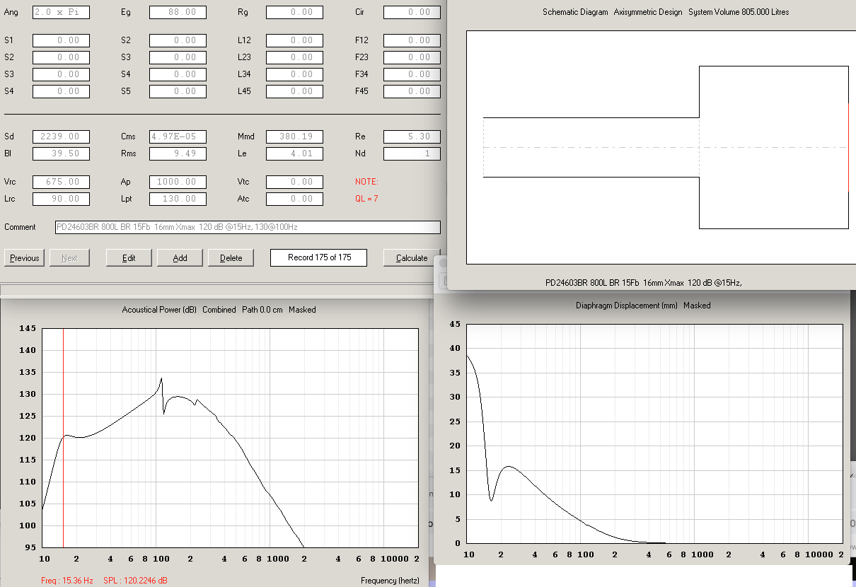

You have plenty of power and displacement to go both low and loud.
14 years ago 15Hz seemed to be your goal, is an Fb an octave above that more in line with your current thoughts?

Fb is the box tuning frequency, response drops off at around 24dB per octave below as the port output becomes out of phase with the driver, providing no loading and uncontrolled excursion.
If you want to "hit hard" at 15Hz with a bass reflex, the Fb will also have to be near 15Hz.
Edit: This sim's Fb is actually 16.5 Hz.

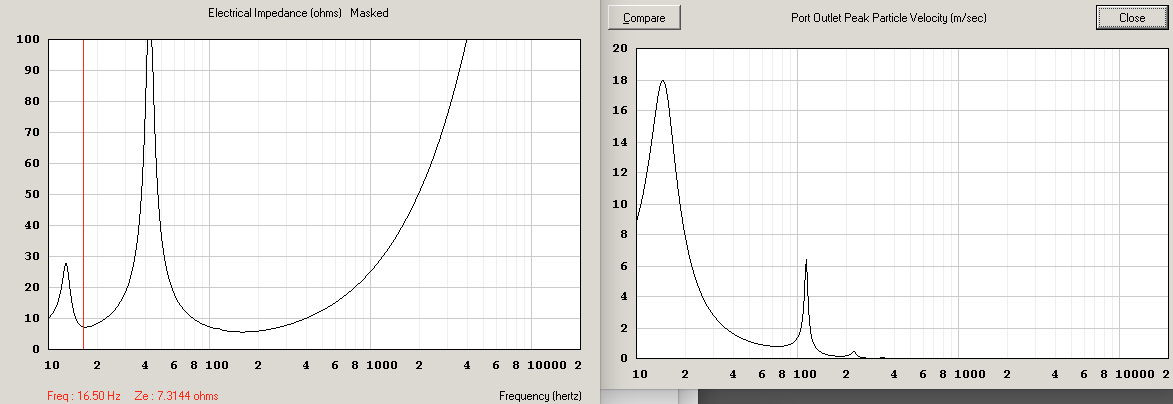

Looks like an 805 Liter (close enough to your large washing machine) cabinet using the PD 2460BR can do 120dB at 15Hz in half space, 130dB at 100Hz and still be within Xmax using 88volts, about 1060 watts into the impedance minima of 7.3 ohms. Between 30-60 Hz, the driver would only draw a fraction of that power, it should hardly get warm.
Port velocity is 18 meters per second using a 1000 square cm (150 square inch) 1.3meter (51inch) long port. The port would need to be folded or run at a diagonal to fit into your cabinet dimensions, so the exact length may be different to achieve a 16.5Hz Fb.
The smoothly rising response might look a lot different in room, and the port tube resonance at 112 Hz may not be as pronounced as the sim shows.
