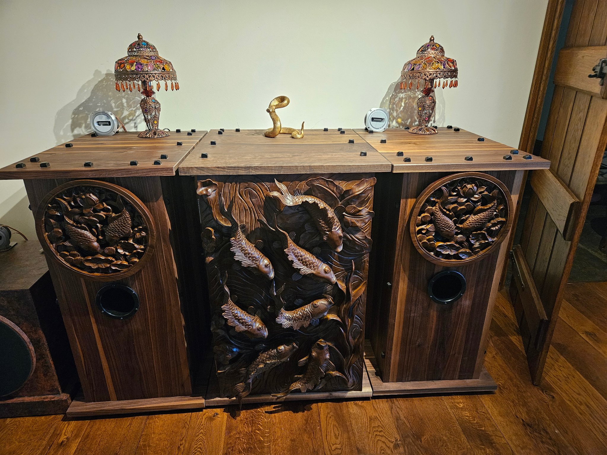

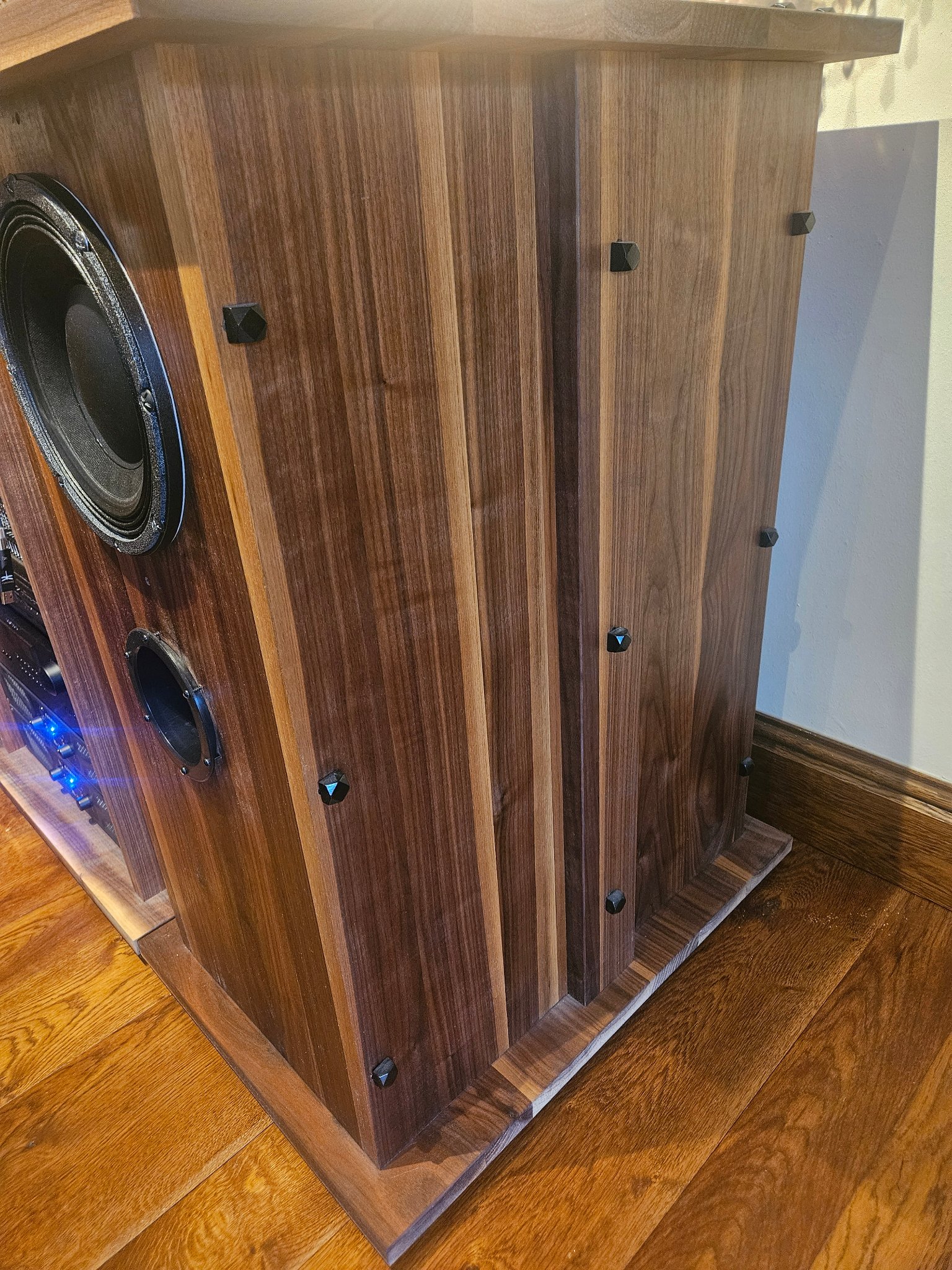

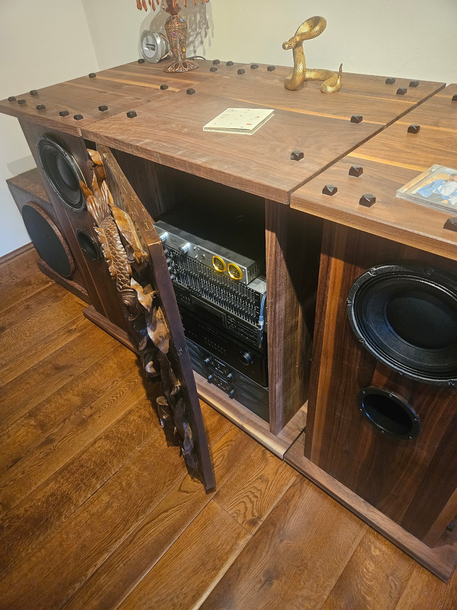

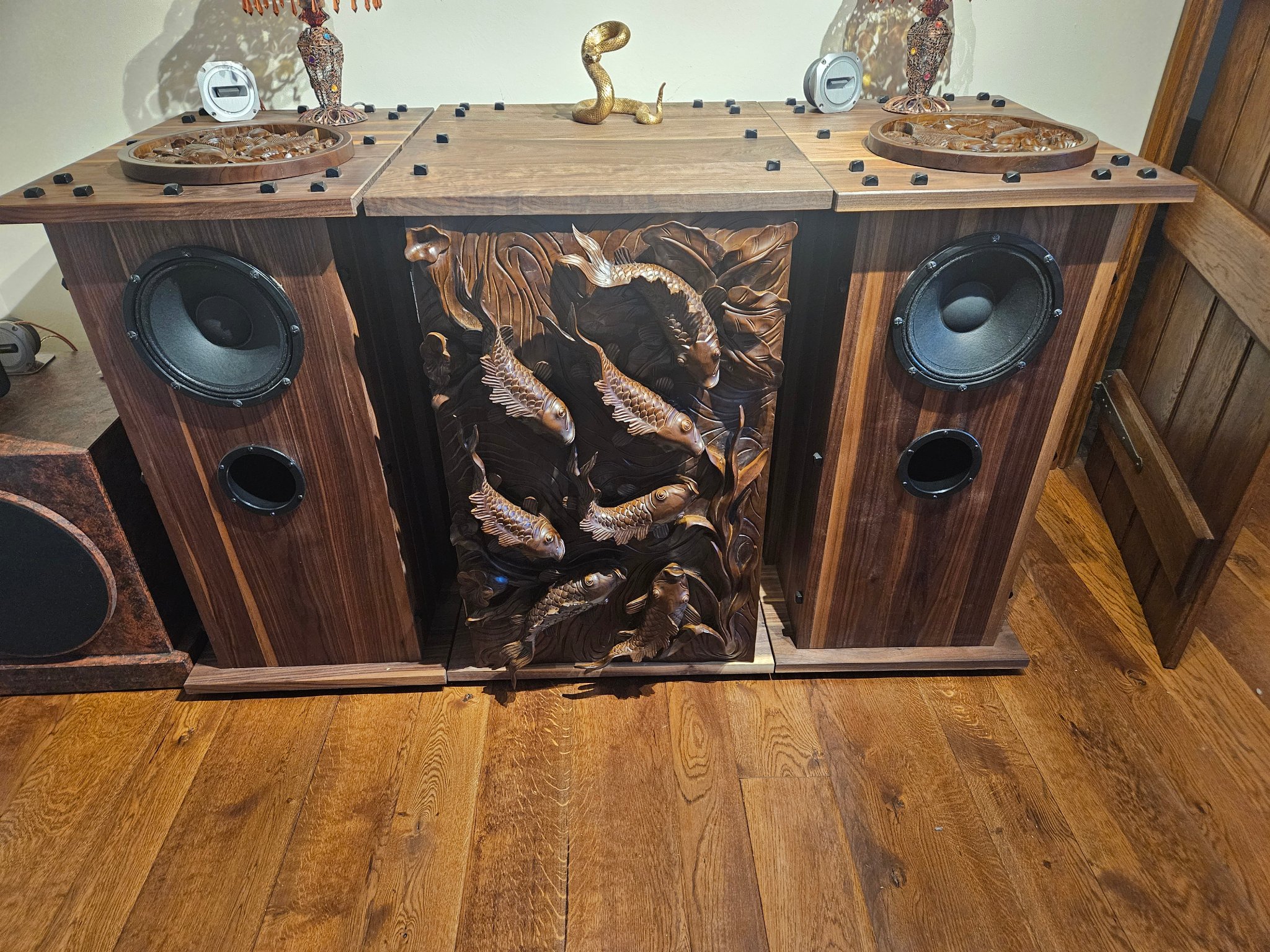

Been distracted with this 10 inch tower and hifi cabinet build. Yet to house the Beyma tweeters you see on top. Construction is 32mm thick black american walnut with medieval stud bolts. Hifi door in the middle is hand carved from a solid 90 x 56 x 14 block of teakwood. Grilles are teakwood also (removed for listening) 550 lbs total weight.
I will sort the 24 precision devices out soon i promise.

Drivers used
Beyma cp21 F
Eighteen sound 10MB600 or Eminence KappaLite 3010LF
when i have the eighteen sound in i xover at 4.6k, for the kappalite, 3.9k
It's a dirty n loud system for hard dance and D&B
Cabinet vol is close to 6cuft, so rather large for most 10 inchers. Both these drivers have good strong motors though, never hit the coil on the back plate.
Cabinets braced externally...

Loving the Medieval Keep look. Just the style for playing Gregorian chant techno... 😉
Yeh
My new house was built in 1537.
Oak beams, panelling, floors everywhere, in order for the missus to accept huge cabinets it's got to be in keeping with the house. The PD 24 will be getting the medieval treatment too.
