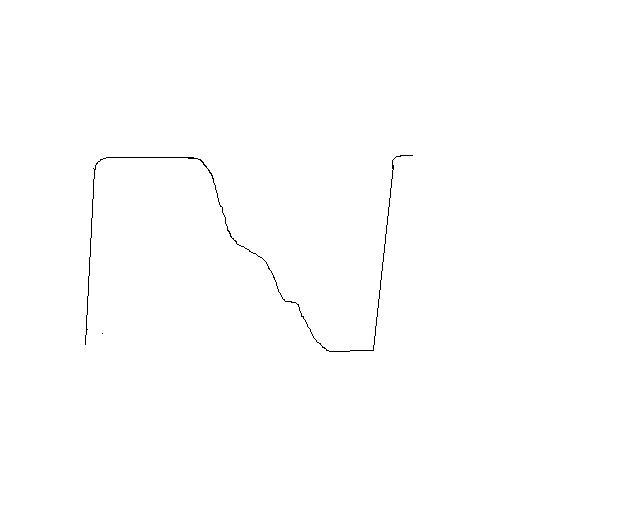

I made some measurements of the aquare wave response.
I have the + connected to the signal generator and the - connected to ground. No caps in the input. 10pf and 220k as feedback resistor. scope measures in diffenrential mode (adding both channels with one inverted) across the 6 ohm resistor at the output.
It looks pretty ugly though at the moment (see picture). Any ideas how to improve that ?
OK, re-checked the whole equipment and found a problem of one output of the function generator - it gave 59V p-p into the Aleph-X...interesting that the Aleph-X was able to cope with that without going to hell...
...used now a different output with 3V p-p and now it looks not bad. Until which Voltage / Frequence did you get a perfect square-wave ?
