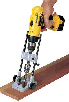

Yes, those sanding drums can be useful for "pushing the bumps around" on a cut edge.Thanks, but how do you use those? In the drill press? Boy, you're making me feel like a real newb...
Can be used in a handheld power drill to sand edges, etc?
One challenge is maintaining alignment of the drill's shaft axis - parallel to the cut edge and perpendicular to the flat surface adjacent to the edge. Two solutions are:
- Skill created through long practice and multiple ruined workpieces
- Three or more eyes carefully calibrated to gauge perpendicularity
The smaller sanding drums - up to about 1" or 1-1/2" diameter - can be used in a hand-held drill. Like those circle-cutters with a single-point cutter mounted on a beam, the larger sanding drums present safety and control problems. I think the mechanical engineers describe it with terms like "rotational inertia", "radius of gyration", etc, but us mere mortals may better identify with "flywheel effect" and "gyroscope precession". The problem's foundation has to do with a fair amount of mass, rotating at a significant distance from the center of rotation. Even at low drill RPM's the outer edge of the tool is moving at a high linear speed, and has quite a bit of energy. Accurately controlling it with a one-hand drill grip can be difficult.
