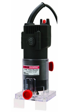

By request, here's the trim router I have:
1/4" Trim Router Drill Master - Item#44914
I guess it's woefully inadequate.
I wasn't planning on building lots of cabinets. I was just going to cut the holes in the baffles for this project, and maybe for a pair of those curved-back cabs you can get from Parts Express, if I like the results of this experiment.
It might be that I need to re-think all of that.
looks essentially like a rebranded Makita laminate trim "router" - as noted above, a decent enough tool for that purpose - but your assessment of its shortcomings, or better said, its anticipated lifespan for any function beyond that, is validThis discussion really is a good one. It may not be what I wanted to hear, but I feel like I'm seeing a lot of great advice.

You said that you had a jigsaw but the cut went badly. How so?
Taken in sum, to do the job of the cutout that jigsaw is the superior cutting tool and for handwork it is safer than using the trim router. Spin drills work, that's why there is a market for the Zip Tool found in many tool outlets. But they are used for things like free handing cutouts in drywall for electric outlets and such jobs where the cut will go in multiple directions in a pattern.
Look at it this way: the trim router is designed to cut through an 1/8th or 1/16 inch of plastic laminate. It can be used other ways and that's why I got the kit as an experiment.

So chrisb, you meant to say that this trim router would get burned out by cutting more than a few speaker mounting holes in 1/2" MDF?
loninappleton, Years ago, I did quite a few cuts with a jigsaw. I used a nail and a string to draw the circle to be cut out, drill a pilot hole and drop in the jigsaw blade. Follow the line. It worked, but there were lots of meandering imperfections. Very difficult to stay right on that line without wandering off here and there. But like you said, it gets covered by the speaker frame.
I could then use the trim router with a roundover bit along the back of the cut, to give the driver "breathing room" (as per Mark Audio recommendations).
The problem is with a small circular hole. I felt like I was trying to bend the jigsaw blade into the line. It did not feel safe.
The hole I'd need to make for Alpair 7 would be 4-1/16" (103mm). Do you think with that Starrett blade you linked to that it would be possible to make a small hole like that with a jigsaw?
Thanks again.
PS - My jigsaw is a Black & Decker "Basic Jig Saw" (single speed) that I've had for something like 20 years.
There are likely better solutions than a piece of string. A sub-base would be more stable.
For those small holes, you are right: the radius is limited.
Hole saws come in sets at the Harbor in various sizes or you could get one
of the precise size. There are those of us who have used hole saws in a hand drill to make the cutout. I no longer would say anyone should do this without a drill press. In order to get things done, I have done such foolish things in the past. It will give you wrist pain at minimum. Hobbyists try all differnt things depending on the amount of tools or lack of tools they have.
So if the jigsaw cannot accommodate the radius a hole saw properly mounted should be considered.
Returning to the laminate router, someone on here might know where to get an 1/8 in to 1/4 collett to use a spin saw. Mine came with both.
These small speakers invariably run into such problems of what tool to make the cutout.
Just for discussion purposes, the link below shows the cover shot of a jig made by Bill Hylton for his Router Magic book.
It has a sliding piece which allows the attached device to make a hole something 2 1/2 inches circumferance to 7 in radius. I made one but it took a lot of time and acquired tools. It's still one of the best designs I've seen.
