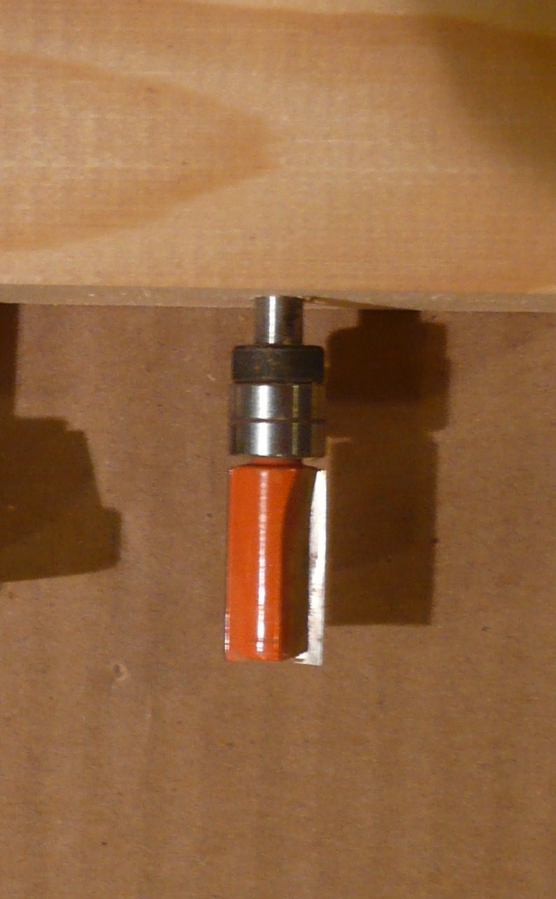

Also, no one mentioned using a flush bit with a 1/4" plywood template (yes you would still have to cut a perfect hole).
This is also a good way to make a hole bigger in an existing box.
Steps:
drill hole in 1/4" plywood; coordinate location so there are places to clamp.
place template over board/box clamp down
if there is no existing hole - this is a good time to use jig saw - stay well within the circle
start making passes and flush cut perfect hole

btw, This little trim bit was 2 for $5 at woodworking show
