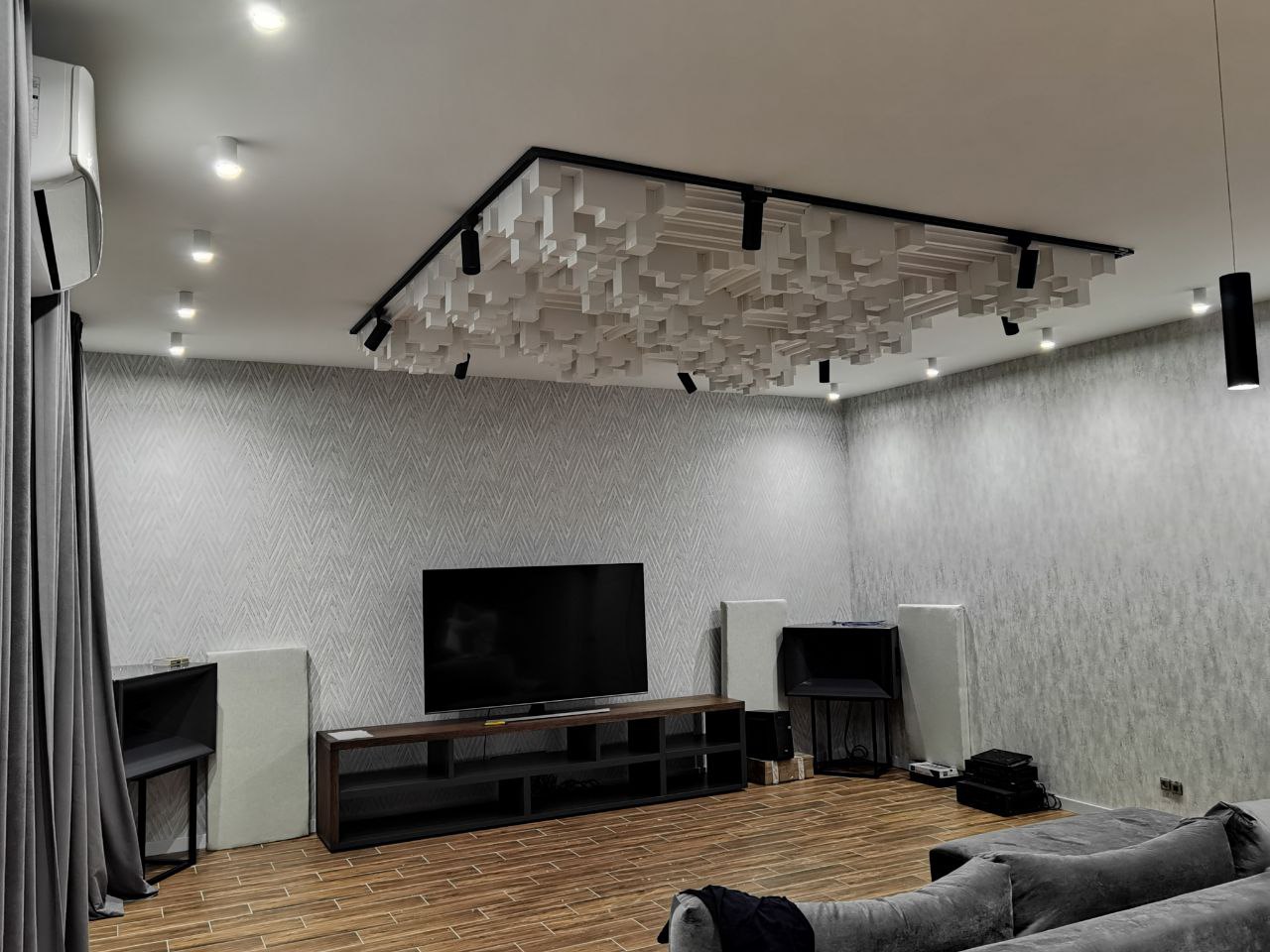

So i finished making my K-402 MEH in wood and brought them in a large room.
There is only A TV desk, speakers, a sofa and that's it.
This is how the room currently look like:
The RT60 times a very huge:
Since this a huge horn with directivity control down to 100Hz, i figured i don't really need much of 'first reflection' treatments. What i need is to treat walls near the edges of the horn and somehow reduce the reverberation time of the room.
I will be placing QRD diffusers on the ceiling covering 3 meters between listening position. To cover half of the space i will need about 13 of them.
This will be made out of high density XPS, painted and look like this:
Will place a rug on the floor between the sofa and listening position.
And on the side walls near the sofa i am thinking of placing Leanfractal diffusers. 3 pieces on each side wall.
Leanfractals on the front and side walls will look like this:
Oh, and 5 diffusers on the back wall with some furniture:
Will it be enough to deal with excessive reverberation? Or do i need more absorption rather then diffusion?

To lower RT you'll need absorption. Diffusion won't hurt ( quite the opposite) and maybe it'll be enough to make the room sound good to you despite an high RT.
But if you need to lower RT i see only two way: either absorbption either some 'hangers' ( but you usually need high ceiling for them).

'super chunk' bass traps in the rear corners looks possible (absorbers). The front upper tri corners also look like you can get some absorbtion in. Nice big room BTW! How To Build SuperChunk Bass Traps That Work - ANDREW MAT

If i was in need to lower reverberation time i would implement an absorbent ceiling: something like rockwool tiles ( rockfon) with 100mm rockwool right over them and a plenum ( free space) of 100mm too with a bit of space ( something like 10mm all around the walls).
It should be effective as a wideband absorber ( when i built control rooms it was the standard practice for ceiling for the acoustician i worked with). You could implement diffuser of same dimension that the tiles too a little in front and above ( if you need them) like this one ( other finition exist) : RT60 - Diffuseur acoustique transparent

A nice one, indeed - thank you! Only very boomy at this time. BTW, i feel that I have become very adapted to the RT in this room. Ceiling height is 3 meters (9.84ft).
Sounds like an option, yes. I will try the XPS diffusers first - they will be ready in about a week or so.

Installed diffusers on the ceiling:
The area is 3 by 3 meters, 9sq/m total. 13 pieces are 2D, which, according to QRDude, will diffuse between 600-2100Hz. Other 12 pieces are 1D diffusers which work at around 2200- 6800Hz.
Hope that mixing 1D and 2D diffusers is not a big problem.
