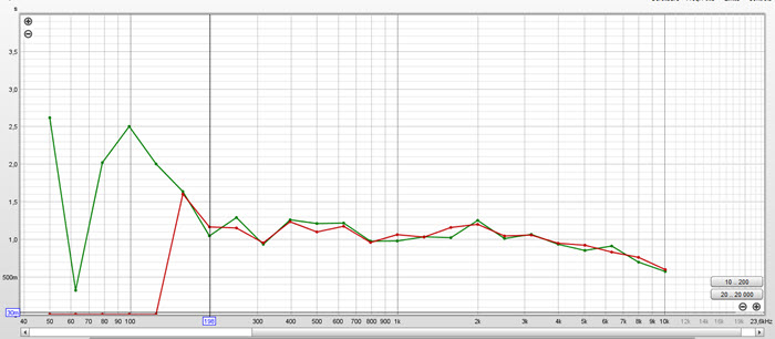

Was playing with EQ today and checked RT times as well. Here are RTs after i installed ceiling and backwall diffusers:
attachment.php
As can be seen from the first post in this thread, RTs were near 1.5-1.8s before diffusers. Now, most of the freqs are near 1s. Interesting 🙂 And the fall in RT in 2K to 10K region is not as deep as before the treatment.
Still have huge problems in low and very low frequencies. Hope to get rock wool broadband absorbers ready and installed by the end of next week.

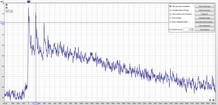

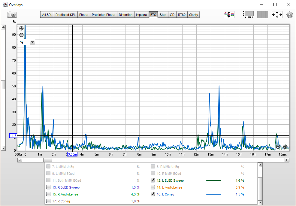

Trying to learn how to use Impulse graph with ETC view.
Here is a bit smoothed version of it:
attachment.php
See some strong energy spikes at about 14ms and 30ms after the initial.

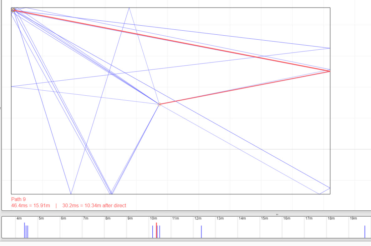

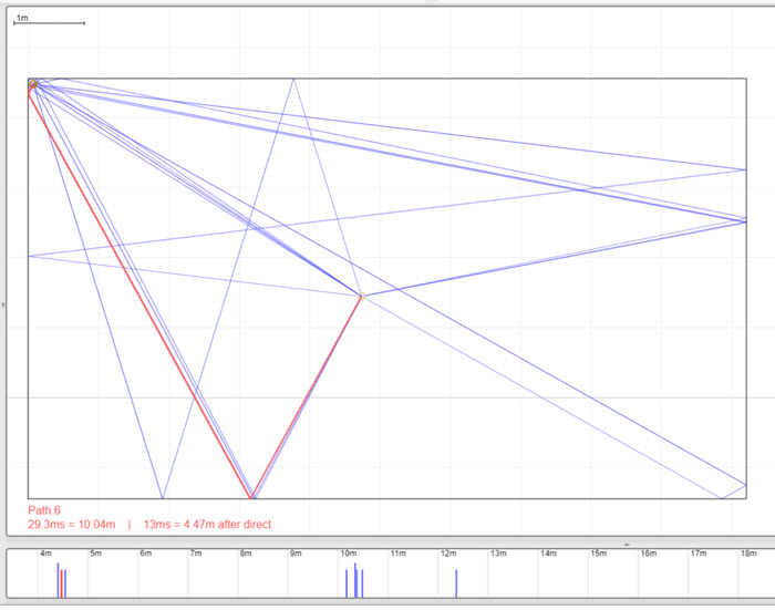

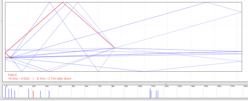

And then i found AmRay tool which allow to draw a simple room and see the sound as rays and how those ray reflect around the room and get to the listener.
According to how the tool, side reflections are happening at around 4.5ms after the initial:
attachment.php
Bounce from back wall is at around 10ms from the start:
attachment.php

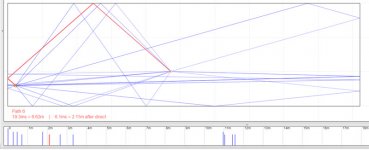

And floor/ceiling bounce also happen quite early:
attachment.php
So I have no idea what is happening at 14 and 30ms. If 14ms is back wall reflection why it is louder that side wall reflections?

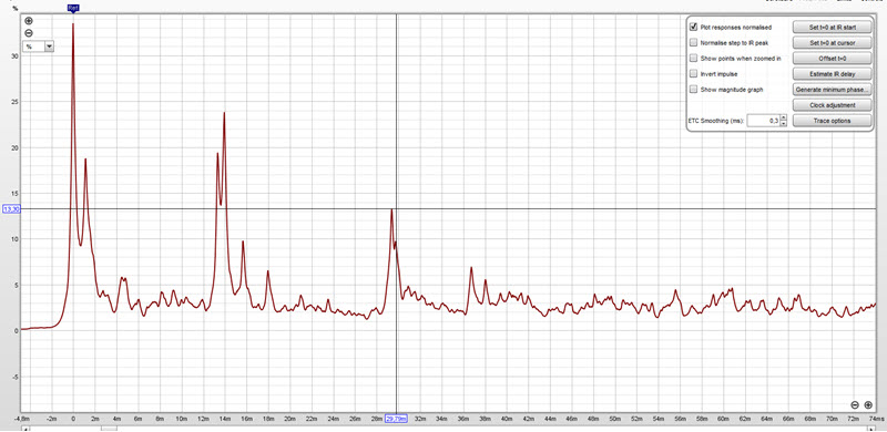

Here is ETC % view, where those spikes can be seen more clearly:
attachment.php
Am I interpreting this graph correctly?

Could'nt the 14 and 30 ms be related to the 130hz peak in the graph in your first post?
Maybe a low freq early reflection?
Do you have a sonograph/wavelet view to share, it could help identify from where they come from.
Except those two peaks the rest looks fine to me, maybe a bit more absorbsion to lower RT a bit more and it should be very nice.
If you treat first reflection point ( wall) with panel (or drapes) it should be effective from 1khz and up.
The range 300/900hz could benefit of a bit of attention too.

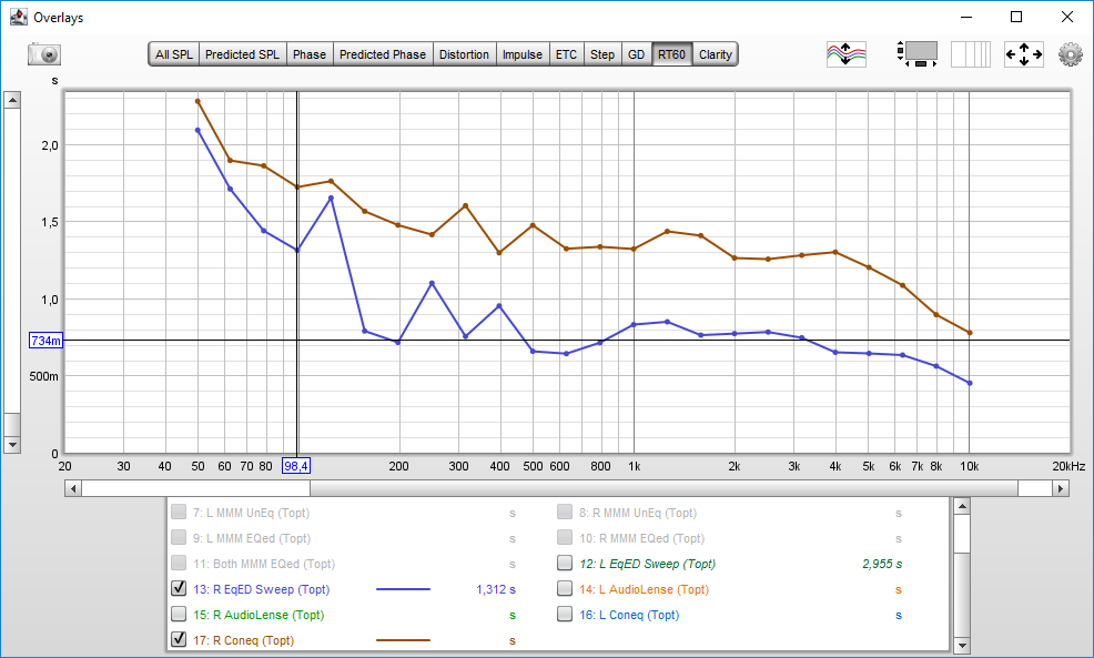

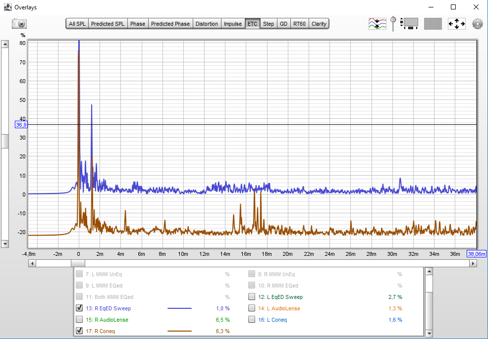

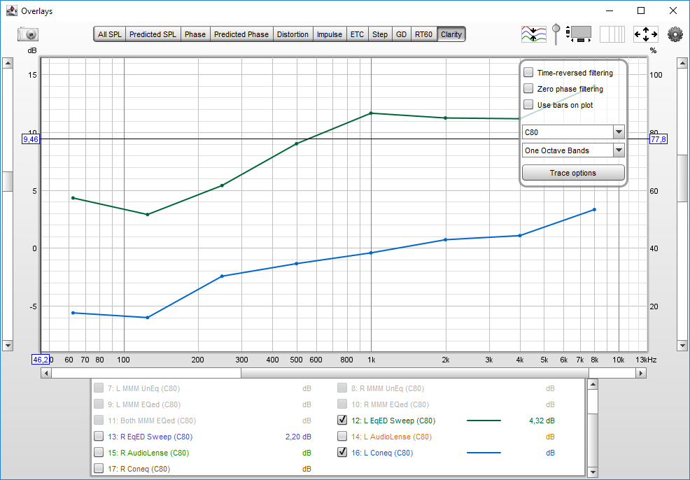

So i've installed absorbers and here is how the whole picture looks like now:
attachment.php
Also, here are some measurements:
ETC:
attachment.php
ETC2:
attachment.php
Impulse:
attachment.php
RT60:
attachment.php
Clarity:
attachment.php
A bit on the sound - it is like night and day. Very big difference. I don't have much experience listening to great acoustics in properly treated rooms but this is the closest thing i've ever heard to "WOW SOUNDS GREAT" 🙂

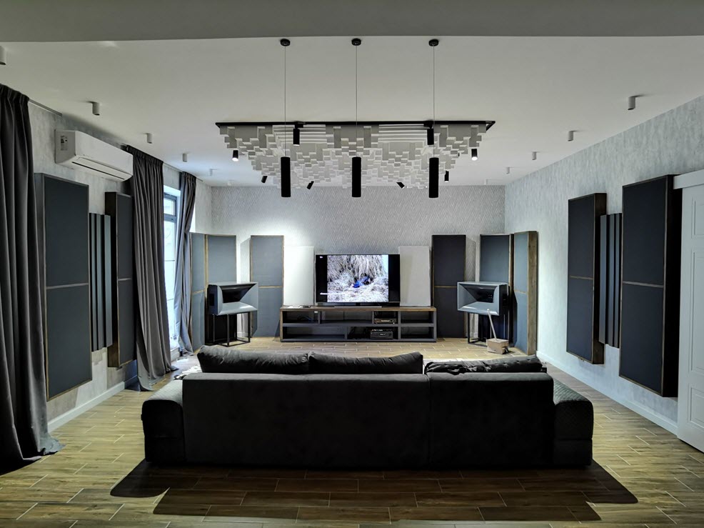

Installed diffusers on the ceiling:
attachment.php
The area is 3 by 3 meters, 9sq/m total. 13 pieces are 2D, which, according to QRDude, will diffuse between 600-2100Hz. Other 12 pieces are 1D diffusers which work at around 2200- 6800Hz.
Hope that mixing 1D and 2D diffusers is not a big problem.
