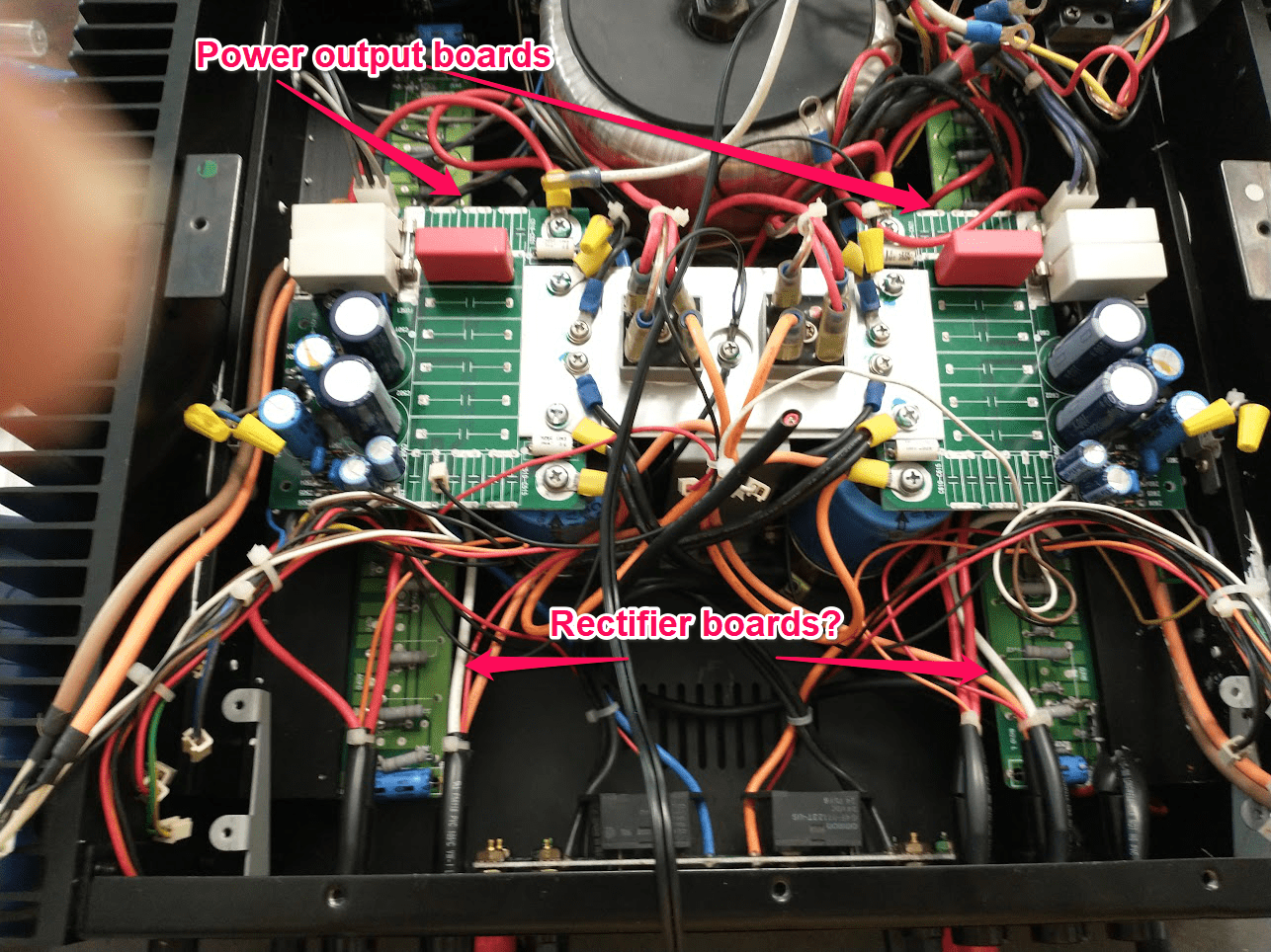

Did you check the rest of the power supply for shorted rectifiers or shorted filter caps?
No, not something that I know how to do. I am trying to eliminate the basics before handing off to a repair shop.
There are a lot of rectifiers - right? Looks like 2 boards, 1 board for each channel. If you mean these rectifiers, then there are at least 10-12 per channel. Each of these boards that hold the rectifiers is connected to both the main input board and the power supply boards. See pics. Note that I have removed the main input board - it goes in the area beside the output boards.
See what it does with the bulb because you can then attempt to measure voltages on the secondary even if the bulb does light brightly.
The rectifiers are those 4 legged rectangular packages. You see you can undo the leads from the transformer to the rectifier as a further test.

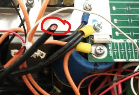

What is this? It looks like a piece of coax cable that has been chopped 😀
That is the load wire going from the fuse to the thermistor board. I had to cut it to get at the thermistor board - I will resolder it back to the thermistor board when I get the new thermistors resoldered. (I was wondering if anyone would notice that wire - good eye. 😉)
It did occur to me that the rectifiers he was referring to were the bridge rectifiers. I can easily disconnect them as you note - another thing to check off on my list.
