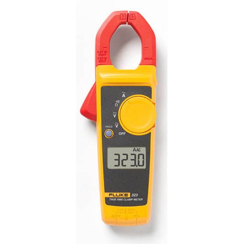

An inductive current meter would be easiest on a single wire on the primary side of the transformer. The wire from the fuse to the switch would work very well if it is exposed for the inductive pickup.
AKA, a clamp-on ammeter or clamp meter.

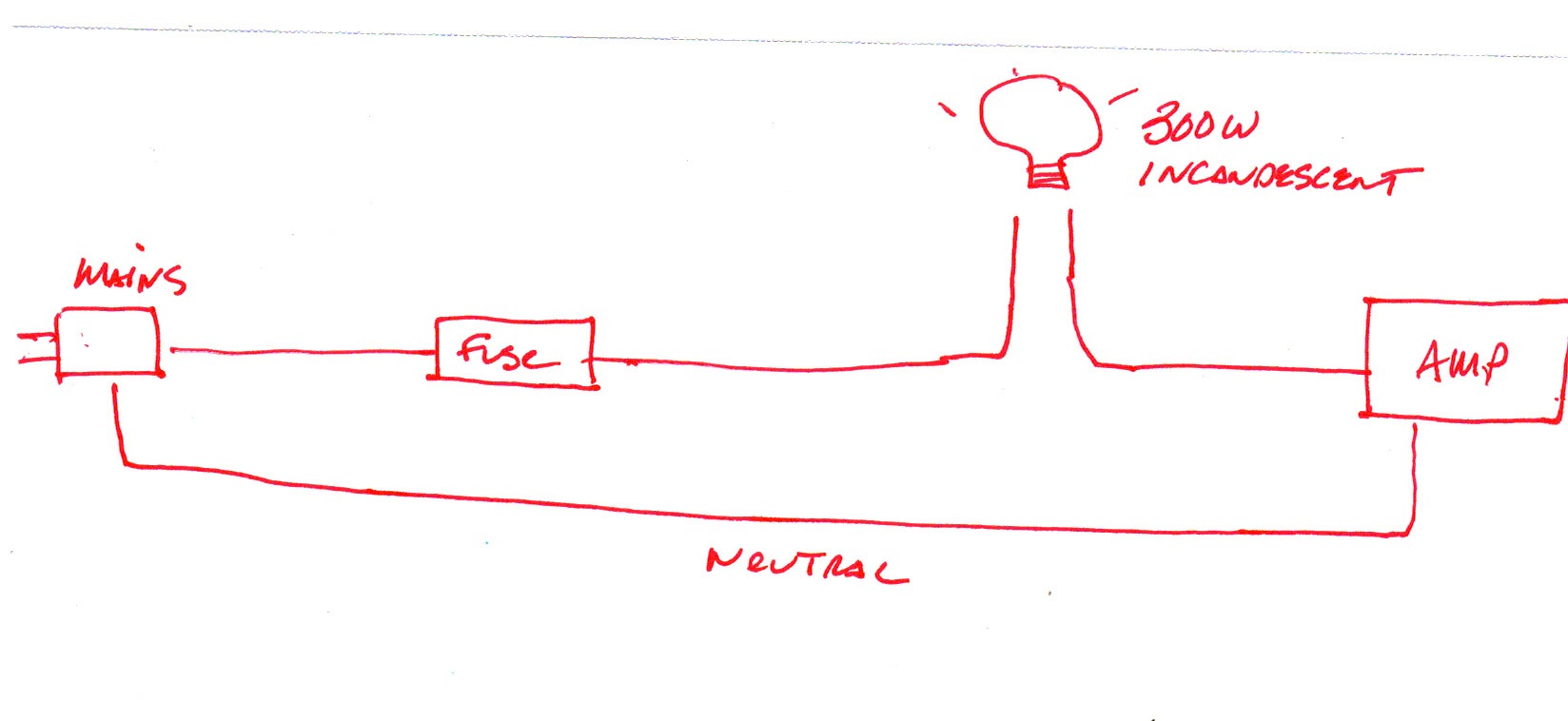

So today I bypassed the thermistor board using the 300w light bulb as the current limiter and I get no hum from the transformer however I think the light bulb is limiting the current flow and the amp is not getting full power. I think this is so because I do not hear the internal relays in the amp click as they normally do when power is applied.
Can I use a different light bulb or some other method to bypass the thermistor board to supply full current to the amp but still protect the amp from the inrush current?

a 100 watt bulb would allow more current to flow, but still limit to a safe level. I usually start with a 100 watt bulb, then go to a 60 watt bulb, then to a 40 watt bulb, maybe overkill, but each step allows more current to flow.
Yea, I thought about that when I wrote it, but when you install the the 40 watt, it tends to light up which actually makes the resistance go down. I need to check that at some point. With a 100 watt bulb it briefly lights then goes dim or out which actually raises the resistance.
When I get a chance, I'll plug-in a normally operating amp and check current with each bulb.
The resistance goes up as the bulb lights 🙂
Measure the resistance of 100 watt filament bulb when cold and calculate the current. The resistance will be really low, around 36 ohms from memory for an old '240v' bulb. As it heats the resistance rises and it draws less current.
So if the amp draws a low current the filament can stay cool and the resistance is low. The amp gets almost full mains. If you fit a lower wattage bulb then that same current might start to heat the lower wattage filament and the bulb lights. The voltage split is now in favour of the bulb and that sees more voltage across it while the amp sees a lower voltage.

So here is what I tried:
1. I connected the 300 watt incandescent bulb as I noted above bypassing the thermistor board. I still got the hum.

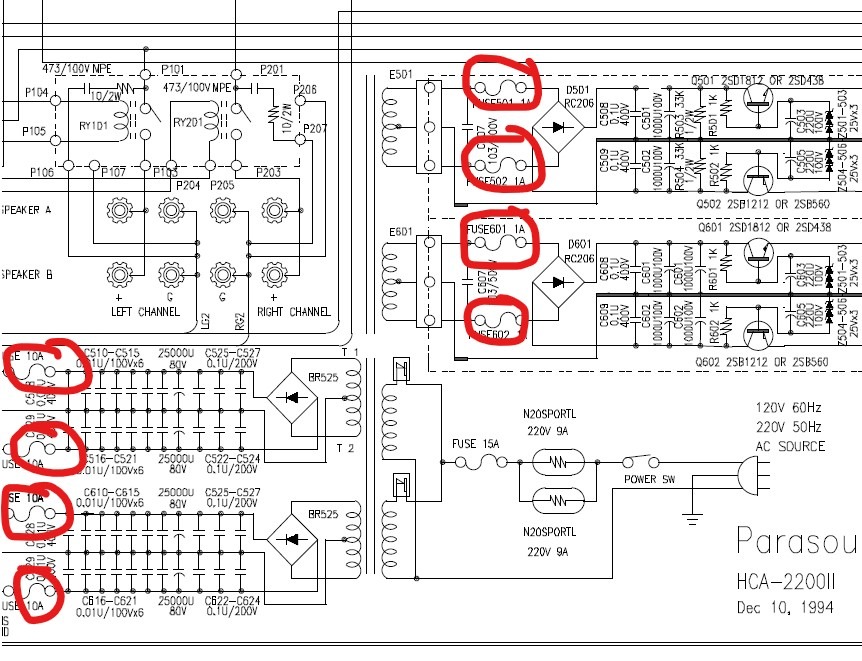

I hate to put this back in my rack like this because something has apparently happened as a result of the fuses being blown.
I still think you might be noticing something that may have been present before. If the amp had a problem (whatever that might be... and I don't think it does) then it can only influence the transformer by means of current draw.
Why not pull ALL the rail fuses and power up just the transformer and see what its like. I can see eight fuses.
Remember to discharge all the rails before replacing fuses
You can also use your bulbs on the main DC rails to give a modest load and see if that alters the noise.
