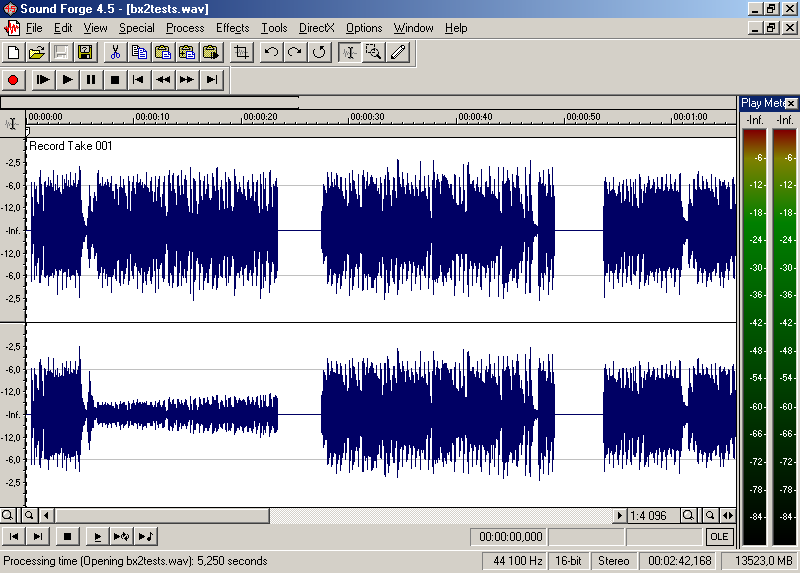

Now, I started to try recording this week. The right channel recording has gain problems, it seems compressed and sometimes gain is just going gradually low, high, low, high...
That was when I tried Dolby C with FM(MPX on). I made a few tests and the problem did not show itself. Instead, in one of the tests(MPX off, dolby off), the gain reduced drastically while recording a mono track. In the next test, it was OK. (See attachement)
It seems to be some transistor problem like my hk670 amp.(I still haven't solved this)

Hi DragonMaster,
I hate to ask, but ... did you check the tape path and capstan bearing?
A machine with motors this worn has had heavy use. I'll bet the tape is being drawn in towards the mechanism due to a worn capstan bearing.
I am really sorry to say this, but I am thinking your machine needs an overhaul.
