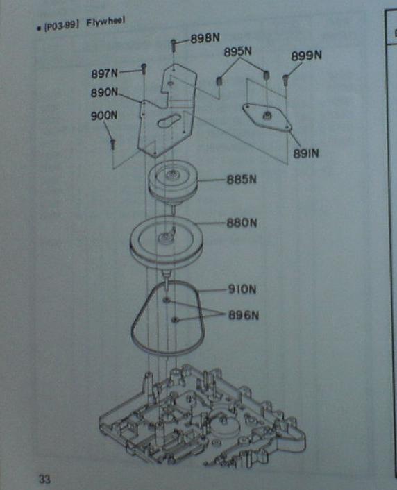

Long ago when I was a kid of 9 or maybe 10 I bought a CD-330 without being able to test more than playback which worked at the time, recording never did, all I got was noise (crackling and loud popping noises on ARL if I remember correctly, on manual just one channel with some noise). Now that I have some limited experience with electronics I decided to open it up and give it a try since the only other option seems to be throwing it away.
The unit is fairly mangled, one of the front cover screws was broken (deliberately as I discovered, the nut glued into the casing turns freely, so the previous owner broke the screw head off in order to open the unit) and several screws are flat out missing. The whole exterior is scratched and even shows traces of intimate contact with a soldering iron.
Anyway, after 15 years of sitting around the machine was worse for wear - all belts had started to disintegrate (fortunately I had expected this and removed them before trying to run the recorder or they would have gotten all tangled up). I temporarily replaced them with household o-rings and cleaned most of the drive assembly with alcohol (as far as I could get without disassembling more than the flywheel bearing plate). Now the speed seems pretty even (albeit slow), even with the clearly inferior "belts". Playback sort of works but is strangely intermittent, apparently a mechanical problem. One thing I discovered is that the long stud near the cassette compartment no longer threads into the front cover and the front cover is pushed away by the cables - which seem to get in the way, no matter how nicely I try to dress them up. The cover pulling away of course messes up the tape-head-contact. I'm not sure if this is the only problem though.
Do you have any creative ideas what I could do about the cables running along the connector PCB and drive subchassis PCB and how I could get that stud to thread again? I tried screwing it into the removed front cover but it turns freely and won't go in, not even with moderate pressure, which seems to indicate there's something stuck in the threads.
