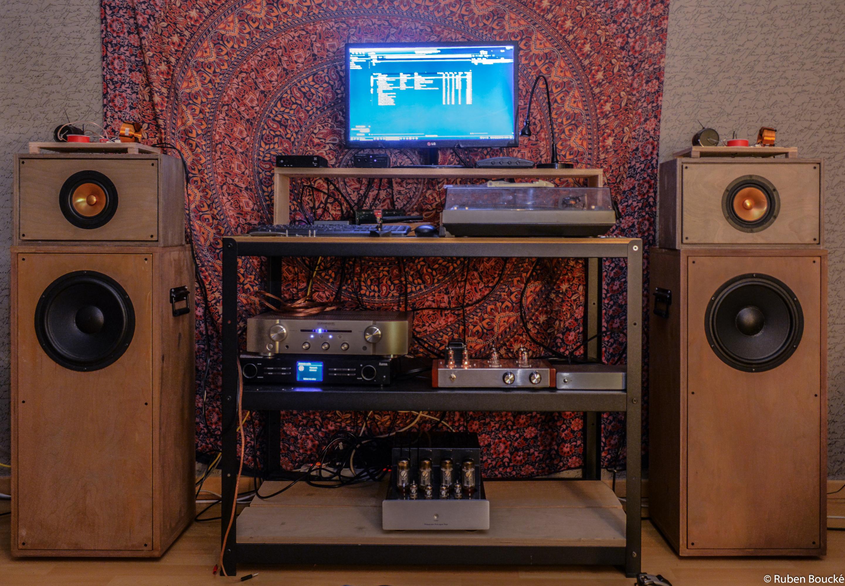

Not a kit, but easy to make rectangular box. Perfect for stand mount and TPA3251 amp. I use TPA3255 and it sounds great. It is a FAST design (full range on top and a woofer to assist with bass and mid bass).
10F/8424 & RS225-8 FAST / WAW Ref Monitor
Photo may give you ideas as being similar to your room - even 0.6m stands:
802945d1576612905-10f-rs225-fast-speaker-xo-pcb-gb-10f-rs225-speaker-system-photo-jpg
Very simple 100% open source design. XO is simple to make P2P. Need access to Dayton RS225-8 - key ingredient that cannot be substituted.

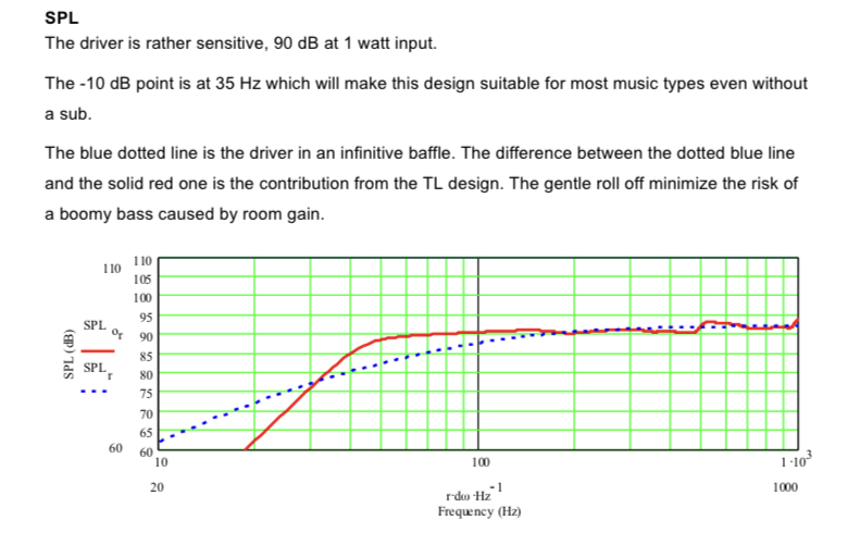

Edit: actually, Bjorn has already designed a MLTL (Tabaq) for W5-2143. Nothing left to do but build it!
TABAQ TL for Tang Band

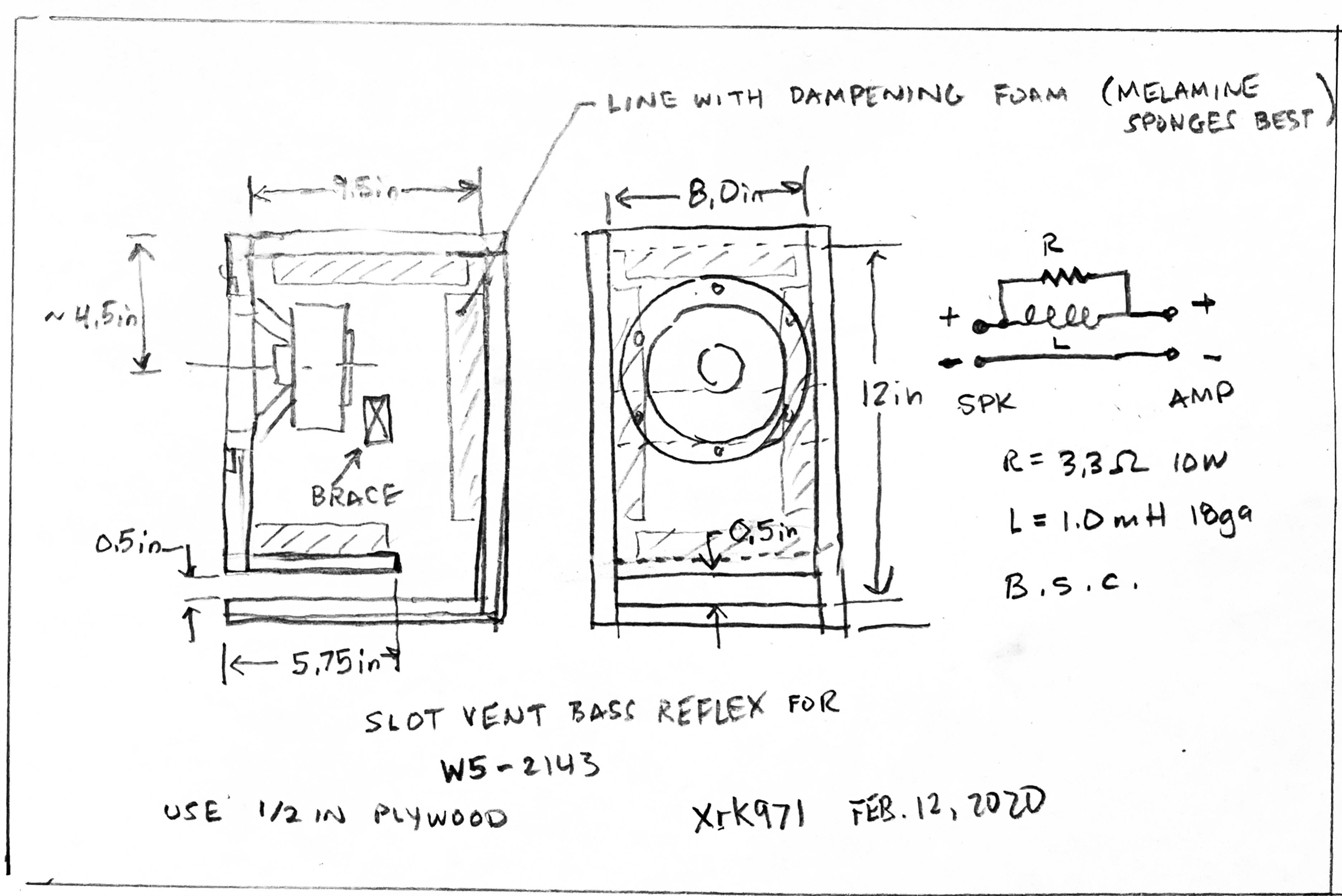

I evaluated the TABAQ after one the previous message suggestions, but sadly I have an height limit of 85 cm.
If you or perceval could help with the layout of a bassy bookshelf (<= 35cm) or floorstander (<= 85cm), with a W5-2143 it would be great 😀
You can fold it and put the driver still 11 in away from closed end and make total line 39in. Total height plus wood thickness assuming 1/2in plywood would be about 22in tall. Driver would be near the top and vent would go out the back. There are other ways to fold it as long as you adhere to the basic formula.

Here is a slot reflex design that’s nice and compact and will get you about 55Hz bass. Key dimensions are (internal) 8.0in wide x 9.5in deep x 12.0in high. Vent is 0.5in gap x 8.0in wide x 5.75in deep. Line inside walls with eggcrate foam, or carpet padding, or (best) melamine eraser foam pads. Add a puff of polyfill internally. Use a baffle step correction of 1.0mH 18ga inductor (air core or iron core) and 3.3ohm (adjust to taste) 10w resistor to balance the highs and bass.
