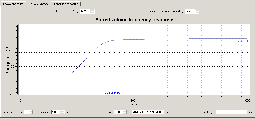

Thanks, Perceval. Can you put the slot vent dimensions that I have in and check? I think the volume is 14.25liters (after vent subtracted) and 0.5in x 8.0in CSA vent x 5.75in Long.

For those numbers, the only difference in my program is the length of the vent, at 5.35".... I doubt it would make a big difference.
It's a software I use to do quick checks on volume and vents. You just need to key in a few params and click optimise!
Very quick, but also limited to just that.
It won't give vent air velocity, cone displacement, or even output level.
But for quick checks, it flies !
It's called QSpeaker.

This design still checks out - tuning is somewhere in range 55Hz to 60Hz, but that can easily be tweaked with the vent length. The 55Hz to 60Hz is about ideal though, I would not go lower than 55Hz. That is fine as the kick drum is centered there.

You can try tuning it lower by making the vent a bit longer and use room gain to reach 30Hz. So make the vent about 7in long using a taped on slot extender. If it sounds good, glue it in place (from the inside).

Predicted frequency response:
