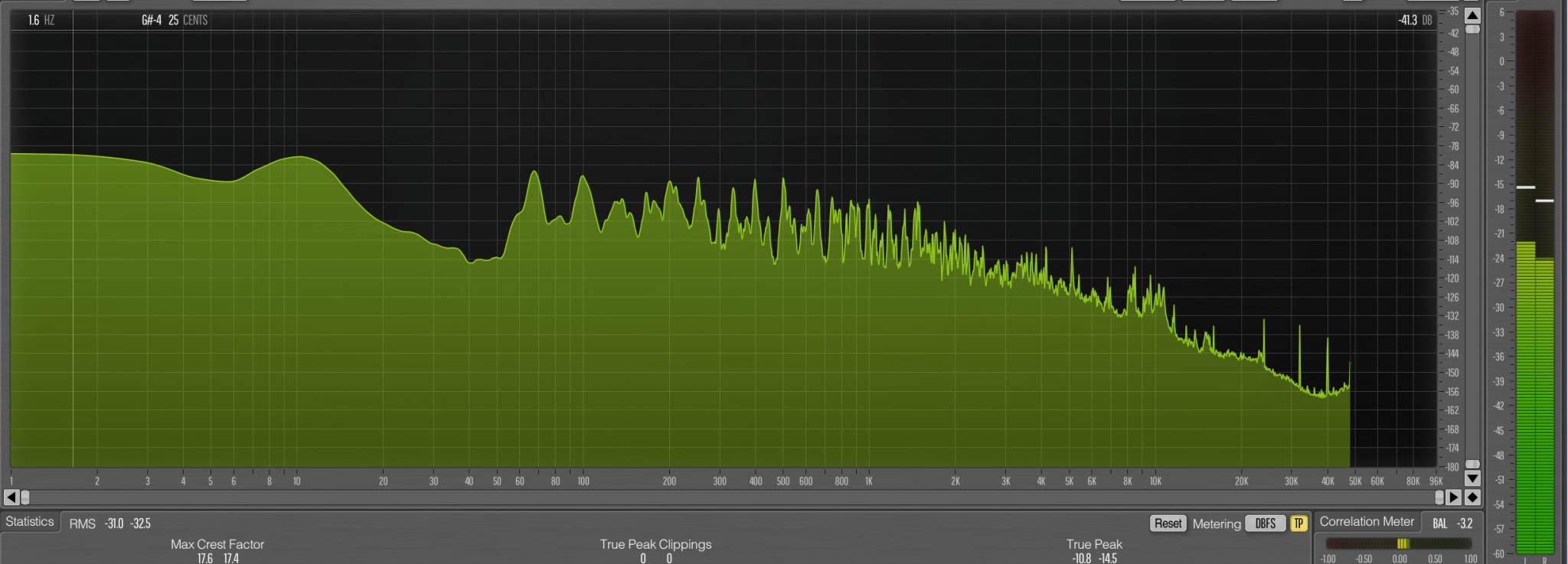

After all this tinkering and observing on grounded input, I finally put the preamp back to work on a turntable. I noticed that when music is playing that the very large plateau of low frequency noise drops significantly in my FFT (plateau goes down to around -84dB or so instead of sitting at around -40dB or so). Perhaps this is just an artifact of the FFT calculations and what can be perceived when so many other frequencies are dominating the overall picture. Has been a long while since I was studying FFTs and using them hands-on (in a former programming and research life).

That's most peculiar. The FFT is just an algorithm/group of algorithms to calculate a DFT, and a Discrete Fourier Transform is supposed to be linear. What you describe is clearly nonlinear.
Could it be that the music drives the measuring equipment that calculates the FFT into clipping? If so, that could explain it.

I'm not sure, but here's a graph while music is playing. Notice the low frequency shelf isn't sitting so high now.
