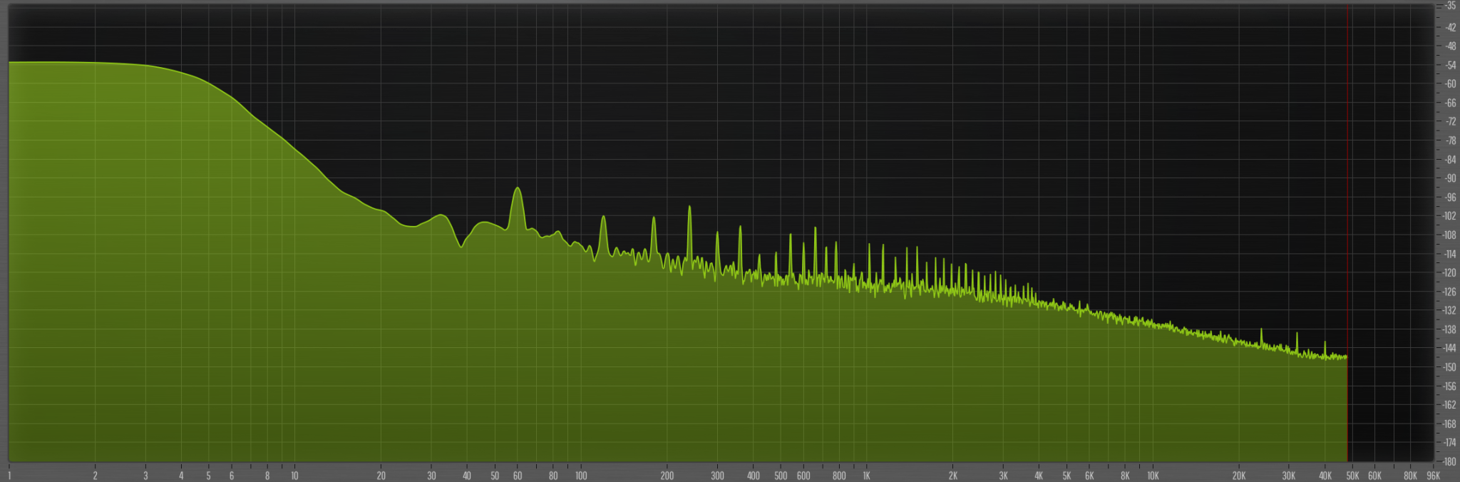

@MarcelvdG and others, I completely botched that first graph. I didn't realize that I had a slope parameter applied and did not increase to max resolution.Looking at the plot in the opening post and assuming it is a power spectral density plot with a vertical scale in dB:
Instead of dropping, the noise PSD slightly increases with frequency from 1 Hz to just below 50 Hz
It drops at a remarkably high rate between 50 Hz and 100 Hz, much steeper than the approximately -9 dB/octave you would get from 1/f noise plus RIAA correction
The 120 Hz peak is a rather wide bump; apparently the frequency resolution is not very good
As a result, my first two comments may be nonsense
It would be nice if we could get a spectrum plot with better frequency resolution

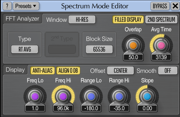

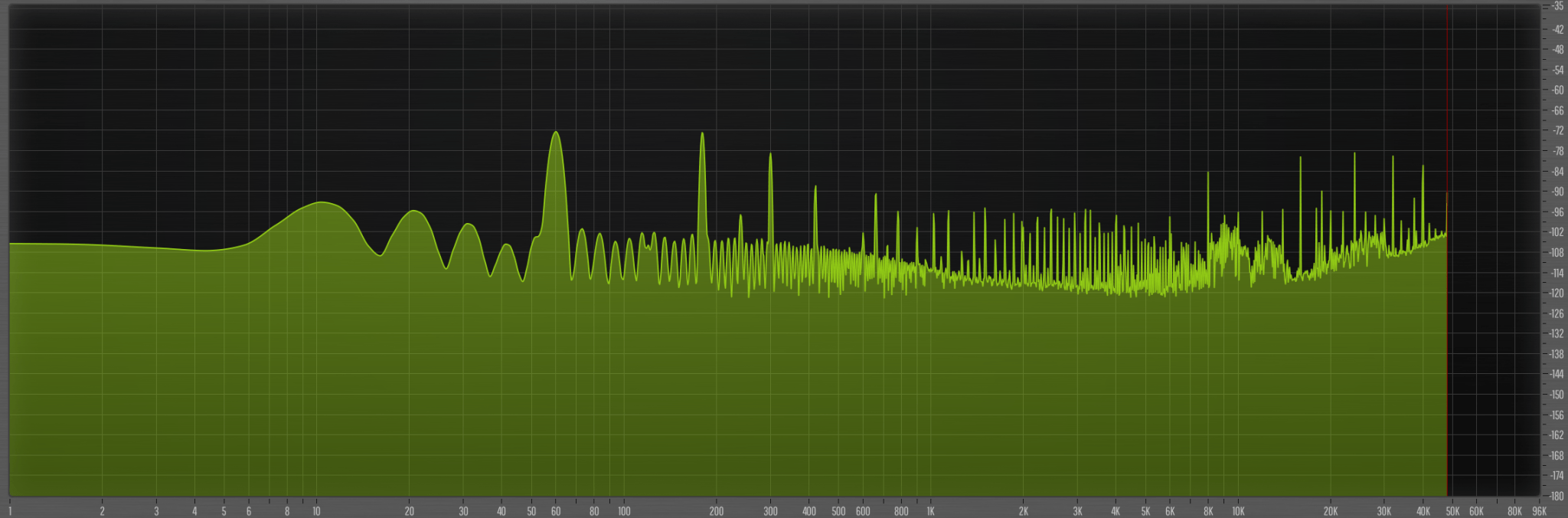

I ran the FFT again and am posting 3 photos with higher resolution and no slope applied. One shows the FFT settings I'm using in SPAN Plus, the next shows the noise in one channel with the circuit as is, and the next shows the noise in one channel with the first stage decoupler RC pole moved to 10Hz with a parallel resistor per @rayma recommendation.

Sorry, it is pretty useless to do an investigation like this in your case if you want to decrase noise.
No worries. Thanks for your help. I will continue my investigation though because I'm trying to understand and hopefully locate the source of the noise (would prefer not to simply filter out in the input stage if possible) + learn as much as I can along the way. Even if the end result is that I leave things exactly the way they are, I'll be better off for trying. I am not nearly as proficient as many who have patiently and generously offered advice so I thank you and everyone else who have done a good job of pointing out important concepts and making thoughtful suggestions. I came along looking for good tactics and strategies, and you and others have delivered many of those. Sincere thanks again!Sorry, it is pretty useless to do an investigation like this in your case if you want to decrase noise.
