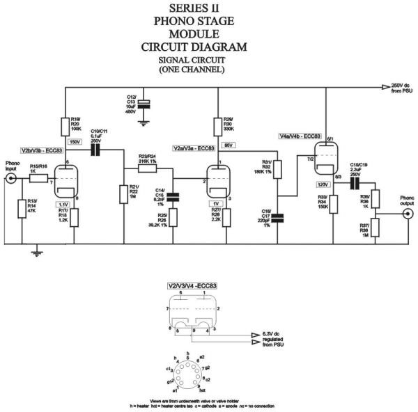

I built a 12AX7 based phono preamp with an RC 'passive' filtered PSU a couple years ago that had motorboating issues. I'd be playing a record and it would make these weird, intermittent, rolling rumbles from time to time. I thought the rumbles were from cargo planes flying over my place, until I realized the rumbles happened only when I was playing a record. Finally, with some help from good folks here at diyAudio, the problem was found to be that I had too short of a time constant in the decoupling to the input 12AX7. I think record warps were exciting 1Hz or 2Hz oscillations or something like that, and I was hearing (more like sensing) harmonics of those infrasonic frequencies being played by my poor woofers flopping around uncontrollably in their bass reflex cabs. The cure was to increase the value of the series R in the RC decoupling network between the first and second stages (increase the time constant). That fixed it, and the preamp is being enjoyed today.
Here's the schematic from Lenco Heaven. Is yours built like this one? If so, I think it's likely that there are infrasonic oscillations happening, causing you to hear harmonics of those in the extreme low audio range.

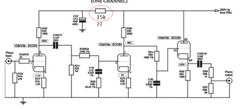

I would decouple the first stage plate supply feed by adding an RC network between the first and second stages -- especially if the 250V B+ isn't well regulated. Try 10k ohms and 100uF (for C12/C13), or 22k ohms and 47uF (for C12/C13).

Yes, almost exactly like this. And heater supply is regulated DC. High voltage side is a bit less regulated. Transformer high AC voltage is rectified, filtered through a choke, and sent to the MOSFET. There are obviously some resistors and caps in between and in parallel, but that's the general idea. I need to study the high side of the power schematic a bit more to fully understand it and to provide a better frame of reference.Here's the schematic from Lenco Heaven. Is yours built like this one?
This seems like a good idea though I'm not entirely sure how to execute it. Are you saying to add an additional RC filter before the plate of the middle valve? Or are you saying to replace C12/C13? Where would the corresponding resistor go?I would decouple the first stage plate supply feed by adding an RC network between the first and second stages -- especially if the 250V B+ isn't well regulated. Try 10k ohms and 100uF (for C12/C13), or 22k ohms and 47uF (for C12/C13).
Keep C12/C13.
Then I was thinking a new resistor would go here:
You don't want subsonic noise amplified by V2b to be fed to V2a inverted 180 degrees, since V2a is also an inverting amplifier, so the subsonic noise signals will now be in phase and thus amplified (positive feedback), and could oscillate, causing those intermittent low booming noises.

Don' t you need additional capacitor between V2 anode resistor and proposed 15K series resistor ?
As the designer of the final schematic and power supply, the HV side is a series pass regulator (IRF840). The HV supply is rock solid. He is having some serious issues with the heater supply. It is also a regulated (LT1085) DC supply. My original build had no noise or voltage issues so I have been trying to help troubleshoot but am a bit stumped since I no longer have a working unit on hand to compare. I did notice tube rolling affected things a good bit and recommended 12AX7LPS but would not recommend 5751 as the Rp is part of the RC RIAA EQ network and that will change the filter corners. I have tested the accuracy and it is within 0.2dB from 20-20kHz.

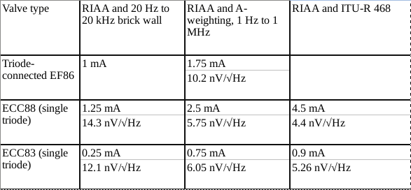

According to the data in Merlin Blencowe's ( @Merlinb ) AES article about triode noise, for which he measured the noise levels versus anode DC current of dozens of valves of various different types, ECC83 / 12AX7 is actually pretty good noise-wise.
I once calculated the ECC88 and ECC83 rows of this table based on Merlin Blencowe's data. The EF86 row is based on my own measurements of a very limited number of EF86's. The currents are the optimal anode DC currents and the number of nanovolts per root hertz is the white input noise voltage density that would result in the same integrated weighted noise as the noise of the actual valve.
