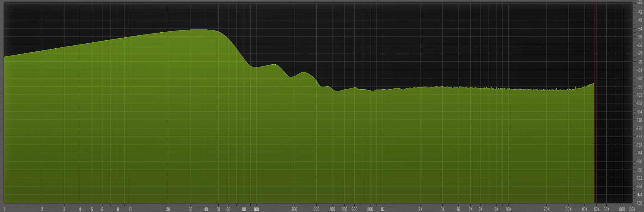

I recently built a tube phono preamp, and I am having a difficult time tracking down the source of low frequency noise (20Hz and below). My overall noise floor is bouncing up and down and peaking around -25dB or so. Per the attached graph, much of this noise is in the low frequency range. You can also see a couple of spikes around 120Hz and 240Hz likely from DC power. The attached plot was taken with inputs shorted to ground at the PCB. I have tried numerous tactics for tracking down the source of the noise, but have failed so far to figure this out. Here are a few additional facts and thoughts below:

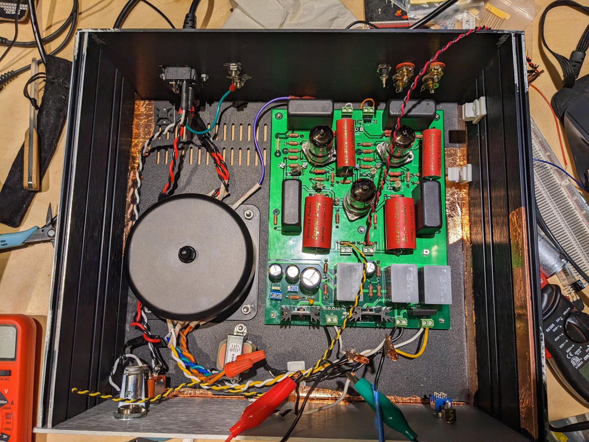

Just for reference, here is a photo of the guts. It is in disarray at the moment as I'm testing a few things and working out an issue with the heater power. I don't have any of my star ground connections running in this photo as I was doing some trial and error wiring during my tests.

If your high voltage power supply is one with a chain of RC filters rather than a regulator, maybe it's due to slow random mains voltage variations. When I look at the output of my tube phono preamplifier with unregulated supply using an oscilloscope and zoom in enough vertically, I see the signal randomly move in and out of the picture.
If it's something with an LR8 regulator, maybe the noise of the regulator.
Reactions: Zonki
Consider 1/f noise from your input tubes, most of this noise will be below 20Hz, and is very sensitive to operating point, reducing the plate current slightly may help. Another option would just be to try some different 12AX7A, and perhaps 5751.
Note that you can wind a few extra turns on your Antek toroid and add them in series aiding with the 6.3V filament winding, the cover may not fit. Note that increasing the filament voltage might actually make the problem worse.
Mains voltage wander can cause problems too, this can be confirmed - if the noise envelope changes significantly from measurement to measurement that may be contributing as well.

Before anything else, i would make sure there are no tube/socket contact problems. Next i would make sure there is no carbon composite or "cement" wirewound resistor (especially Vitrohm) anywhere. And offcourse, as allready said by mpdaudio, reflow your solder joints and make sure they are brigth and shiny.

Try moving the pole from the first coupling network upward in frequency, to at least 10Hz.
With that 0.1uF coupling capacitor you have now, this means the grid resistor would be around only 150k.
Though it would be preferable to have values more like 1M and 15nF instead, if you have that value around.

One other thing I did not mention...I have a resistor on each side (left right) for a 75us corner. I used single slot terminal posts for these resistors because I wanted to try things out with and without this resistor - and I considered installing a switch for the two options. In hindsight I think I'll just solder this resistor in. They're making good contact and are "in the circuit," but seems like another opportunity for noise with the terminal posts there. Maybe not...

Replacing the 0.1uF capacitors with 0.047uF or 0.022uF may help, but may affect the accuracy of the LF time constant at/below 3183us, and therefore it will also affect the flatness of your LF response below 100Hz. Is the noise actually causing a problem in your system - or is this just an attempt to make a worthwhile (and possibly unachievable) performance improvement?
