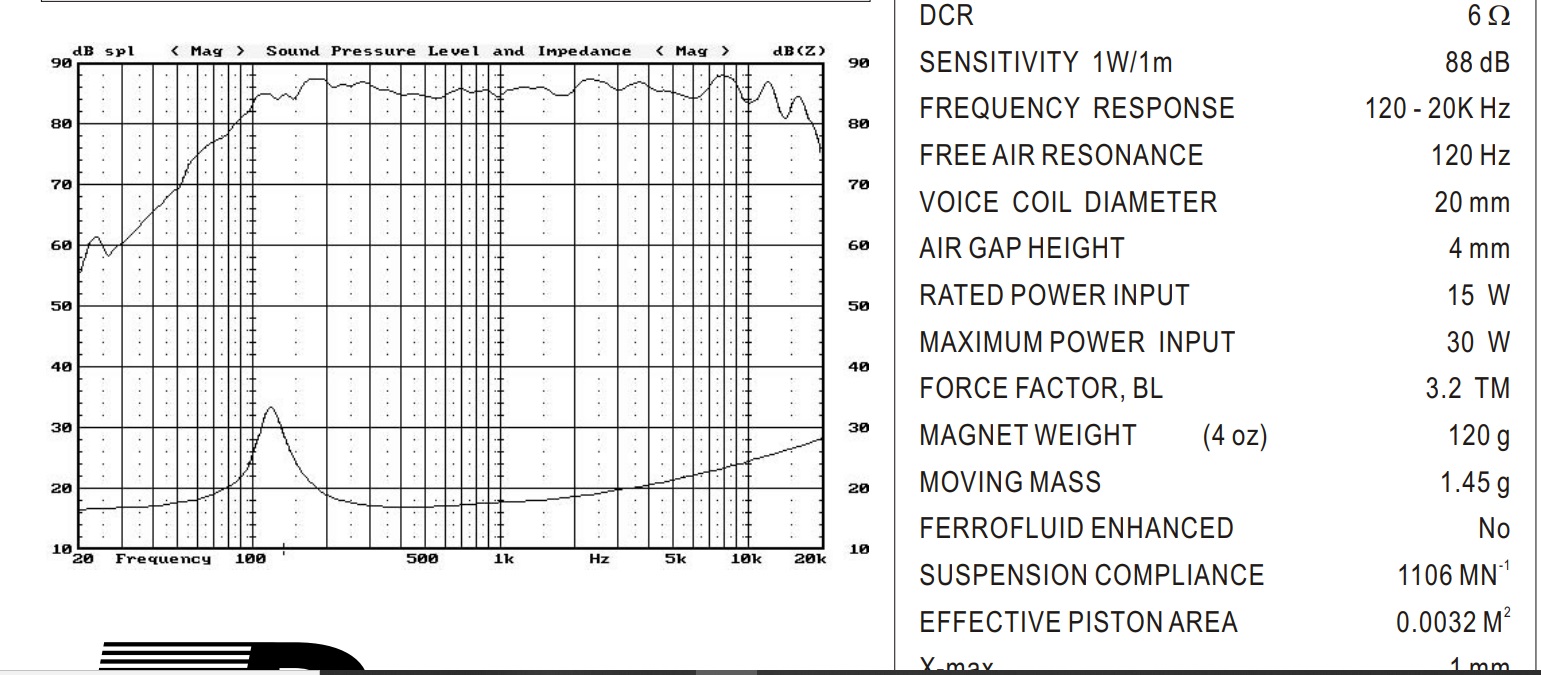

I've AcQUIREd a copy of X-Sim, but don't have FRD/ZMA data files for my Tang Band W3-665sc drivers (on close inspection, they look like essentially the same driver as the TB W3-593SF, but without the silver color). Sadly, I can't find the files on PartsExpress' website. 😕
Any referal links or data would be appreciated.
-Charles
