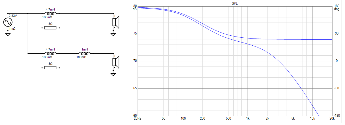

Starting out with the basic circuit, not simulating with real driver data. This shows a way to do the baffle step, and then to add a filter to it. In both cases changing the inductor value changes the frequency.
It can smooth it. The frequency might change slightly but it doesn't go away.does rounding or chamfering the baffle edge change the baffle-step at all?

I see in the lower half of your diagram there are TWO series inductors. It looks like the second is a low-pass filter at a higher frequency, affecting one of the two drivers shown.Can you clarify for me (Not exactly certain of how to use this with my 12 driver array)?

Ok. I read more on the subject.
I see the parallel coil and resistor are the (6dB) baffle-step compensation for a baffle approximately 17" wide (just a generic example?).
The series coil is a low pass filter for a crossover of around 1.2kHz. -Am I close?
Which modeling program are you using? It looks like XSim, which I just recently downloaded, but not yet learned to use.
For now I guess I'll try about a 1.5mH // 7ohms and make a bracket to attach my tweeters to the side and see which one seems to blend best with a simple series cap up high.
May I still take any suggestions on how to proceed with a proper crossover?

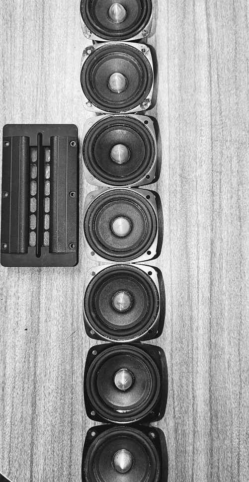

The baffles are apart now on my wood bench, but here are some of the 3" drivers I'm using, along with a Dayton PT2 planar tweeter, for scale.
Again, I have up to twelve TB W3665SC(88dB, 8ohms each) per side (wired series/parallel), with a planar tweeter (94dB, 8ohms) for the top end.
Any ideas (other than a simple series cap)are appreciated!

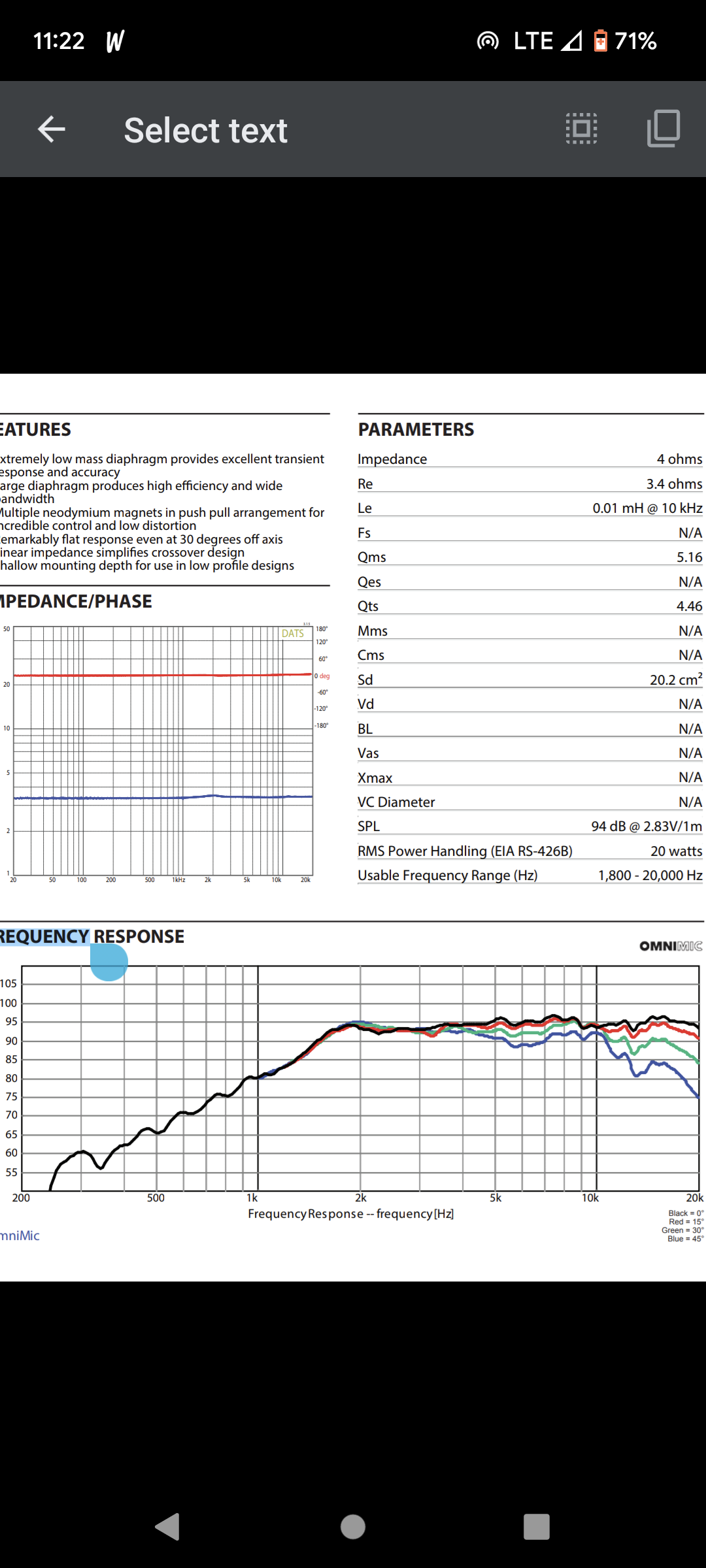

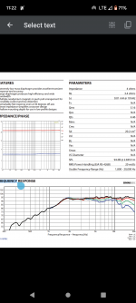

Here's another planar tweeter that is within my budget:
(Both it and the PT2 are 94dB sensitivity (4ohms vs 8 ohms).
Any experience crossing over either of these two? The ,3" full-range units are pretty extended, with good off-axis response up to 3-4kHz. Another nadvantage of the GRS is that it will fit directly on the baffle, in place of one 3" driver. This facilitates it's integration by reducing offset and CTC spacing.
