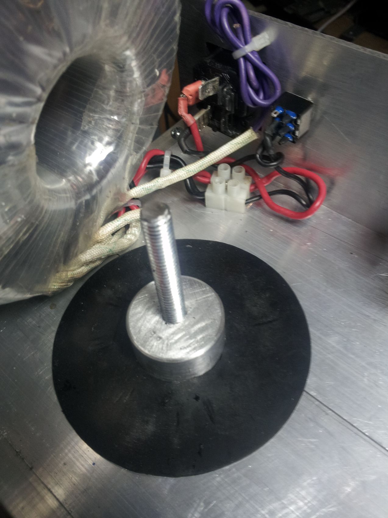

Have you ever used Original J B Weld? People use it to repair axel bearings and engine blocks in automotive applications.
Perhaps glue will adhere a disc of sheet steel the same diameter as the toroid. This disc is dished to a depth greater than the height of the bolt head. Now the toroid is bolted to the steel disc, and the disc glued to the chassis. (This 9 lb, 400VA toroid), for example, would need a disc 13 cm in diameter, and the dishing would be a circle about 3 cm in diameter. The gluing surface is an annulus whose area is Pi x (6.5^2 - 1.5^2) = 125 square centimeters.
Wikipedia says JB Weld's adhesion is 12 MPa, so it can support a weight of 1.2 million kg per square meter of glued area. For the 125 cm^2 disc, that's a weight of 15,000 kg. The toroidal transformer weighs 4.1 kg, so the glue is 3700x stronger than necessary to hold the transformer when the chassis is turned upside down. 370x stronger than necessary if the inverted chassis undergoes an acceleration 10 times the force of gravity.
Anyone with a Quasimodo in the UK feel like giving my toroid a bell to see if it rings?

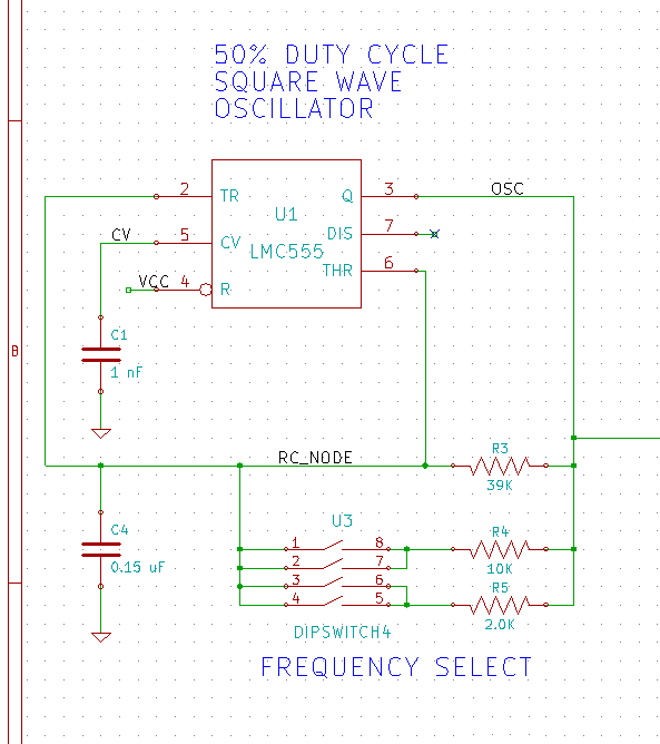

Also one (naive) question regarding the Quasimodo itself: it uses a 120Hz oscillator; in a 230V 50Hz environment does this matter?

Re the Hz question, I was noting the points under "Detailed Circuit Design" in the pdf. Thanks for highlighting the point in the schematic in the thread.

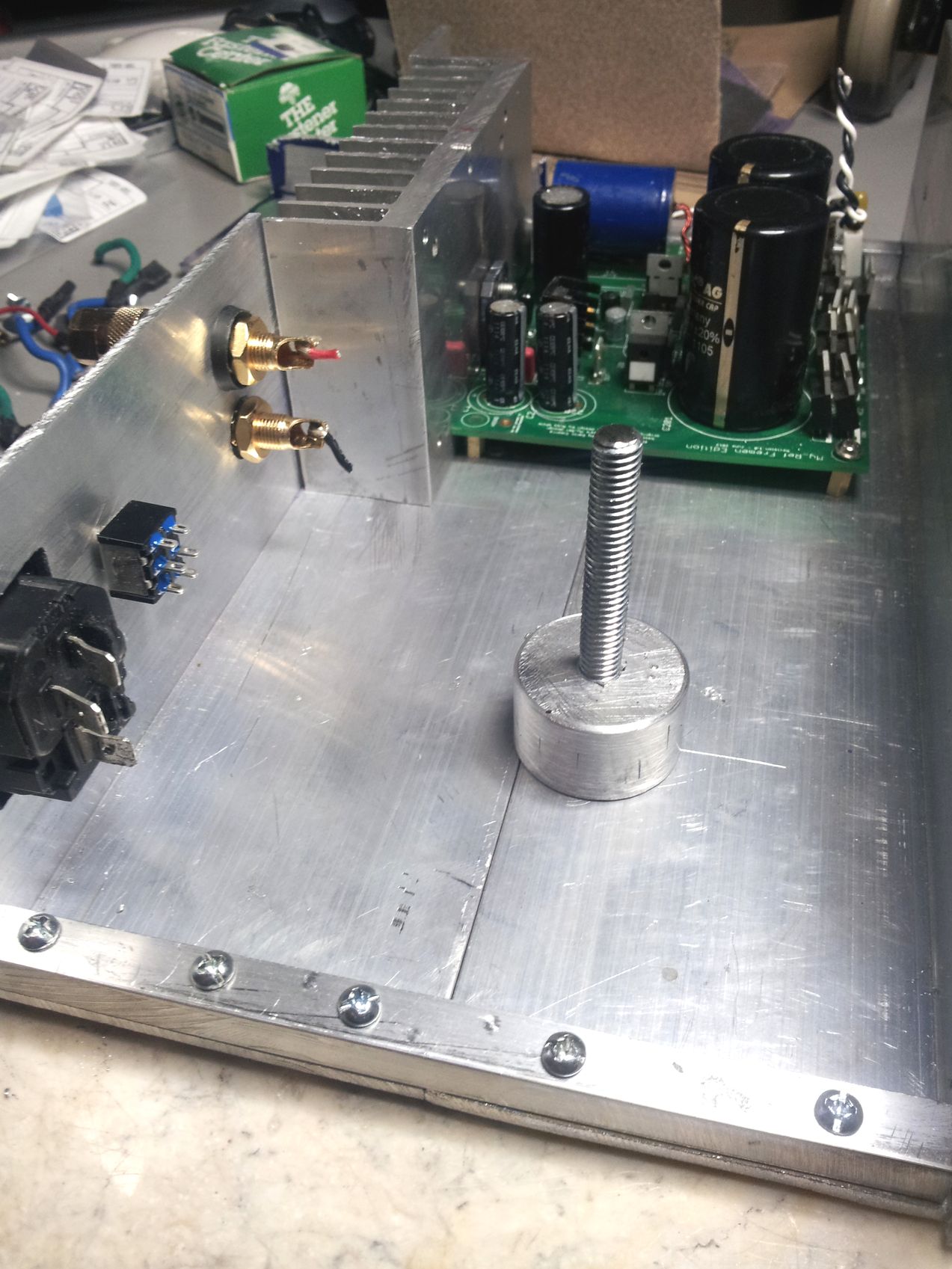

Dont know if this helps, but I avoided the protruding bolt head problem by using threaded rod, round stock and thin-wide head screws. The 5/16" threads were cut continuously through the puck and bottom as though they were one piece. The three screws are ~ 3/4" long and end ~ 1/32" short of the top of the puck.Exactly! 🙂
Another practical, basic question. Mounting a transformer via a bolt through the bottom of the chassis is rather unsightly. I would prefer not to have the bolt head protuding through the chassis. This seems to be managed often enough (the Bryston BDP-1 is one example that springs to mind).
Before I get out the J B Weld to the bolt head, how is this typically accomplished?
BTW: We often used Devcon - industrial version of JB Weld - to repair holes and cracks in major high pressure turbines at power generation plants. The stuff is simply amazing, but I don't remember an application where "pull stress" was the major consideration. Mostly used as a filler.
Thanks Bob.
