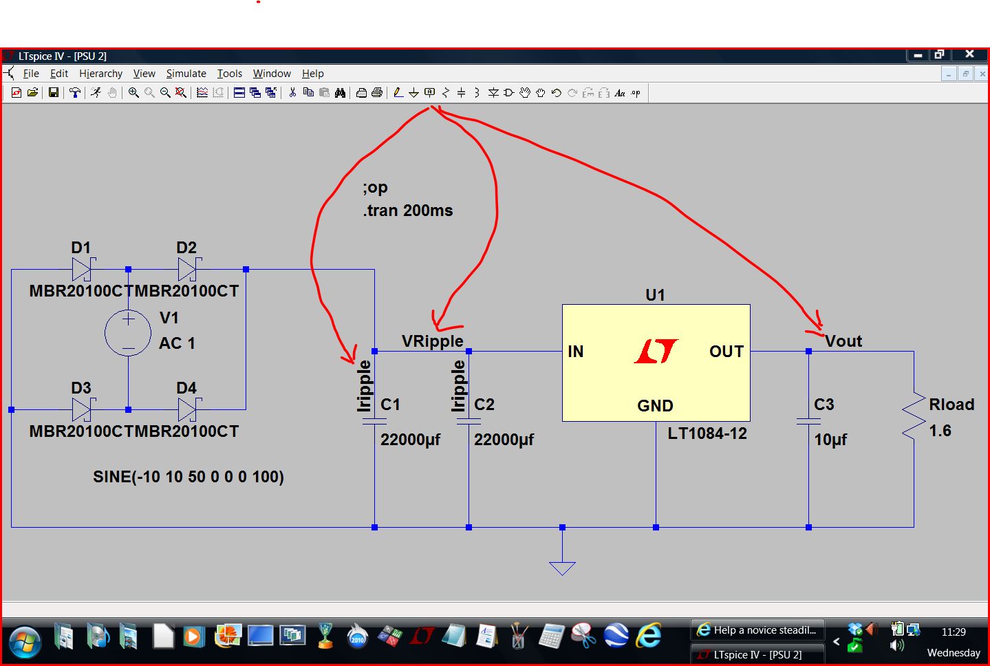

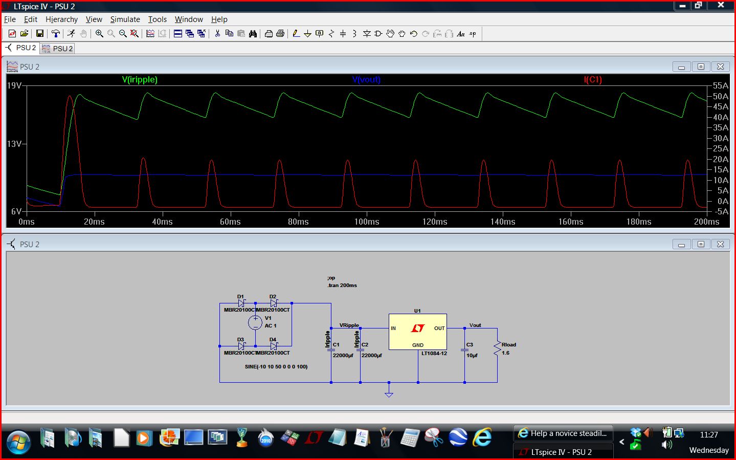

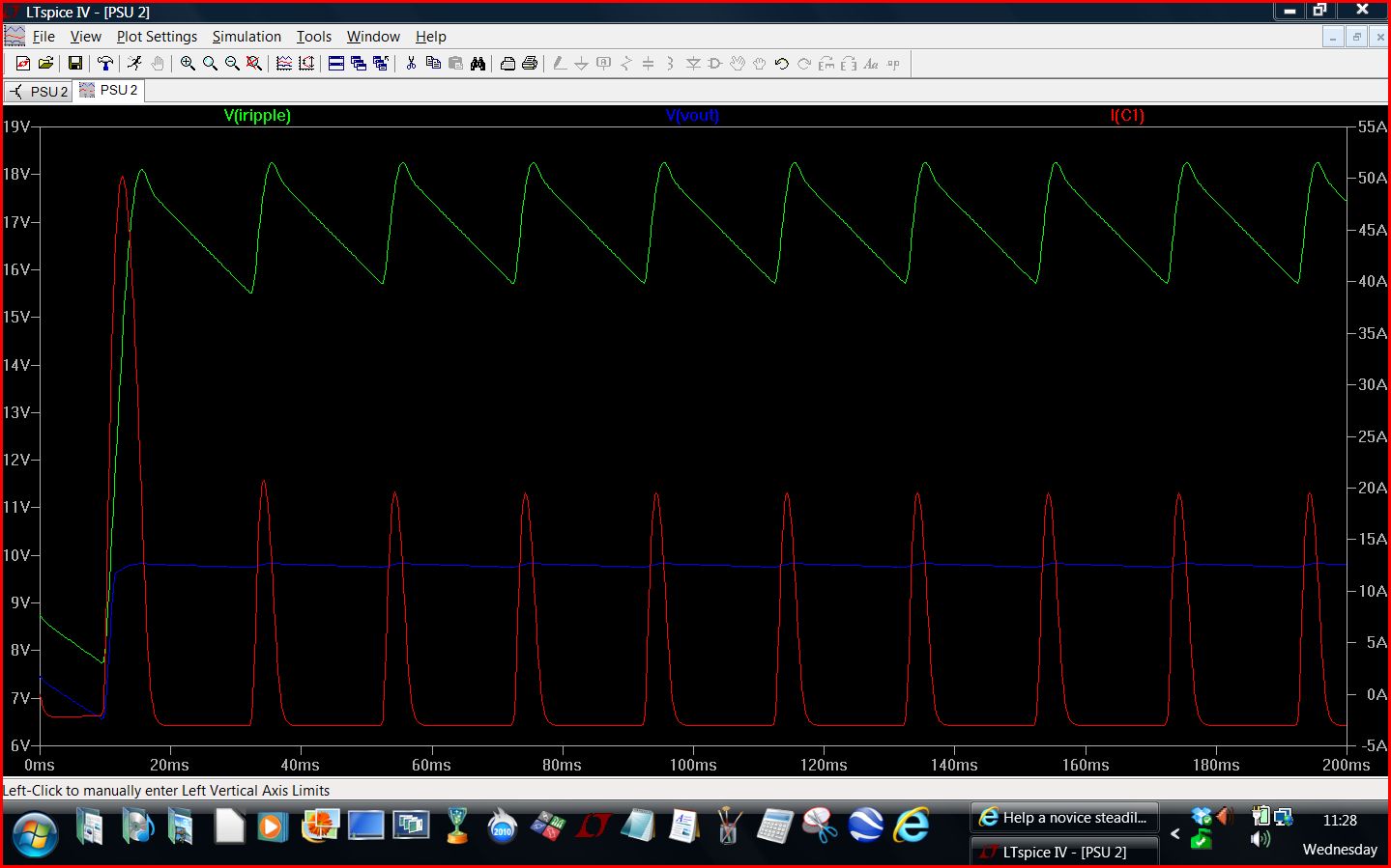

Here we go. With simulation you have to be creative sometimes. This was my best guess for setting it up. I've put the E.S.R. of the main caps at 0.04ohm. The output cap should probably not be to large. When I ran the sim the reg didn't seem to support 1.1 ohms so you can try different values for Rload.
Modeling a transformer... I'll be honest I haven't a clue there.

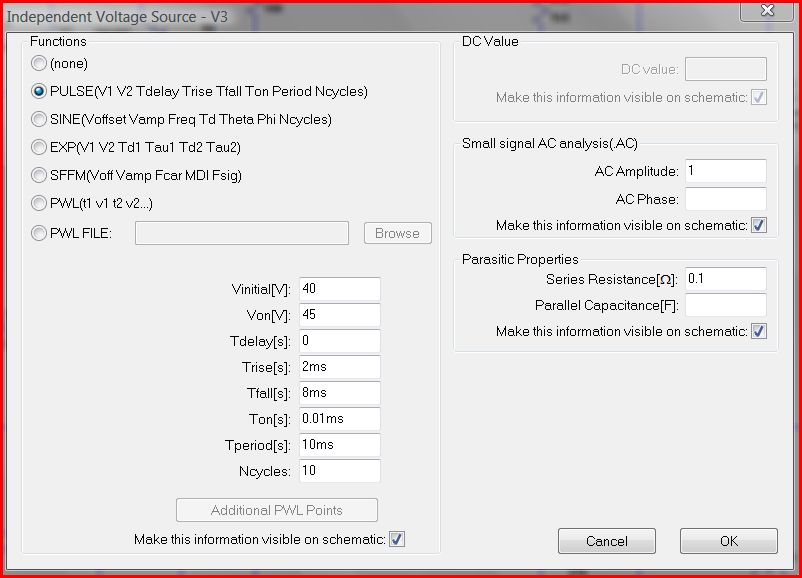

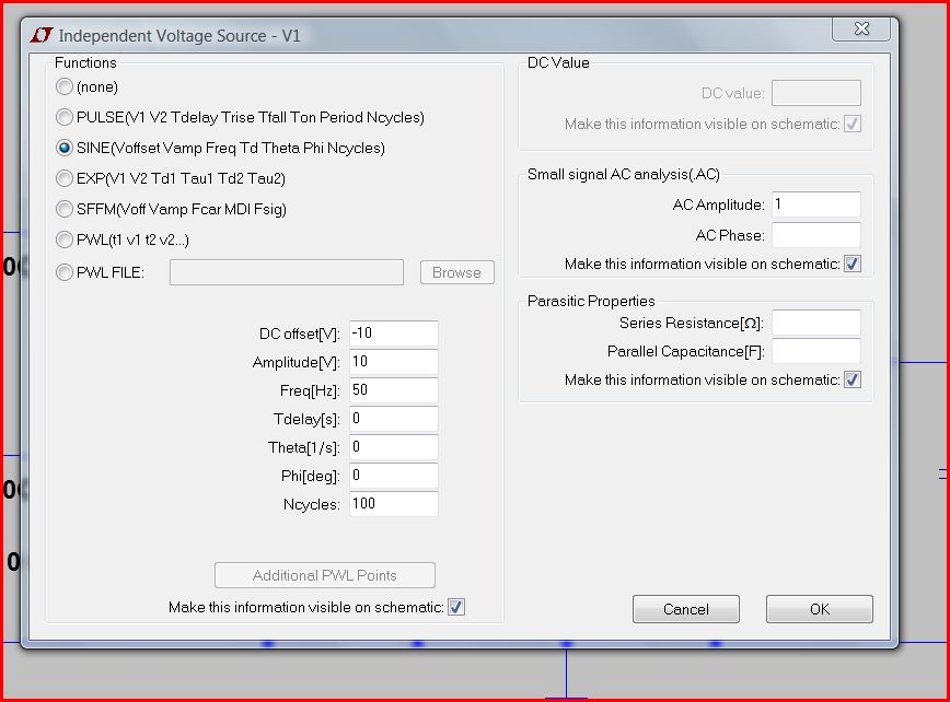

I mentioned being creative. A dynamic load is revealing. Use a power MOSFET across the output with a suitable load in series (Rload) and drive the FET from another voltage source on the gate (such as a pulsed 100Hz or pulsed 10kHz etc). You can model a DC rail with ripple easily to, you don't need the bridge and caps to do that. See the picture of settings for a 45 volt rail with ripple.
