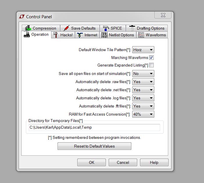

As you have the program installed here is a simple PSU (a voltage doubler) that will get you a started on running and probing circuits. Just unzip the file and put it in docs and either click the file (if a MAC will allow) or open Spice and click file and "open" and browse for it. Click the running man at the top to run it and use the cursor to probe the circuit.
Not sure how it works on a MAC, but if its like Windows then by default the files are stored in amongst the program files. I would advise you to save any simulation files you create in a normal folder like docs etc.
Also, click the "hammer" symbol on the top line and set the following options to automatically delete files (.raw and other files) everytime you close the program.
If you have run a simulation already then search your PC for .raw files and delete them. They can grow to be huge.
