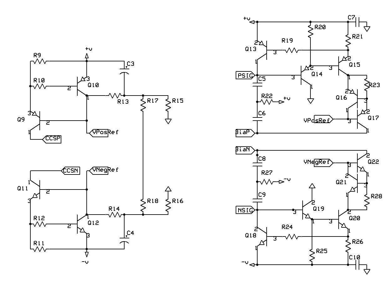

The basic flaw in this design has been unrelentlessly pointed,
as it lies on the insufficent voltage drop in the current mirrors
to reach the threshold of the darlington vas, that is, 1.2V plus
the voltage drop at the vas voltage gain stage emitter resistor,
thus, the standing current is undefinied although negative feedback
will allow to rapidly get out of this non linear zone, but at the expense
of stability and performances.
Since you didnt adress this fundamental issue, you embarked
on complexe means to corner the problem by the outside ,
while it can be only resolved by getting rid of the obstacle..
Here a schematic wich is based on this exact topology,
hope it will help..
I havent built it, but the sims show that standing
current is defined and easyly adjustable by setting
the relevant components , while overall behaviour
show no components dependance for the global functionning.

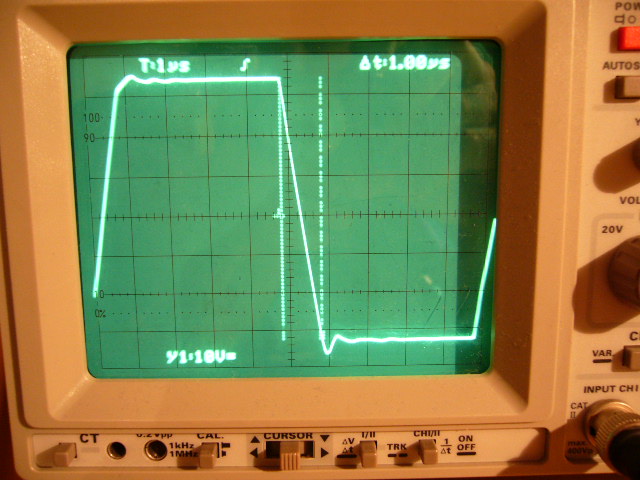

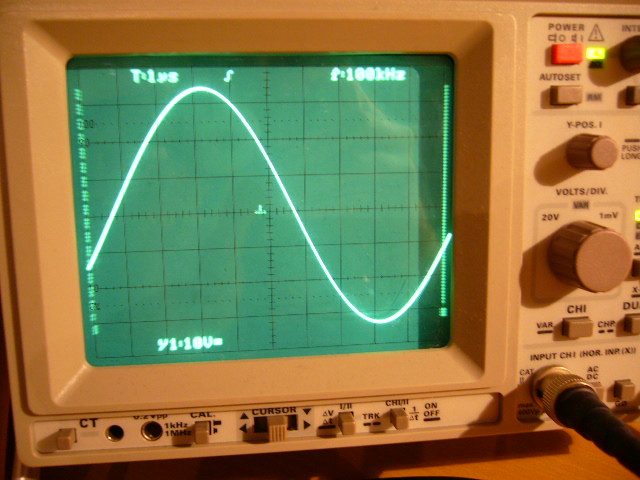

I now tested with 47pF miller caps and i must say it looks nice. See pics in annexe.
What I still don't like is the seeming spike on the squarewave. I want my signal to go UP and then bend nicely to horizontal w/o spike, dips, ringing, blubber and other artifacts ...
It never shows RF all the way to 10MHZ
LF roll-off (-3dB) : 1 HZ
HF roll-off (-3dB) : 550 KHZ (there seems to be some some -3V dc offset here ? This is not the case on lower freq, it starts when amp starts rolls off at HF)
SLEWRATE : 65V/us
Wahab, I know this circuit in its basics is doomed but I think it is a promising one if we can get rid of her main flaw. I will check your circuit right away and let you know ...
Greetz
Olivier
SLEWRATE : 65V/us
Greetz
Olivier
SLEWRATE : 65V/us
Greetz
Olivier
Wahab,
I checked your circuit. If i am correct the diodes in the IS serve to bring down the output voltage of the IS far enough in order to set the current in the vas depending on this oitput voltage. This is perfectly predictable... as iit should be ... but does the circuit still get the benefits from the current mirrors? I once read someone degenrating the mirror Q's so much that the emitter voltage is significantly lower then the rail voltage (usualy just a few hundred mV but they dropped say 2V) ... it worked stable but the benefit of the current mirror was gone... don't know if this is the case here?
But something else :
I notice that the darlington VAS Q's have their collector not direct to ground as I have ... but they pass a resistor (cannot read value) which is in turn shunted by a 100pico cap... HF stability adressing? RF adressing or something else?
Thnx
Olivier
Hi, Olivier
You got it right , the diodes allow a voltage shift of the IPS output
dc level, while letting the current mirrors work as they are supposed to.
This doesn t change at all the dynamic behaviour of the CMs contrary
to a degeneration in the said CMs emmitters.
A byproduct of this is that with rising temperature, the diodes gap
voltage decrease lightly , but this has no consequence as since there s
two junctions drived by this voltage , two diodes will compensate
for the VAS and its buffer , letting only one remaining diode that is not
compensated, though this will allow a very slight deacrease of the vas
current with temp. increase , a perhaps beneficial purpose for the global
temp stability, but i didn t check yet this aspect.
Whatever, as the vas are now both conducting with stabilised currents,
the feedback loop can act properly without transiting in non linear domain.
To reduce the vas buffer thermal dissipation, i did add a resistor
in serie with its collector , which has the undesirable byproduct of
making the ac voltage appear in the said collector , which is annoying
at high frequencies thanks to this device Cob.
So the caps short the collector to ground at high frequencies.
cheers,
w

Wahab,
I wonder how your circuit with the diodes in the IS leg compares to the one I am building for the moment? Yours seems simpler but what about the rest? I guess it's hard to tell. Anyways I will write out all my findings on this one ...
Anyway, on the DC side it is very very steady. Clipping behavior is very nice too. While powering down the amp you see the signal smoothly clipping down to zero w/o crazyness. Same thing when it's powered up, signal grows until it is full swing and out of clipping.
I just can't tell why I am stuck with overshoot in my squarewave ? I need to find out...
Is it normal for instance that a sine wave starts to look quite like a sawtooth wave (more sawtooth than sine) when the freq is around 250KHZ? I mean ... is this :
a) Off course it is ... no amp could do better (at 100Vpp )
b) It is quite normal , don't worry , the amp is more than very good
c) mmm it is normal but it could be better

At first glance it does not change too much. Since it is flyby wire it is touchy when some wires get close to one another ... however it works and that what counts.
I reinserted the input cap of 2200pF because I wonder if my amp is not picking up just rubbish in the air or maybe my function generator is not good enough at square waves...
But did you check the NO SIGNAL trace on the scope (see pictures previous posts) I always have some 20-30mV rubbish when no input is connected or the generator is OFF. Is this acceptable? Outrageous? What's more of a problem is I think the freq. If it were just very very HF noise unable to trigger on my 40mhz scope i would say the amp is going to ignore it because it can't amplify those freq. But I have quite some period wave (not realy sine) ... If i measure between what seems to be a period it comes down to 500-600 KHZ ... well in the bandwidth of the amp ... Is that the ringing I see?
What I see on the 100KHZ square wave now is not really an overshoot but when the signal reaches nearly to the top there seems a higher freq component added to it...it bends to horizontal still with the higher freq on top of it which goes away when reaching 1/3 of the square (top) idem on the lower side...
Without signal I also probed on the pcb at many points with the scope set to AC and scaled to 50mV... well the noise i told about is not only at the output but it is rather on every node. GND, SIG GND, RAILS, between components, just everywhere. There is no point on the PCB that does not reflect this signal except for non connected items like island ...
On the input side that signal is about 60% of the value of that on the output. Don't know if this is relevant?
