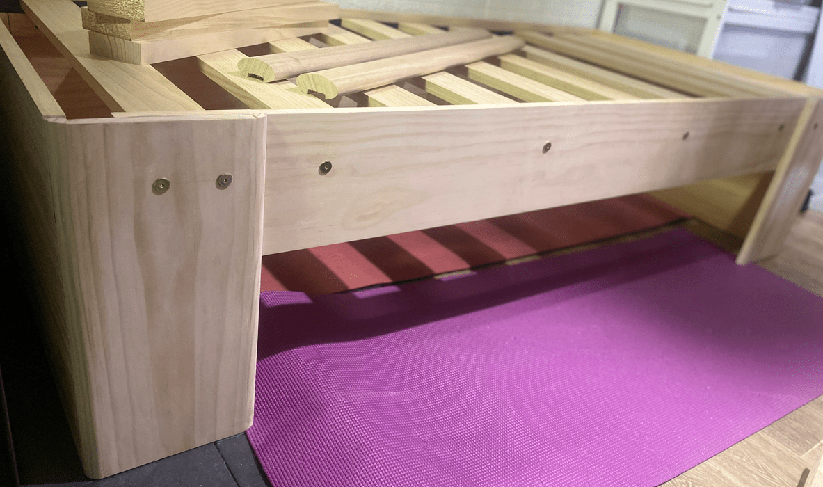

Completed assembly yesterday and in use since. No pics yet, the frame is a bit too high and needs modding. The suspension fits well, and the whole frame is super stable. Will work on the hand/toe rails tomorrow too, much needed. Still haven't decided to finish. I should have stuck with my original pre finished ply boards 🙂
The price of pine is always attractive, but it's one of the more difficult timbers to get a good-looking finish. I will use a brown upholstery fabric that was on my bass amp project for the mattress and back rest. A darker ebony or very light lime could work on the pine, but poly definitely looks bad. I also have a lot of real birch slice veneer sitting around. Covering the lot is also a possibility. No rush on this, us poor parents are now off the floor! 😀
Cut it down to 450 frame height today. Also cut the hand/toe rail parts which are sitting on the slats in the pic
Decided on a resin based ebony finish and picked up the materials today. Now for some filling and a lot of sanding. We are using it now with a regular single size mattress but will soon order some memory foam and stitch up a proper upholstered seat

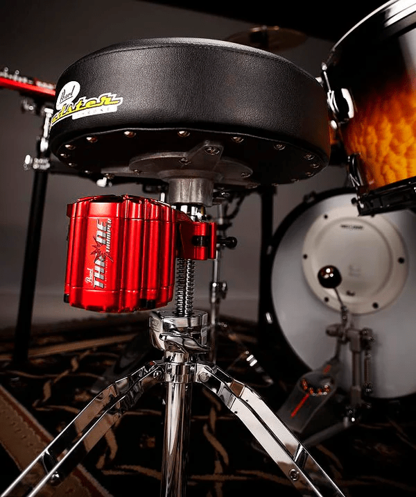

Because drummers are deaf?View attachment 1289683
the Pearl throne thumper is the go to in the drumming world...only difference with the buttkicker is the mount clamp and plate.

"throne thumpers" came about with the advent of "in ear" monitoring as a means of restoring the physical sensations that used to be provided by a "drum fill"
"thumpers" being virtually silent allowed for less low frequency clutter on stage which goes a long way in cleaning up the mix from a multitude of sources.
