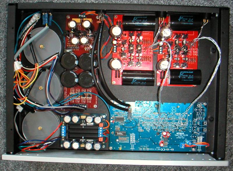

Hi AR,
I have a M-audio Superdac, which has the same DAC-chip as you have. I did a lot of mods on it, and one of the succesfull ones was changing the output to a Lundahl 1527XL. Although it sounded great, the music was a bit mellow. I used the Kari boards as a new output stage. No low-pass or high-pass, just two resistors to get the signal down in the optimal range.
Also sounds great! I had some more trouble getting the boards together. I used Elma Silmic II capacitors, which are too large. I had to drill new holes, and mount the capacitors on wood to get above the other parts :happy2:
Greetings, Harry

harryeng said:
Hi AR,
Greetings, Harry
Great - looks good. Yes, you do not need any filtering since Lundahls takes care of it, as well as they stop DC. I use Solen caps on the boards and they fitted well. It will be interesting to have someone run cap competition in order to find out what are the best ones.
