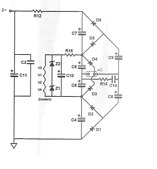

I think it would. But indeed, I have no idea how relevant it is; the phenomenon as such should be real as it depends on non-negotiable physics.Jan, irrespective of real or imagined, is this scenario something a slow start circuit would mitigate?
Thanks.
Jan
And for the sake of a transistor, resistor and cap - I'm happy to follow the TI LM317 datasheet for 'soft-start' over 4 secs or so.I think it would. But indeed, I have no idea how relevant it is; the phenomenon as such should be real as it depends on non-negotiable physics.
Jan

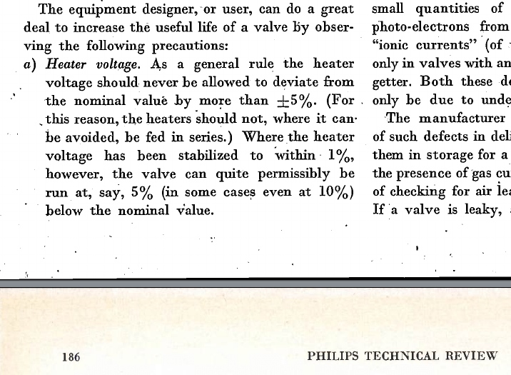

It's already here on this thread, in the screenshot of the E180F data sheet. Post 47.Where does any data sheet say this?
"The average heater voltage should be 6.3V"
Please read the rest of the Philips E180F data sheet to see the context of the 10000 hour lifetime and end-of-life criteria, of which the heater voltage forms part.
