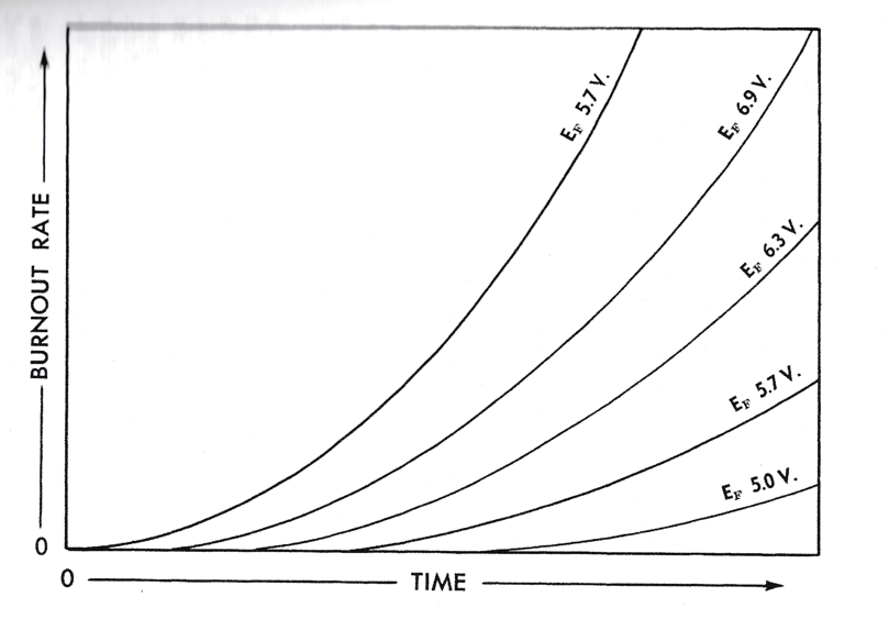

This is also from a Philips source.
Yet, I don't see a catastophe when running at 6.42 instead of 6.3, which is 2% high ...
Note the top curve is mislabelled, should be 7.5, NOT 5.7.
Note2: the lower values may extend tube life but may lower performance.
This is from an article on tube life I wrote for AudioXpress a few years ago:

Neither axis of the graph has a scale, so we can't tell whether it's a catastrophe or not.I don't see a catastophe when running at 6.42 instead of 6.3, which is 2% high ..
But it is in general agreement that above-nominal voltage reduces lifetime - which is the important point.

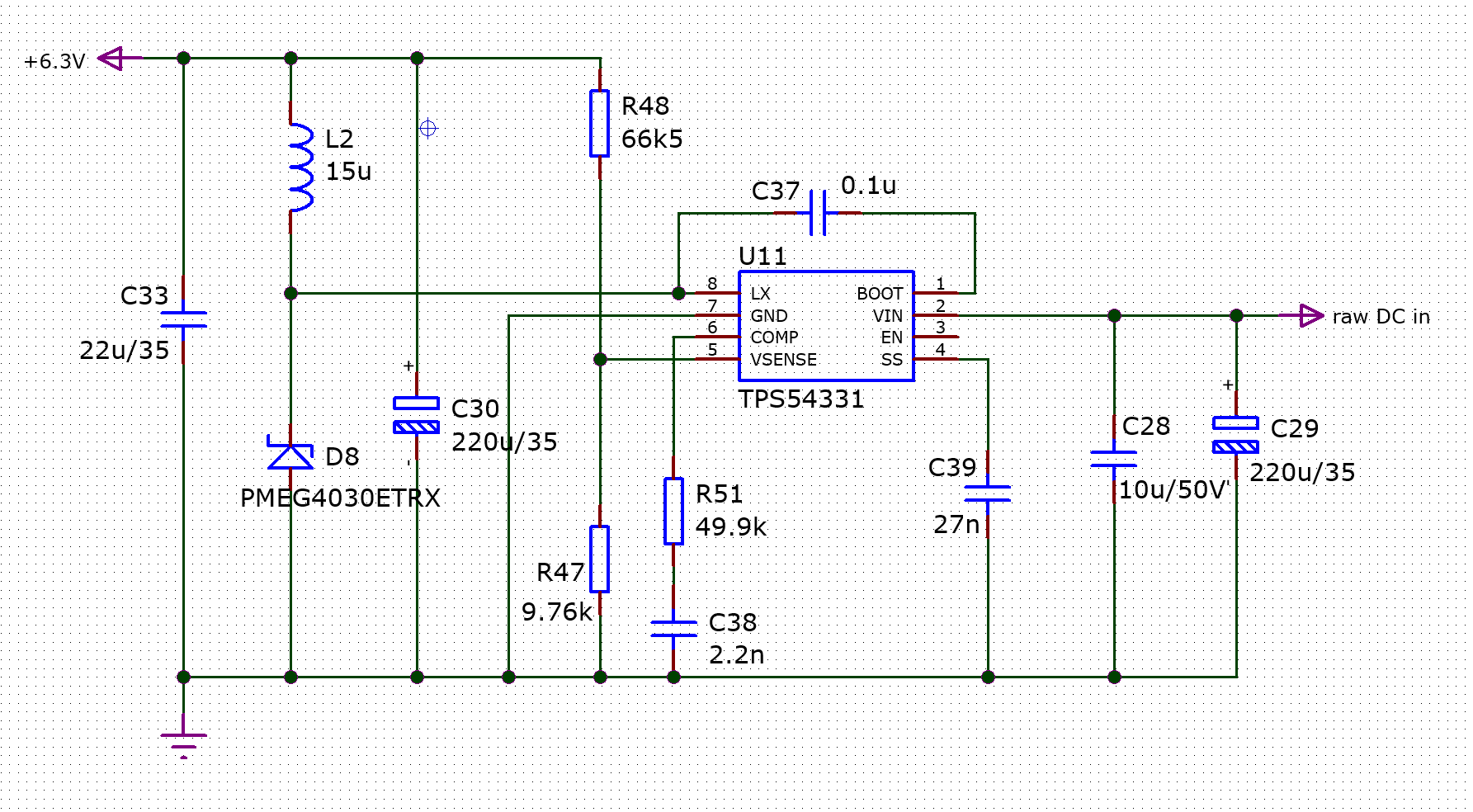

BTW Tomer lists heater regulation as one of the most effective means to prolong tube life, especially with continuously rising line voltages.
I've been building some stuff with heater supply by switching regulators. Very effective and very efficient, using the TPS5402 and TPS54331 parts.
Just rectify the 6.3V and feed it into the switcher. No audio degradation I could detect.
You can fit the whole regulator inside the tube socket area on a PCB.

🙂 I take the switchers run exactly the nominal voltage don't they? They also regulate which is a big bonus.
As mentioned voltage regulation was a rare thing in the fifties (hence the tolerances) but today it isn't. Steady DC regardless of mains voltage variations, slow startup, all possible with a handful of parts. If you like to fight/solve EMI issues in a fully analog device and if you like repairs once in a while SMPS are good too. At least they keep you busy.

A lot of what Tomer put in his book was 'folk wisdom' rather than proven info. That graph is kinda kookie and appears to have been sketched from his imagination. Heater 'burnout' is one of the least relevant things for overall lifetime, assuming you're within the usual 10% voltage spec.
One of the points of that Philips QC guy I quoted was that a too high heater current causes a too high cathode temperature.
This accelerates the evaporation of all those oxides and whatnot on the cathode, bariumcarbonate etc.
If the cathode gets too hot, the tube lifespan gets drastically shorter because of cathode exhaustion.
