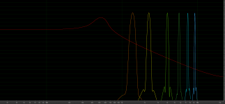

After tracing my steps I can now see that I picked the wrong sweep for REW. REW expects a log sweep, i picked a linear one.
Sweep curve shapes. Top: log, Bottom: linear ... Y=freq, X=time
Another look at the sweeps. Red=0sec, orange=0.5, the rest are 1s apart.
The linear sweep dumps lots of power in the first 1/2 second at 1khz and this does show up in the measurements:
this is the 500hz phase rotation + linear sweep with a small gate. The XO is the source of the sound.
The linear sweep does show a tilt up at higher freq. and a tilt down at lower ones.

I;ve done some simple tests in the past to change the baffle size:
Changing the size changes the decay.
The baffle is very small and changing the surface of the baffle can also change the decay:
2 diff baffle surfaces:
- Headshake's far field 3way
