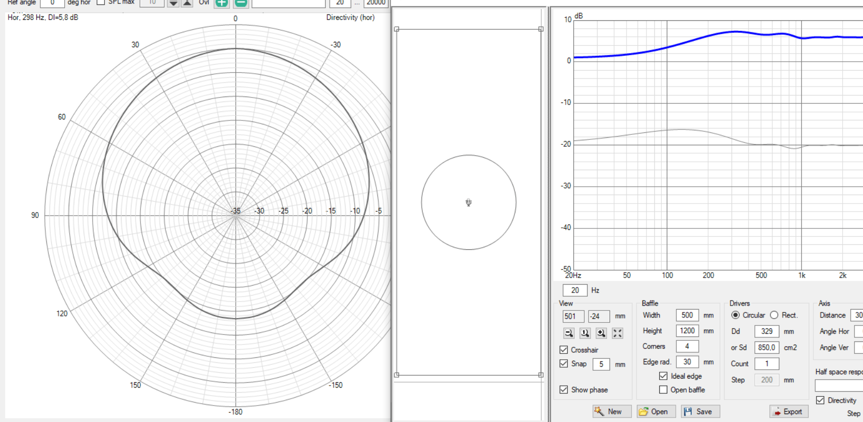

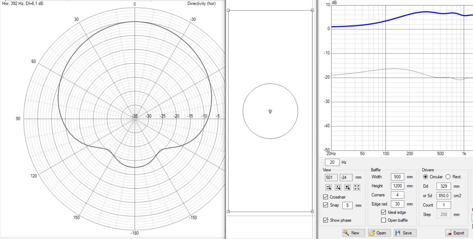

You are absolutely correct it is cardioidish response to low frequency but it seems to be so because its a big object. All I see from the data no matter which way I look pattern is pretty much defined by the size of the baffle.
You've already seen this but for others reading Mabat showed BEM sims with varying box depth in ATH thread and its the same story. Depth, or back of the box, has effect on pattern absolutely correct, but its only ~1db if you eyeball any of the lines they don't deviate any more than about 1-2db. https://www.diyaudio.com/community/...-design-the-easy-way-ath4.338806/post-6972605

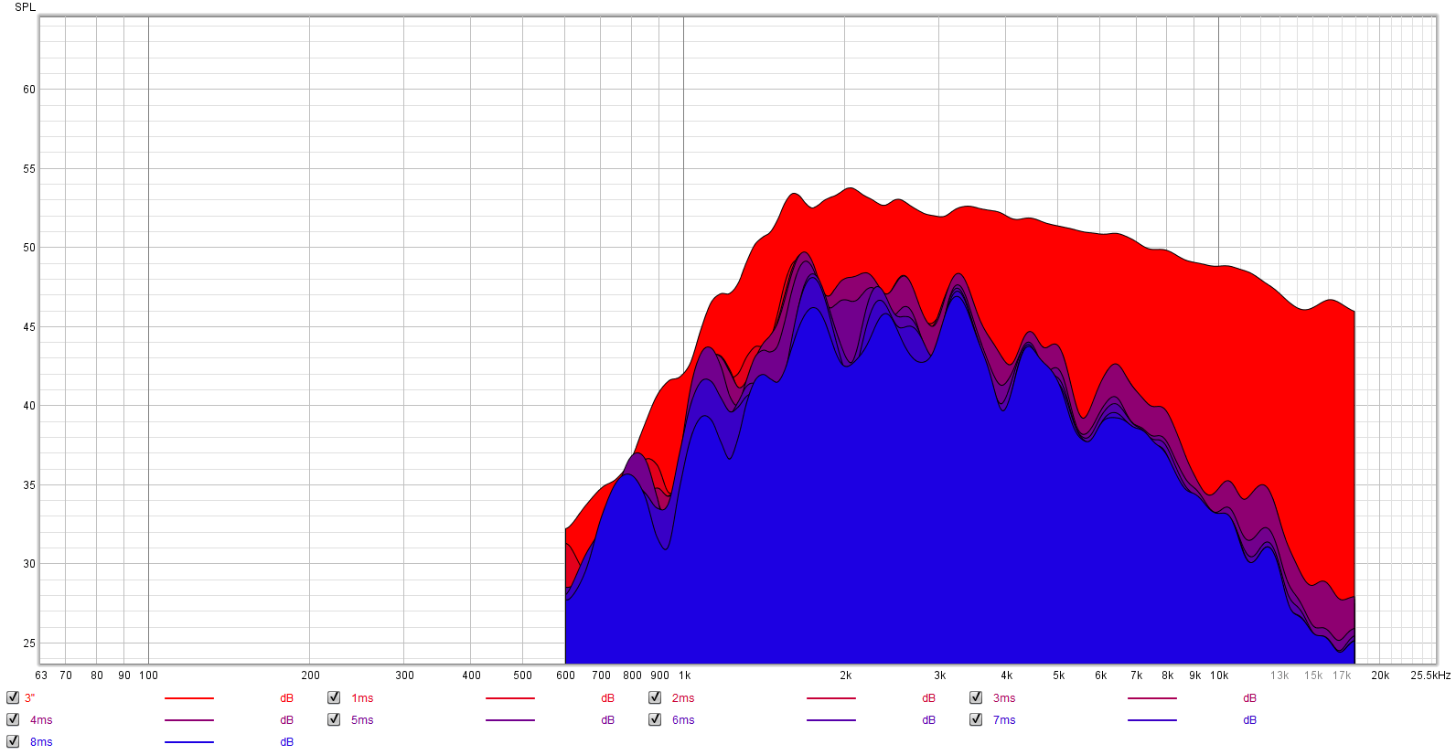

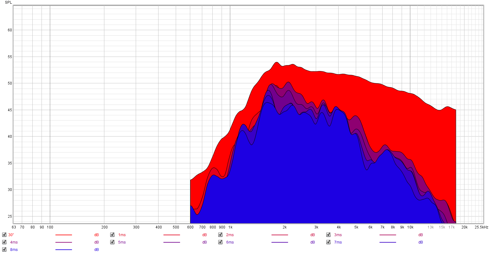

What you guys think about the dealy time of box related secondary sounds like diffraction?
Like room reflections they come like tax bill. Would it be better to have them before say 1ms or more? I've tried to find tips from psychoacoustics but haven't been able to come to a conclusion, not enough understanding and insight yet. Intuition says when the delays are not much different than the direct sound its not any worse, I mean if the edges are about max driver radius away then its roughly the same as if they were emitted by the driver. Yeah driver sizes vary but so does bandwidth they emit so edge diffraction is even back of the box can be kept quite low, about diameter wavelength. Perhaps there is some hints on head size, HRTF stuff? Well, of to other things now.

Hi Tmuikku,What you guys think about the dealy time of box related secondary sounds like diffraction?

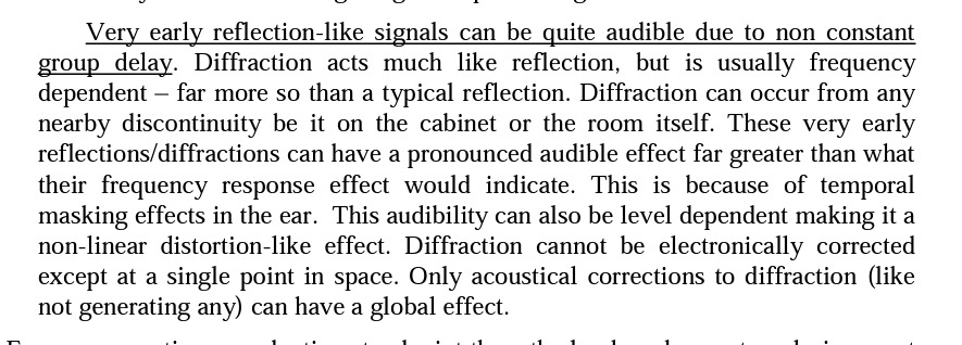

I had read this in Earl Geddes's white paper on loudspeaker design philosophy
Full paper here (in case you haven't read this earlier): http://www.gedlee.com/Papers/Philosophy.pdf
Thanks vineethkumar01!
This information doesn't give any numbers so not too specific but good as guideline.
I interpreted this with current knowledge so that we need to minimize diffraction related secondary sound source in amplitude. It could also be interpreted that if the secondary sound source resembles more direct sound then it might not be so audible, which is interesting. Any other interpretations how to reduce audibility of diffraction?
Widening diffraction bandwidth could be done with big baffle and small transducer(s). The smaller the baffle (keeping the transducer(s) same) the narrower the secondary sound source bandwidth. If front of the box is small and sides big, this could also extend the diffraction secondary sound source bandwidth as what didn't make secondary sound source on the front could do it on the back. So roughly the bigger the box the lower in frequency it makes secondary sound sources with diffraction. Minimizing the amplitude feels better option though, but I do not know what extent it needs to be attenuated to become inaudible enough.

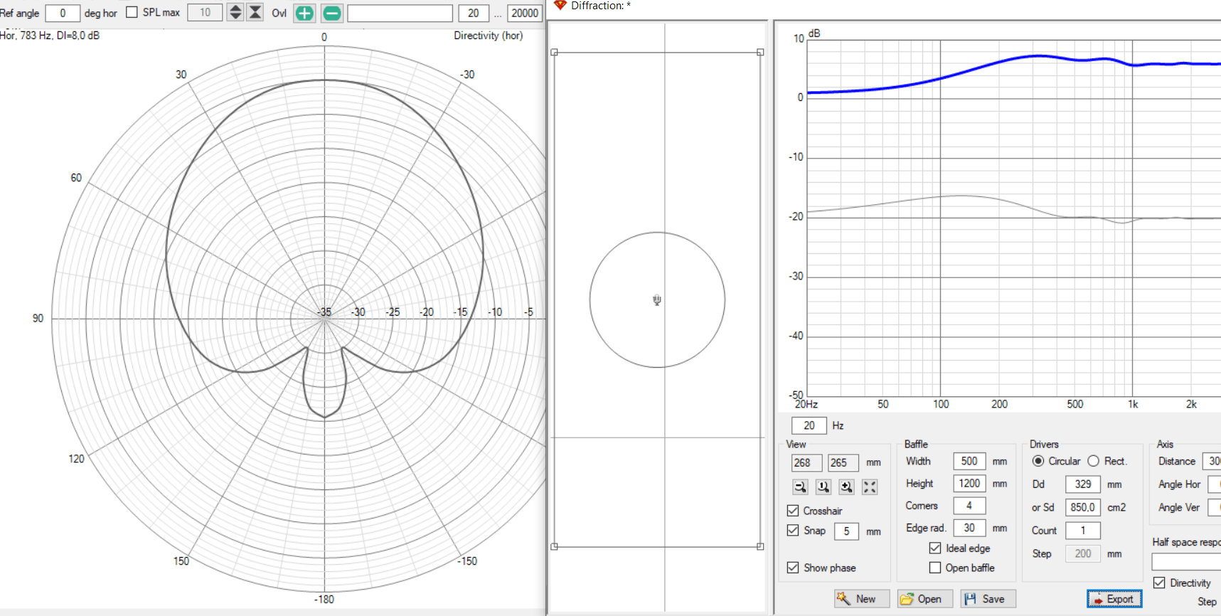

Have you seen what small differences in geometry can do in Mabat's ATH thread? Now think of a baffle as just another waveguide. It's shape and size does matter.
It can be shaped so diffraction is smeared out over a large area (think of the sphere) and that shows how the sound wraps around the sphere leaving a smooth transition from the sound wrapping around the baffle to where the sound waves are smaller than the baffle dimension.
Could you see a waveguide shape in that? Bend backwards? On the other end we have the direct radiator, with it's specific pattern. Mostly related to it's size, but not completely. Even cone shape can still make a difference, though usually it's small. Some speaker manufacturers go pretty far to diminish the size (and shape) of the surround, as even that leaves a trace in the frequency curve. When you combine the two, the baffle and the driver, you get a unique combination. You can make it work with each other to create more pattern control. Think again of the many examples in Mabat's thread, of how and where the details mattered to create the smoothest results.

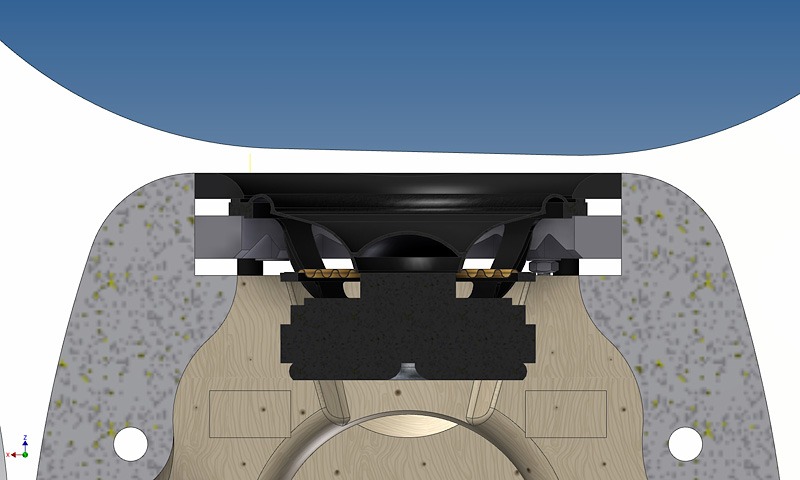

Ah.. I see fluid posted my enclosure shape as an example. Would you believe I spend days with a tool like the Hornresp Wavefront simulator to come up with my specific shape? I already had found some inspiration of a back mounted driver of the same type, but wanted to continue that shape. The wavefront simulator was my tool of choice to see if the shape I had envisioned could work. Basically I still think of it as a horn folded backwards. In such a way that it has a very smooth mouth.
See how it transitions from the cone outwards? The surround it there to stay, so I had to smoothly pick up the shape from there on.

Did you expect that back mounting of the driver have this much of an effect?I see it is due to the front panel is changed, this has the biggest impact on the acoustic response and is the most significant thing in this topic.
No I did not expect and this is the exact message of my posts. Which is that shape of back of the box does not make meaningfull difference in speaker output pattern. Fluid disagreed and debate started, for nothing I see, was a communication problem.
This is clear as day to me what you and fluid show on the latest messages, front of the box, immediate surround of transducer makes it or breaks it. Back of the box makes just minor ripple on top on all graphs I've seen so far. After control of sound is lost past the baffle / waveguide there is nothing we can do to the response other than smoothen ripple out. There seems no possibility to significantly change pattern with shape of back of the box. Only what is on the front, around the transducer including edge if there is one, defines the polar response for that transducer. What is beyond first edge gets so little sound it has only minor effect to anyhing in comparison.
Fluid showed this and you showed it, we all see it, and there should not be disagreement left other than how significant the resulting ripple from back of the box is and if its worth it to care much about, and thats fine.

Geddes quote reads to me that like room reflections there are reflections from box, and what makes them more disturbing is the group delay peaks, sound of these is very different than what room reflections are. Hence, it could be so that make the diffraction like room reflection whats the difference? Alright, they are opposite phase, which might be the group delay portion of the message.
Reducing amplitude of secondary sound source is what I do, and is the first interpretation. Rounding of edges, waveguides all do this, reduce amplitude of diffraction created secondary sound source at the edge. This is directly observed from system frequency response, the less (in magnitude) interference ripple secondary sound source makes with direct sound, the less is the amplitude of the secondary sound source.

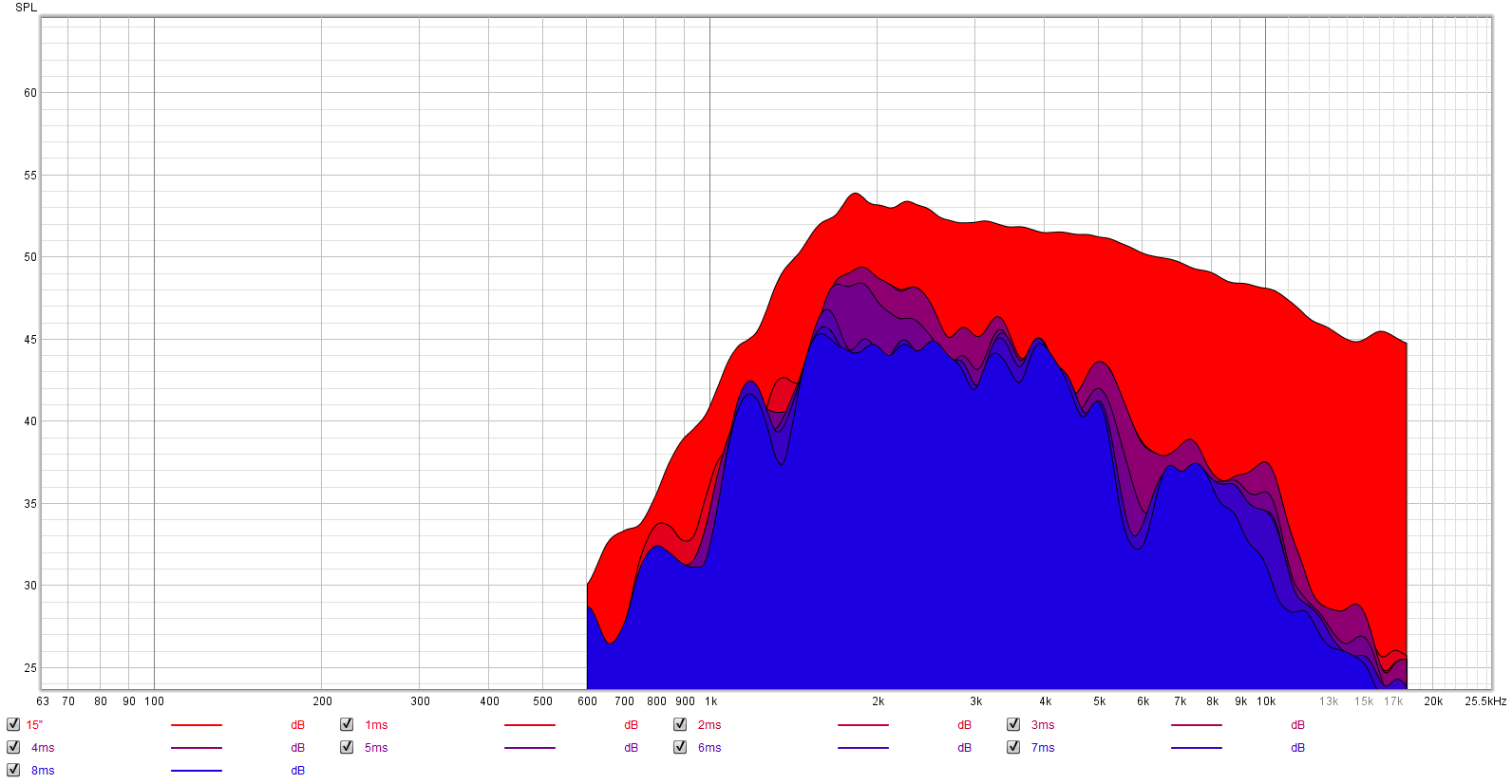

This "minor ripple" is so obviously different that blind Freddy would struggle not to see it. If you think this is an irrelevant difference then let's agree to disagree, it's not a communication problem.Back of the box makes just minor ripple on top on all graphs I've seen so far. After control of sound is lost past the baffle / waveguide there is nothing we can do to the response other than smoothen ripple out. There seems no possibility to significantly change pattern with shape of back of the box.
Can you show the box(es) that the results are for?
I see the other graph is with bigger baffle than the other.
If both have exact same baffle and different back of the box size/shape is responsible, then this is new evidence. Otherwise it is exactly what I've been trying to say.
