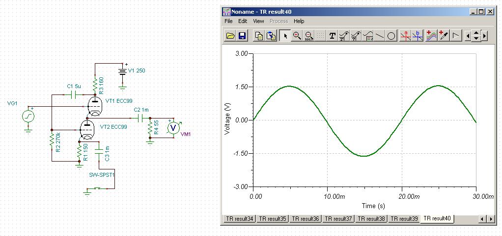

ECC99 putting out 1 watt into 1k ohms @ 0.6% THD. (signal shown is the output across the 1k resistor) Plate resistor is optimized via FFT. Notice that the plate resistor for this one is different than the one for the 6SN7, so it's not just a function of the load but of the AC and DC current in the tubes as well (the ECC99's are running at some 18mA whereas the 6SN7's were running at about 11mA). The formula provided by Mr. Broskie is incorrect. Also, see the Headwize article:

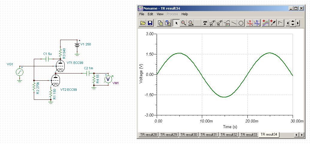

ECC99 driving 55 ohms @ 24.5 mW @ 50 Hz @ 0.34% THD. (signal shown is the output across 55 ohms) That's about the limit , also, which is 3 Vp-p input. Optimum value of plate resistor (lowest THD) remains the same regardless of input voltage. The idea that the grid AC voltages have to be equal for lowest THD does not appear to be correct according to the FFT.
I think it's also fairly obvious that if I bypass the cathode resistor of the lower tube, that the gain for that tube increases and thus a different optimum value of plate resistor for the upper tube is required. 3 Volts p-p input, 0.4% THD @ 50 Hz. I think it's also clear that bypassing the lower tube's cathode increases distortion because it increases the gain of the lower tube and obviates the current feedback provided by the unbypassed resistor.

I think I understand what's happening. You are applying NFB to the lower triode's cathode. Although the signal at the grid is bigger than the upper triode, the actual amplified grid-cathode potential isn't. So when omitting the cathode bypass cap you have to take this into account. The grid-cathode voltage is actually about as big as the upper triode's grid signal. So my advice holds in a way. I used LED biasing, that's why 220 is still the optimum value in my case.

The value of the optimum plate resistor for LED biasing of the lower tube would be different than either of the arrangements I've shown so far. I don't really like LED biasing, but that's my bias after all....
Sure, to each his own. But I think we've established you can't just calculate the optimum resistor by the simple equation given here and there. There's more to it than that.but that's my bias after all....

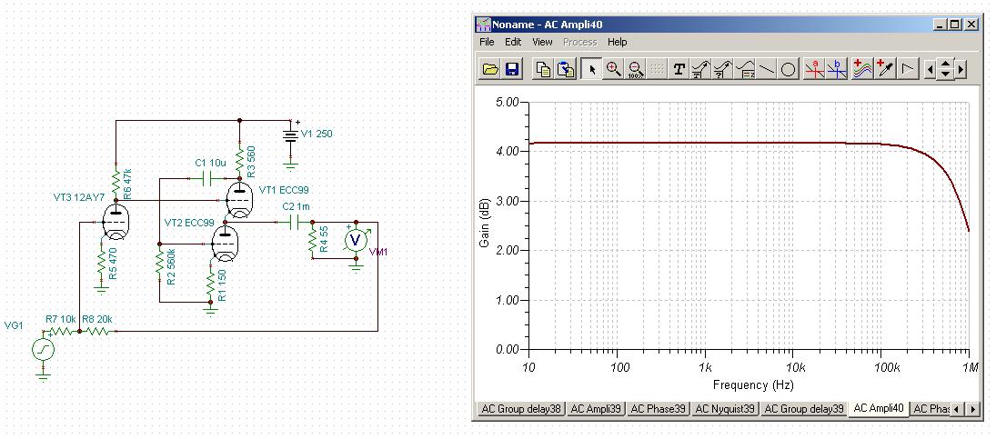

But still, the ECC99 WCF makes an awesome output stage for my headphones. I've measured 0.04% THD with an output impedance of 11 ohms with GNFB. Pretty decent I'd say.

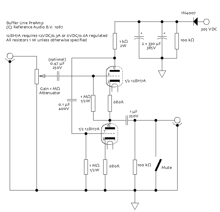

Prior to the ECC99 I used this circuit for all sorts of applications.
Dirk, if you don't mind, could you run it through the sim?
TA, 😉
TA, 😉
Frank, what is the load for that circuit? (what did you connect it to) It's important because it changes the ideal plate resistor value (that one may not be optimum for the load, for example).
Hi Dirk,
The stage sees an input impedance of 100K at the amp's end.
It's actually the buffer stage of a phono preamp I've done many years ago.
Thanks, 😉
Thanks, 😉

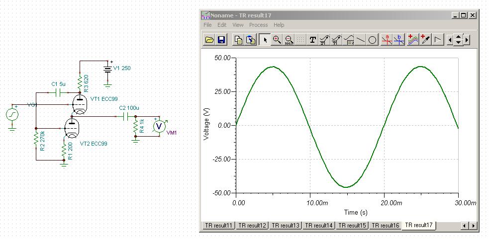

800mVrms into 55 ohms @ 0.02% THD @ 1kHz. You do need a huge coupling capacitor though.
Yes, 470uF works perfect for my intentions. But a 32 ohm Grado might need a little more.
Hi Dirk,
Thanks, 😉
That's a really strange animal. THD @ 1 kHz @ 650 mVrms into the 100k ohm load is 0.001%, whereas if they took the output from the upper tube's cathode the gain would be a little higher and the THD would be 0.0004%. It seems to be a combination of an SRPP and a WF.

I somewhat expected the THD to be lower at the top triode's cathode.

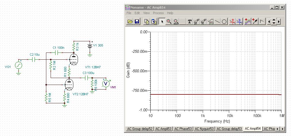

Well, JJ is missing some important data then, like the maximum allowable grid resistor. I assume it's at least 500k or so, but don't know without them telling me. The 12BH7 limit is 1M ohm for self bias, but the ECC99 has higher Gm so maybe a lower grid resistor is called for. Either way, I don't see it in their data sheet.
What's embarrassing is designing and partially buidling a headphone amp for my own headphones where I thought they were 300 ohm but in fact are only 50. But fortunately, saving myself by realizing that I can substitute a JJ ECC99 for the 12BH7 and cut the THD into 50 ohms by about 4 times... so, now I have to buy more tubes!
