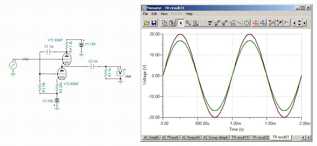

Just for fun, here's what can be done with a 6SN7 White Follower. Twenty volts p-p driving 1k ohm. Visual clipping occurs at over 35 V p-p input, which is about 2.3% THD and works out to 21 V rms into 1 k ohm. (441 mWatts) I think that's pretty dang good!
I have done many sims of White followers.Unfortunately when built and measured they are not nearly as good as the sim suggests.

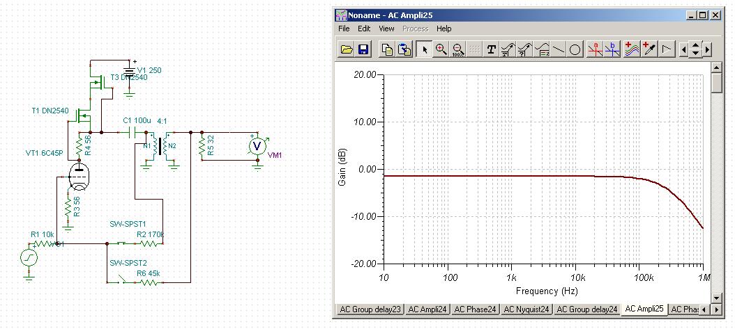

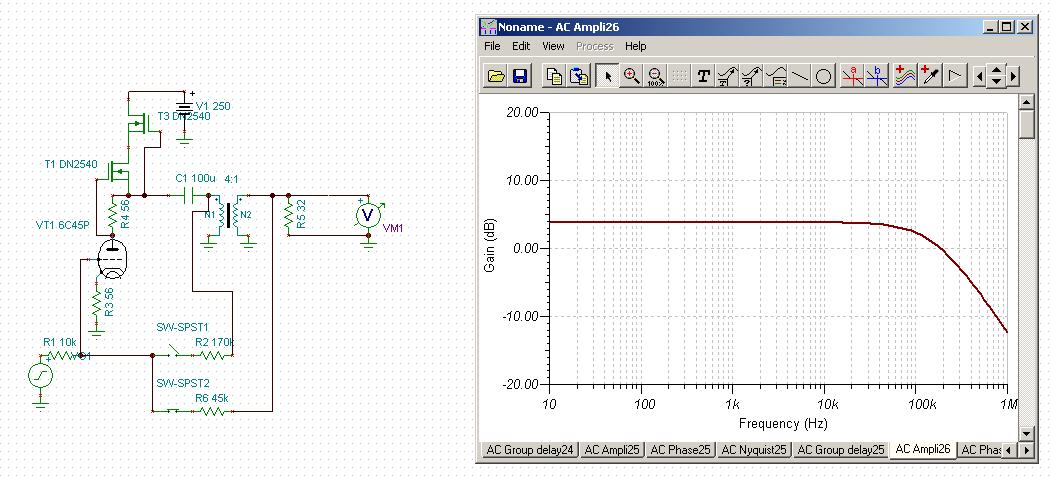

When you take the feedback from the primary side, the voltage gain of the amplifier is much more strongly affected by changes in load than if you take it from the secondary of the transformer.
As you can see from the two circuits the gain goes way down with the feedback taken from the primary side of the transformer. The feedback was set @ 10 dB for each path with a 100k ohm load. Then the load was changed to 32 ohms. This is the result.
If you adjust the resistors in the feedback paths to give equal gain for the circuit when driving 32 ohms, then the distortion is about the same for either path. I guess that makes sense since the gain is the same.

This one?
The 6SN7's are on the edge I believe, running at some 11mA. I have no idea how well this would work in real life, but I was trying to show that when I optimize the plate resistor for the specific load, then it's possible to really drive the White Follower hard, and it's possible for it to put out a lot of power.
