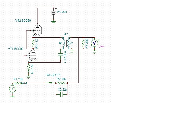

Hi Ian, I'm just curious about your design.
Did you consider using a White Follower instead of the SRPP?
Does the feedback network upset the bias on your input tube?
Did you consider taking feedback from the secondary of the transformer?
Yes I not only considered, I tried the White follower. I could not get more the 125mW out of it. It's problem is that although it has an incredibly low small signal output impedance , its drive capability is limited.
The feedback network is an integral part of the bias of the input tube. The output of the SRPP sits at about 150V so the 47K feedback resistor provides about 3mA current though the 470 cathode resistor thereby accounting for 1.5V of the input tube bias. The remainder is due to the input tube cathode current.
I did consider taking the NFB from the transformer secondary. However, just about all the distortion occurs in the SRPP stage. Taking NFB from the transformer secondary would only make a very minor improvement in distortion and add a whole bunch of stability issues I preferred to avoid.

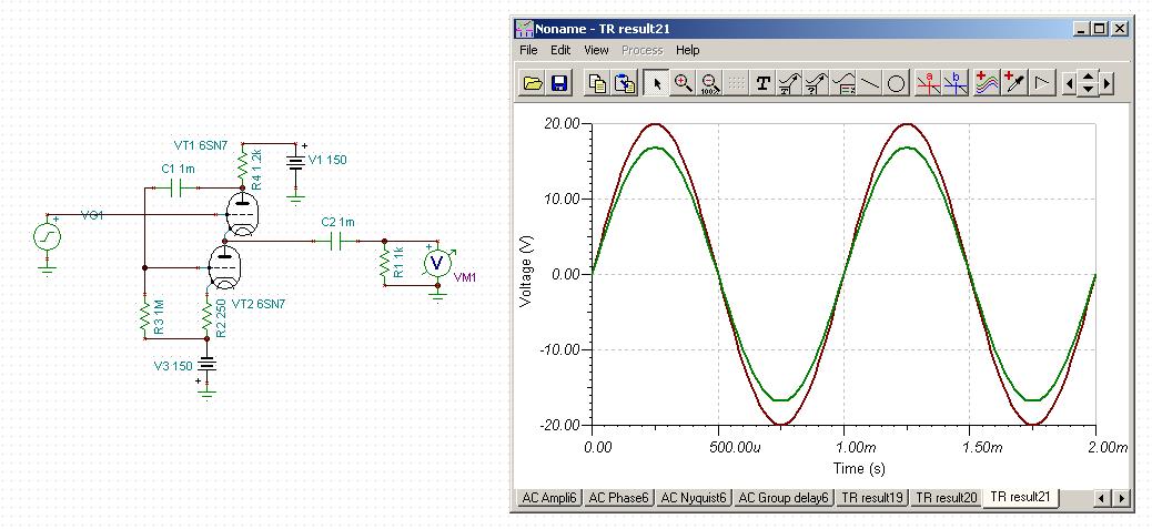

Also, you can substantially lower the output impedance for your amp by taking the feedback from the transformer secondary rather than the primary. It's up to you of course. I would never tell you what to do. I'm doing that with the one I'm building.
Just for fun, here's what can be done with a 6SN7 White Follower. Twenty volts p-p driving 1k ohm. Visual clipping occurs at over 35 V p-p input, which is about 2.3% THD and works out to 21 V rms into 1 k ohm. (441 mWatts) I think that's pretty dang good!
The reasoning behind the use of the WCF stage is often misunderstood.
A WCF is great at swinging huge amounts of volts but can't source much current.
IOW, lowest Zout is a meaningless target (within reason) if it can't properly drive the Zin.

but the very low output impedance might require a rc network in // with the parafeed cap.
Could you briefly explain this? Is the R/C damping some potential ringing?
I'm building a headphone amp w/ the topology you described.
My experience, after playing with WCF/SRPP for a while, is that a µ-follower with a mosfet on top is a better solution for headphones, offering low output impedance while preserving the character of the bottom tube. It offers some other advantages on top (no worries about Vhk, less heater supplies, reduced B+ by about 25%, etc) but the very low output impedance might require a rc network in // with the parafeed cap.
But I'll admit that it is an hybrid solution and that, as such, it might not please everyone and I'll stop at that.
Did you try cascoding the upper Mosfet in the SRPP? It sims very well.
I just put a 1M ohm resistor in parallel with the parafeed cap. It allows a trickle of current through the output transformer (which shouldn't hurt it too much) and it provides some good damping. I also put the parafeed cap on the low side of the transformer primary.

It's rather that you could have a serious bump in the low frequencies.
This website explains it in details (go to part3) and provides an excell spreadsheet. It's also quite easy to sim in spice if you have sufficient data about your transformer.
edit: this to answer post 32.
In my sims these resonant peaks don't show up until way down around 1 Hz or less. So, I don't consider them a serious problem.
You can use this connection to reduce distortion in the bass frequencies. It's kind of like an ultrapath connection for the parafeed capacitor.

It's highly dependant on the setup of course (particularly your transformer). In a prototype setup, I had a peak of 6db at 25hz. But output impedance was near 0 (4ohms), my output cap was much smaller and I was using recycled 100V line transformer with lowish inductance.
Increasing any of these will reduce the problem.

I've just been looking at my sims and was seeing the resonance aboce -f3 as well. I realized it is the LC resonance of the output cap value and transformer inductance. The lower the transformer resistance the worse the peak will be (high Q circuit).
It appears to me that the only option is to push the resosnace frequency well below the desired -f3 point.
So the capacitor value is totally dependant on the inductance of your transformer.
In my case with a 10H transformer I need at least 80uF. This puts the peak below 10Hz
