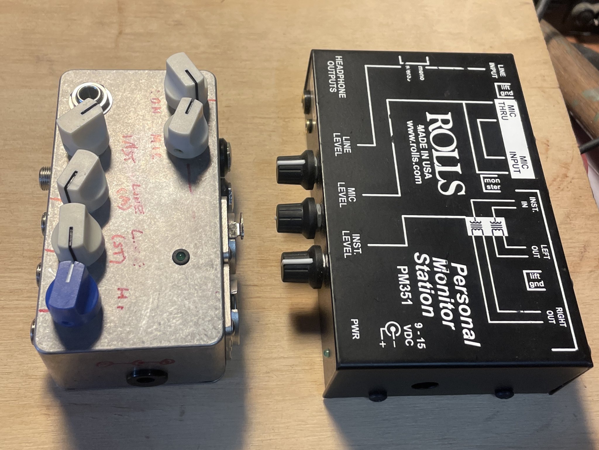

That being said, I'm happy to include output driver structures that include additional heavy duty transistors or LME49600s or whatever if it improves the design appreciably, but I don't think I want to go to split rails. Another of my design goals is keeping this thing small. So far it all fits in a 2.5x4.5 hammond aluminum box, including all connectors and pots. Here's a picture of it compared with a commercial unit that has two less inputs and is much larger. (and most importantly, doesn't fit on my pedalboard, hence my this new design.)

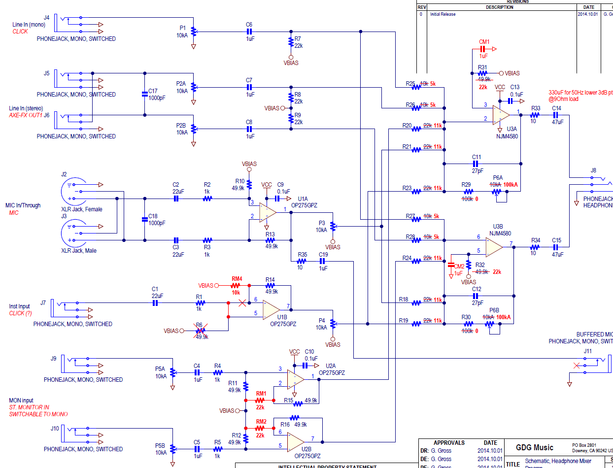

Here's my design as currently implemented, including modifications. (modifications are in red)
So far it generally works well. I have tested with a few different sets of headphones and in-ears. The ones that give me the most trouble are my UE RR set. According to UE, they have about a 35Ohm impedance, but their sensitivity must be a bit low too, as I can't quite get them as loud as my other in-ears or the beyer DT770 cans I have. There's also a bit of fuzz in when I play loud into the UEs that I don't hear in the other headphones.
I'd like to increase the available volume from this unit. Any thoughts on that? Is is just a matter of increasing the gains of each input (have already doubled most of them as you can see.) If so, are there practical limits as to how low I can take the input resistors?
In a future PCB, I might opt to add an intermediate mixing stage and or/gain stage, but on this board I'm not going to do that, as the modifications would be too extensive.

really? at 35 ohms and a P-P output signal at half my supply, I should be able to push almost half a watt, right? which ought to be enough to blast my eardurms off with any set of headphones, I'd imagine, especially in-ears.
P = (V*V)/Z = (4.5*4.5)*0.707/35 = 0.4W
* 0.707 because Vrms vs Vp-p

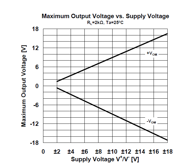

Here's how close the 4580 can get to the rail according to the datasheet. It still seems like I ought be to able to generate something hefty enough with a single 9V supply, but I can't argue with the results. just doesn't quite make sense to me.
Ah, gotcha! Thanks, i'll look for that. probably explains the hair I hear on the signal too 🙃Max output current(100mA)is your limit. OPA1656 has the same limit. Search for 200 a 250mA opamp.
Nice trick. just a follower that adds additional current through the summing resistors. probably a more intense modification than I'd like for this board, but we'll see.
First step is to look for a heftier output opamp

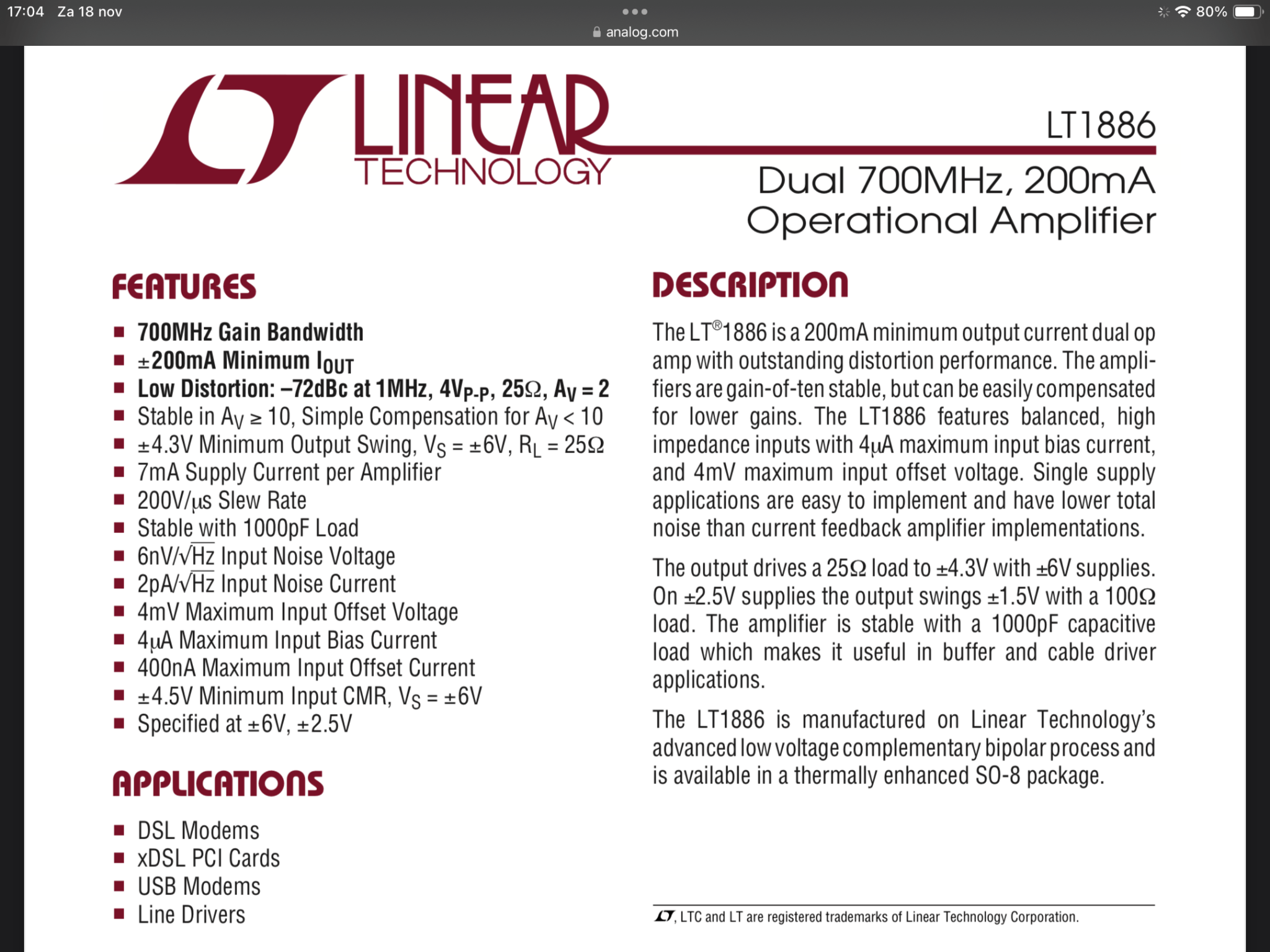

It'll have to be for a different project, or future version of this project though, as it's a to220 package, and I'm limited to SO-8s on this board. 🙃 Also looks like it likes dual supplies, which I haven't quite broken the seal on yet.
Well, I ordered an AD8397 to try out; it's supposed to have ~230mA of AC output current capability according to the datasheet, and gets close to the rails even at high output current, so hopefully this will be an improvement.
