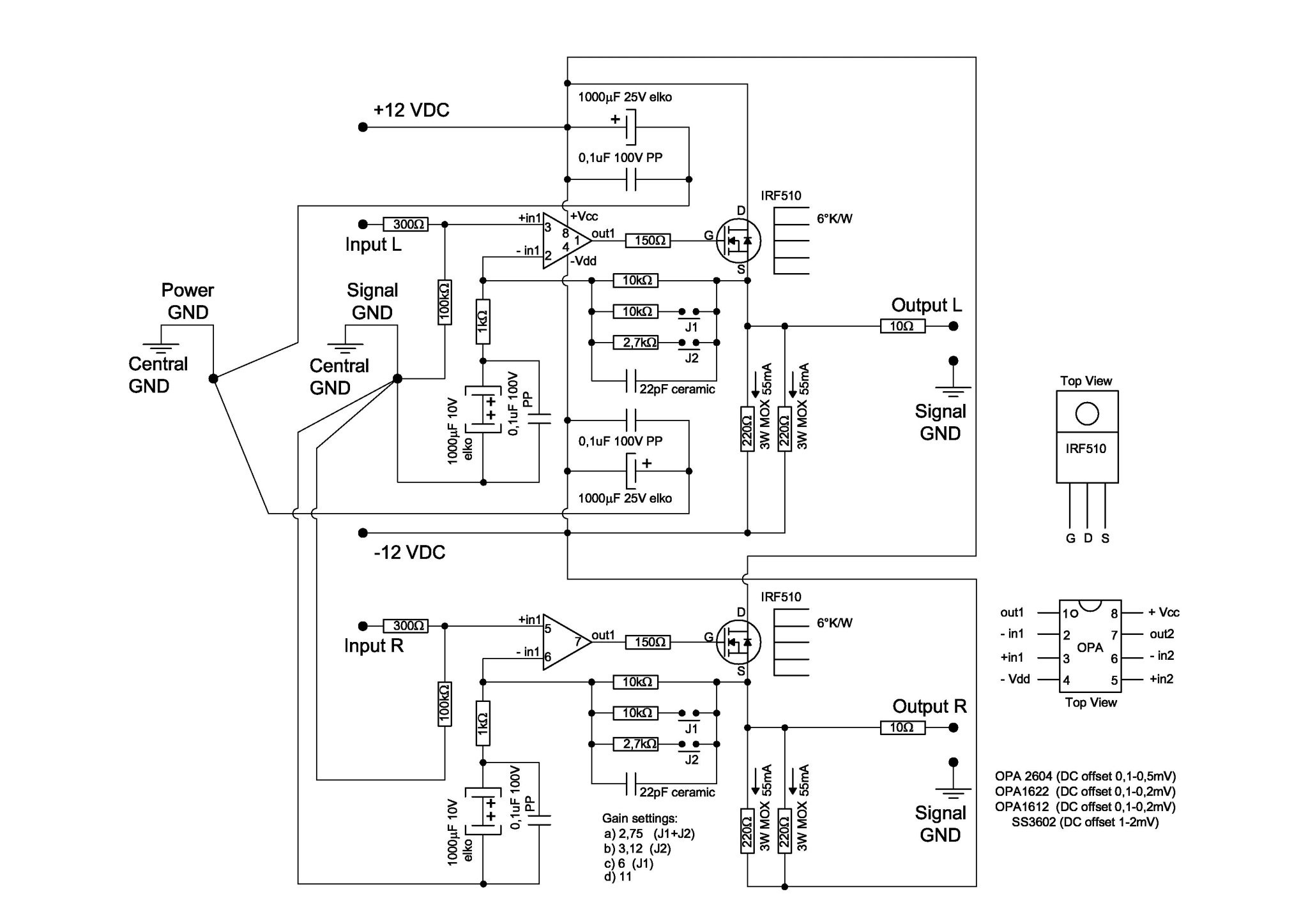

Here is my suggestion for a simple headphone amplifier. I didn't make it, it's still in the plan, but the concept was tested in the Line preamp with lower quiescent current of the mosfet (40mA). The advantage of this is that it sounds better than the OPA itself. In this schematic any OPA will operate in A class up to 78 mA RMS and single ended up to approximately some 2.4 VRMS at the output. There is enough current for 32ohm headphones, and enough voltage for 600ohm headphones. The supply voltage can be higher, up to the OPA limit, +-18V usually. You just have to pay attention to the heating of critical elements (mosfet and source resistors). And some circuit for DC protection of headphones should be added to the output.
What's the point of running so much idle current at +-12V if you leave the 10 ohms output series resistor outside the feedback loop? You might consider such wasted power for driving 28 ohms Hifiman headphones, then the 10 ohms resistor wastes 1/3rd of the output current without any distortion mechanism applied on it as well as the headphones themselves being out of the feedback loop.It may be that such headphones are mostly resistive in nature, but that 10 ohms resistor is gonna be taking 1/3rd of the output energy for nothing.For higher inpedance and higher sensitivity headphones class A is useless already.
Like everything else, I tried it, I liked it. Most headphones are not resistive in nature, just like speakers. The resistor is there as some short-term short-circuit protection for the mosfet. They can also be kicked out. It may be necessary to add Zobel to the output, I have to try.
Source resistors can be replaced with CCS, but this increases the parts count and adds two heatsinks. And it changes the sound of course. 😏
It shouldn't change the sound because the ccs would be monitored by the feedback loop and we may assume that you're going to use a very high bandwidth op amp that can control anything, aren't you?
CCS will change the sound for sure. The ones I tried are well-known OPAs for audio applications, they all work flat over 500kHz. I wouldn't call it High bandwidth.
Nice and simple, but not high fidelity with a long tail of higher-order harmonics at the output and asymmetric clipping. The reason is the same as in Elliott's: the output source follower is not a particularly linear circuit, esp. at large signal swings, and the opamp doesn't gave enough gain to correct it, esp. at the high end.my suggestion for a simple headphone amplifier
If your heatsink is large enough, you can jack up the quiescent current of the MOSFET to, say 500mA (its source resistor will be hot, too). This will clear up things a bit. A CCS (another N-ch MOSFET + small NPN) will help, too.
Thanks Nixie - it looks like a well-thought-out design, and I have a couple of my own thoughts:Here is my suggestion for a simple headphone amplifier. I didn't make it, it's still in the plan, but the concept was tested in the Line preamp with lower quiescent current of the mosfet (40mA). The advantage of this is that it sounds better than the OPA itself. In this schematic any OPA will operate in A class up to 78 mA RMS and single ended up to approximately some 2.4 VRMS at the output. There is enough current for 32ohm headphones, and enough voltage for 600ohm headphones. The supply voltage can be higher, up to the OPA limit, +-18V usually. You just have to pay attention to the heating of critical elements (mosfet and source resistors). And some circuit for DC protection of headphones should be added to the output.
If I did include those source follower FETs or similar, in my design, I assume that will reduce the upper voltage the circuit can produce. probably not an issue for me, since most IEMs are high sensitivity, and low impedance, maybe even less than 32ohms. So I may not actually need much voltage swing out of this thing. I am also curious how close to the bottom rail those source followers can get. I suppose I could just simulate it. 🙃
Some background on my project: This will be for driving IEMs in a musical performance situation, not driving high-end reference headphones for hearing every nuance in Dark Side of the Moon, haha. Although I do want as great a sound as I can get in a simple-ish design.
I'm currently trying to decide whether I want to bother with dual supplies at all, or use a single supply and AC coupling capacitors. Space, and especially height, will be at a premium for me, so no big poly cap components allowed, they will likely all be ceramics. I'm going to be designing a PCB for this, and there's about 1/4" of height available, so everything will be SMT and short. The board will be approximately 2" x 4", all components on the topside only as the backside will be close to the bottom of the case.
If I do go with a dual supply, I will have to build a negative DCDC converter (and probably and LDO too?) The only supply available to me is a 12VDC, from which everything else must flow.

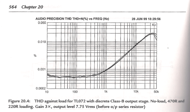

The 20dB/decade rise of distortion is a manifestation of the loop gain falling with frequency, and of not-so-linear output stage in that loop. With an NE5532 instead of the TL072, it would a few dB better. This kind of distortion has a sonic signature: unnaturally tight and punchy bass. glassy mids and highs, and amplified sibilants.
In his book, Mr. Self also demonstrated how to make it a bit better. But, if you want something really simple, just use an OPA1688 - with a 70mA output current limit, it may be a little challenged with low impedance IEMs, but 32ohm and above should be ok. Otherwise, it probably will work the same as Elliott's, without the complexity and with a much wider power supply range.

1. why did you choose D.Self's measurements done on the class B version as opposed to the class AB of ESP version , then recommended your class A amp again? This looks like a " magician" job to me. The ESP design actually follows the best class AB bias prescription of D.Self..you know ...the ideal one!
Even Elliot said that his design's distortions were below his measuring equipment at the time.Not sure what that measuring equipment was at the time , but I know exactly what measuring equipment SSL and Soundcraft used and it was back then and still is the best on the market...you'll see what I mean down this page!

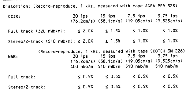

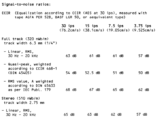

We live in a different century now. and technology moved on. Forty years ago, DeLorean was a futuristic looking car, and Studer A810 was a state-of-the-art reel-to-reel audio recording machine with 63dB SNR and 0.5% distortion:
You can still enjoy both DeLorean and Studer, but state of the art is very different these days. Audio gear with 120dB SNR and less than 0.0005% distortion is inexpensive and easily available - that's 60dB, or one thousand times, better than Studer's. And yes, it does sound better (although not necessarily a thousand times better).
