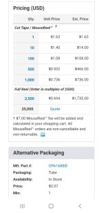

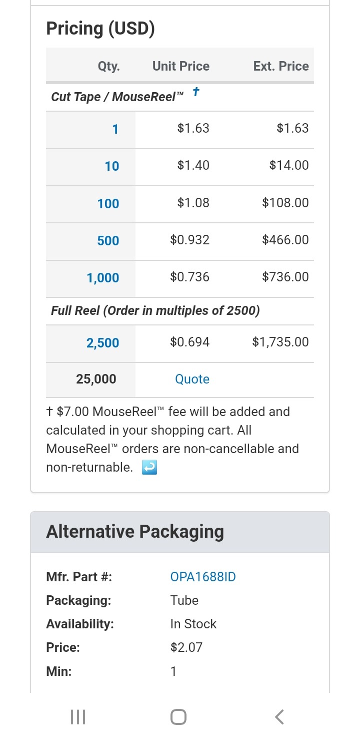

RME ADI-2 is using 3 paralleled opa1688 per channel in a space that's less than 1/3rd of what Burson V6 takes and I can bet any sum of money that no Burson can equal their performance under any circumstance because each of them can handle 70mA at 10 V output or a total of 200mA at 10Voutput per channel! Can Burson V6 at 80$ do it? I doubt that .Let's see the cost of 10 opa1688! Well it's 14$ at Mouser! 5 opa1688 paralleled per channel , 350mA output capability with ultralow distortions for 14$, can your fancy class A hpa beat it? I and a few thousands mastering engineers doubt that..

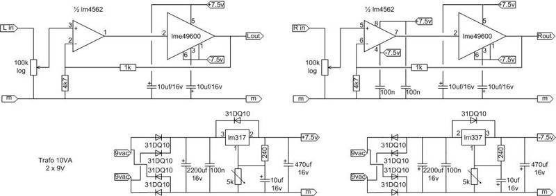

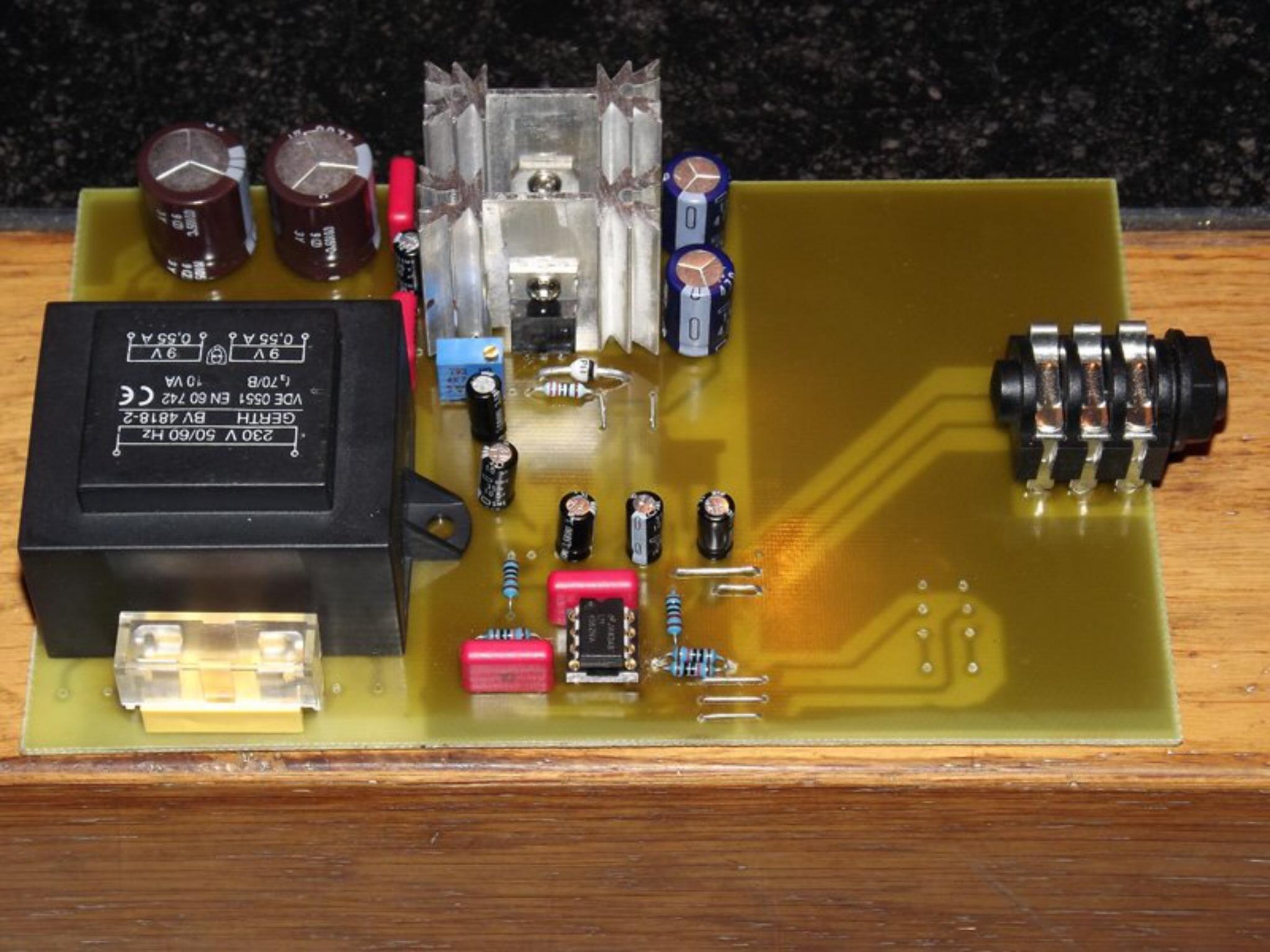

This one, which I designed, is super-simple and has been cloned multiple times. https://www.diyaudio.com/community/...amp-using-that1646.163544/page-2#post-5233570
