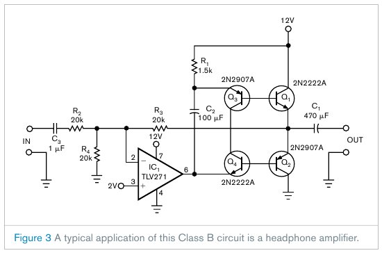

Here is a very interesting circuit for a headphone amp.
The bias for the output is controlled so that all of the output transistors remain on all of the time, thereby eliminating crossover distortion. The workings are explained in this article:
http://www.edn.com/contents/images/6702272.pdf
Hat tip to Bigun for this one.
The circuit in post #1 is basically a method for paralleling a buffer with an amplifier, but it has little to do with the bias.
Also note that not all amplifiers will tolerate the additional phase shift.
Regarding this one http://www.edn.com/contents/images/6702272.pdf, it is instructive to look at J Broskie comments about it (bottom of the page):

What is the impedance of your headphones?
As hinted by the circuits above, you need some extra grunt to properly power lower impedance headphones to full volume (<250 ohm). Common op-amps do not do a good job by themselves.
