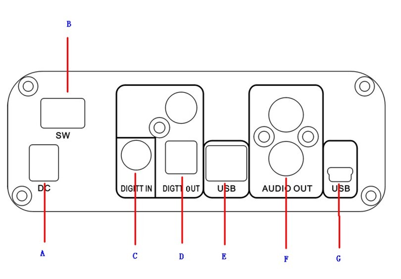

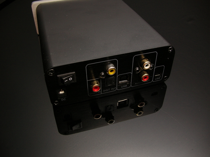

A: DC power supply input , voltage is above 12V 1.5A , can directly use the car’s cigarette lighter supply , you can use it in the car
B: power supply switch

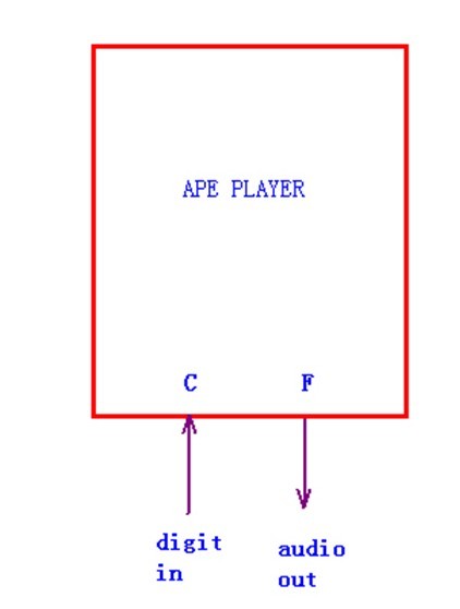

C: Coaxial input: This jack can connect with the digital output of the CD player or transport, then output the analog signals from the F jack , The DAC support 24Bit/192K-----------Use the jack, The APE can directly use a separate DAC

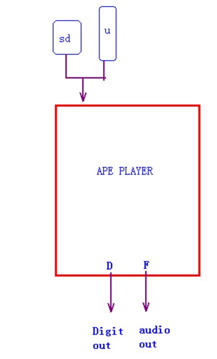

D: Digital output jack :The jack output the digital signal when the APE play music , one optical fiber , one coaxial
E: USB jack---- Used as system upgrade
F: Audio LR output jack : Output analog audio signals
G: USB jack---- Used as system upgrade

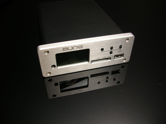

The mini ape I got have a display that is a bit hard to read when I am 3-4 meters away, but the chinese tells me that they will change the display to a OLED or TFT display in the future.

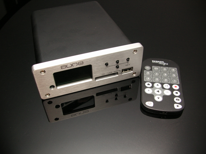

The remote control is small and handy, and easy to use.
