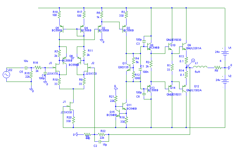

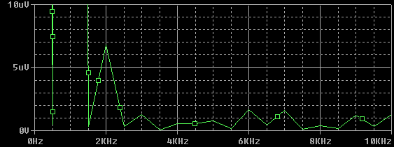

Hi thanh !
Try cfp'd inputstage with cascoded vas, this can give ~4uv 2nd,2uv 3rd !
Yes ! I have finished building it. And which VAS stage should i use? But in the sim ,my amp still isn't as good as your
I am using 2sc2383/2sa1013 + 2sa1227/2sc2987With tripledarlington output using mje15030/15031+mjl1302a/mjl3281
this is my troubleI think you can get better result with even faster output-bjts.
But i believe you don't need these low thd values, i prefer bandwidthand reliability.
Can current mirror works? I never building asymetrical amp with current mirror.You can get even lower values, i've built one. It was asymetrical,
using jfet+cfp+currentmirror. OL-gain was > 1:1.000.000. It did
not oscillate, but would need shielding as it revealed any electrical
disturbance somewhere in the house. At these ratios, receiving a
single uV from the air can give a well audible peak at the output.
I had some fun with a lightning still far away !
And it didn't sound better than my actual amp.
How can I?Don't forget: If you are simulating, take the time to slightly modify
some Vbe's of transistors to simulate thermal drift.
Are these better than mine?Forgot: You can buy these ! Get some pioneer/yamaha/sony chipamp,
they tend to have that low thd-numbers... (good for marketing)
😀 He, Mike, you got one good answer with that !Don't forget: less gain -> higher bandwidth
Any other answer from the sound quality point of view?
hi lumanauw !
Hmm, no further real answer yet... I now believe that the high bandwidth
is necessary to move some problems from feedback to some frequency
that is no longer audible ?
Ah, one more: avoid to big global FB-loop ?
to thanh:
Yes, it's possible to build amps with that low thd, but only for lower
freqs. These amps are crap for higher freqs...
Don't say that an amp is good because of some low numbers !
If you don't hear any distortions, the thd is low enough...
For asymetrical design (single diffamp) the currentmirror is a very
easy thing. No big biasing and calculating. Just place it on top of
the diffamp. Then feed this into a vas with a ccs on the other side...
For changing vbe, select the transistor, click Edit/model, say "edit instance model",
confirm some alerts, the first entry IS is for the vbe.
Mike

Hi, Mike,
Got question about this cct. What is the purpose of R3=330? Usually this kind of topology doesnt use it. Is it to reduce gain of Q3, or you place it so it looks symmetrical to R19?
hi lumanauw !
It's both of it, "looking" symetrical and beeing symetrical, and reducing
the gain to get better linearity. The gain of this circuit is already about
1:3.000.000, even more can get dangerous.
The other problem is, that the "min-voltage" the current mirror can supply
is Vce-sat of the bjt + the voltagedrop on the 100ohms. So moving
the bias down gives more ability to swing before the diffamp clips.
In theory...
Yes, but you are right, it would work without r3. Hmm, without r3
i could use a cfp in the vas, maybe boosting the gain to 1:10.000.000 ?
This should give a nice radiotransmitter. Maybe we can start a contest,
who makes the amp with the highest OL-gain... (Stable of course) 😀
Mike

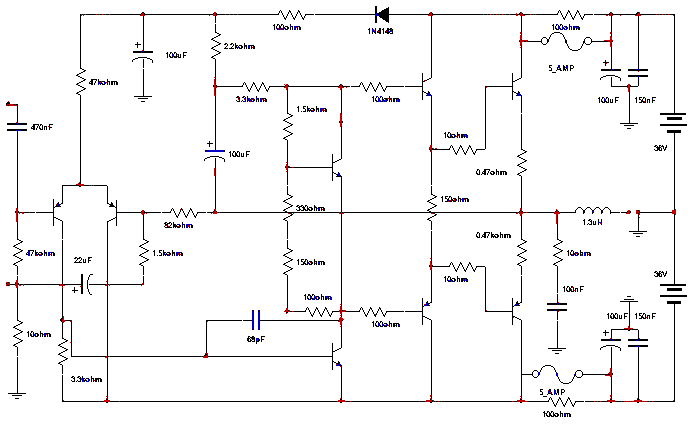

lumanauw said:Hi, Mike,
What is the approximation of this amp's OL gain? It doesnt use RE in VAS, but use R for CCS (does this makes the gain lower compared to using CCS?)
Okay, did some simus on the circuit...
OL-Gain is ~1:50000, OL-Bandwidth is ~100hz (-1db) THD ~0.2%
You really shouldn't look at any numbers on this circuit, i think the
trick was to make an amp violating anything D.Self said...
Maybe it distorts simply in a way sounding good ?
The vas has still big gain, due to miller-cap (the 100uf)
Mike
Hi, Mike,
So it is true, R loading gives lower gain than CCS?
Got an old secret here. 😀 R loading maybe looks "Ancient Aged", propably you wont even try. It has 2 here, one in the differential, and the other one is in VAS, with cap in the middle of 2 R.
But I can tell you, it do sounds better than CCS. Try it.
Maybe it is not so good in SIM or electronic theory or electronic measurement, but it really sounded better. Using R certainly generates more THD than CCS, but maybe it is the bigger THD that makes the sound more welcomed to ear. (but not the odd harmonic offcourse)
Hi lumanauw !
In sims it's obvious that the simple r-loading vas is more robust.
It does not need a predriver at all, it does make no difference.
The ccs-style is lost without predriver, it really doesn't like loads.
For this kind of vas, the cfp does a great job again.
I prefer the ccs-style, as it is more steady, you have always the
same current, not changing with supplyvoltage or voltageswing.
This of course is from a technical point of view, not audiophile.
This means, if you just want a steady and reliable amp, the
currentmirrors seems to be the better choice.
I made some test with the r3 (the 330ohm one), the result with r3
are slightly better than without. Much less DC and less harmonics.
The aksa-circuit you posted is obviously designed to distort, with
minimal changes the thd of this circuit can be reduced about factor 30.
(balancing the diffamp and adding a buffer between vas and diffamp, and balancing the feedback)
Mike
Mike
