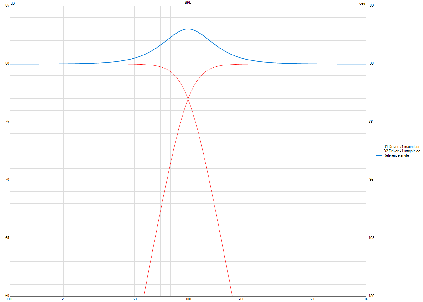

From the above, is it correct to assume that a 100Hz high-pass 24dB/octave filter is also being applied to the main speakers?
One of the crucial parameters with low-pass and high-pass filters and summing their responses together is the filter topology.
For example, if the filters being applied were 4th-order (24dB/octave) Butterworth filters, then they would be –3dB at the crossover frequency, and they would sum to produce a 3-dB peak at that crossover frequency (when each filter has positive polarity). In your case, that's a broad 3-dB peak at 100 Hz, which may account for "a lot of bass head punch".
On the other hand, if the filters being applied were 4th-order (24dB/octave) Linkwitz–Riley filters, then they would be –6dB at the crossover frequency, and they would sum flat at that crossover frequency.
The user manual for the ADS 642ix states: "The factory installed filter modules are designed to bi-amplify satellite/subwoofer systems with 24dB/octave filters (low pass = 100Hz, high pass = 170Hz)." The fact that the high-pass filter has a higher cut-off frequency than its partnering low-pass filter seems to indicate to me that these are Butterworth filters, not Linkwitz–Riley ones. That's because separating the –3dB frequencies is an attempt to reduce the size of the 3-dB peak that would otherwise tend to occur.

The following plot illustrates the response summation of 100Hz 24dB/octave Butterworth low-pass and high-pass filters. This is the on-axis response of a system comprised of two coincident drivers. The phase responses are not misaligned, as in order to get the +3dB peak at the crossover frequency it is necessary to have both drivers perfectly in-phase with each other. If they weren't, the –3dB responses would not sum to +3dB.

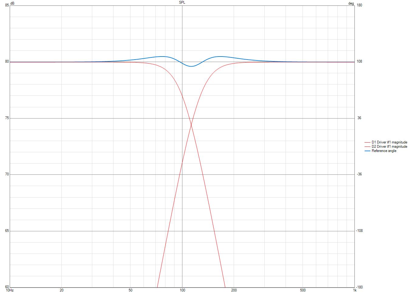

Below is the response plot when the –3dB point of the high-pass filter is shifted to 127Hz. The crossover frequency now occurs at approximately 113Hz, and the response there is approximately –5.6dB down, with about ±0.4dB ripple in the summed response through the crossover region.
