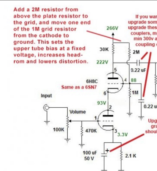

hi hope all is well. I’m still working on this amp.. I was going over the mod u explained to me about making the plate to cathode voltages the same for both triodes of the 6SN7. It’s up in your post quoted above… i saw someone else do another mod to the same amp that makes the lower triode work more resulting in less distortion at higher volumes. He explains it in this video…
If I do his mod, does it interfere with your mod?
Thx

You are talking about the input stage cascode amplifier, right?
My advice is to do one mod, or to do the other mod, do not do both.
Both mods are intended to set the top triode's cathode voltage (or the bottom triode's plate voltage, depending on how you look at it).
In other words, do not connect a motor output to a Ford transmission input, and then connect the Ford transmission output to a Chevrolet transmission input.
Just my opinions.

Yes, input stage cascode amp. Ok so they do the same thing? Thx
