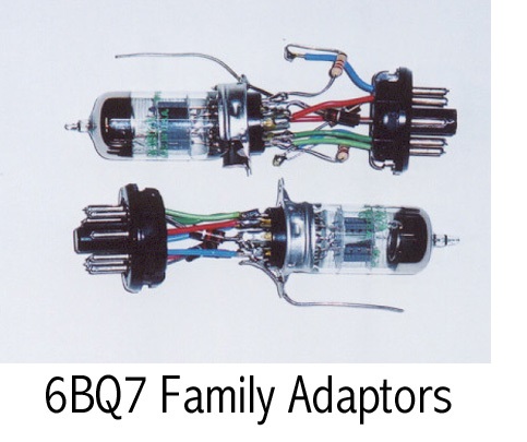

hi, based on this mod of adding the other 2.2k resistor. does it allow me to still use the 6SN7 should i want o go back.?thx
Adapters
The adapters I built were used to sub tubes of the 6BQ7 family into 6SL7 & 6SN7 sockets. The cathode resisters in the 6SN7 sub are inserted to reduce the 6BQ7 gain which would be about double that of the 6SN7 it was replacing.
Your adapters need only to be connected to the proper pins at each end. But adding 1/2 watt CC resisters in the grid leads would be good insurance to avoid parasitic oscillations. The 12AU7 should have no problem at all in this circuit.
The circuit as shewn in #17 will not achieve 6.8W per channel. But still more than enough for headphones.🙂

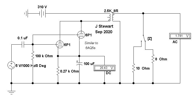

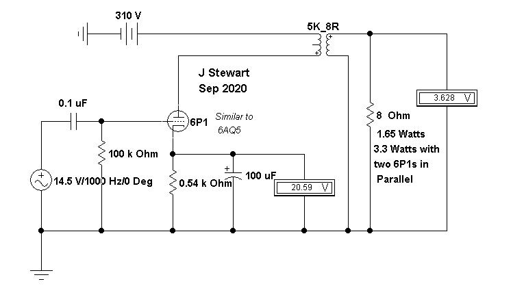

One thing... In your simulation, u marked 5K a the primary but this amp’s transformers are 2.5k...does that affect the output calculation?
Thx

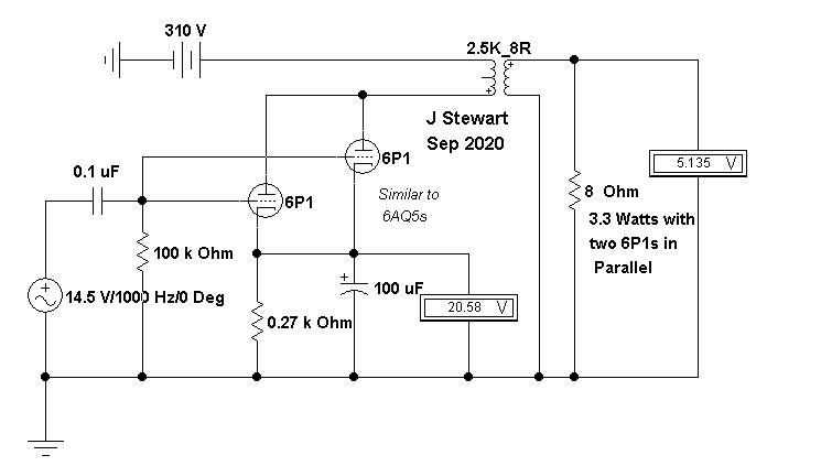

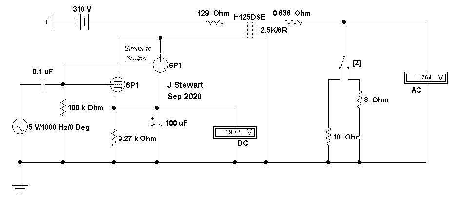

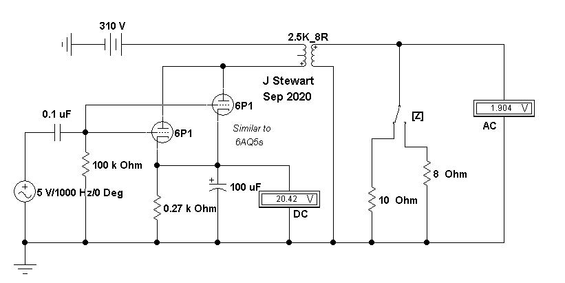

Here is the simulation with the OPT primary set to 2.5K. That requires two of the 6P1s in parallel. The bottom line is still the same, ~3.3 watts per channel.
If you could measure the primary & secondary resistance of the OPT that data could be stuffed into the simulation. And a result closer to reality possible.
Many home grown amps & quite few of those professionally built do not meet the claimed performance on the test bench. But no matter, if the user is happy with the performance that is what matters,🙂

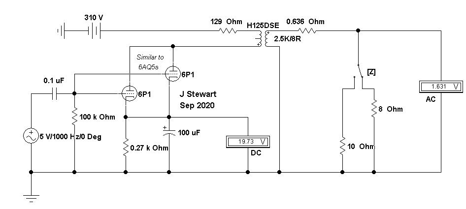

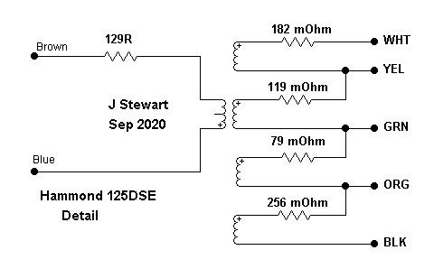

6P1 Amp with Hammond 125DSE
This simulation shews the audio available after the winding copper losses. Other losses in the OPT are not shewn, that would be in the iron, eddy currents & hysteresis. And more in the copper if one adds in skin & proximity effects. The copper wire in the winding has higher resistance at AC than at DC, depends on frequency. And higher resistance closer to the center of the winding cross section.
You get the idea, it ain't simple & wastes some of your hard won audio.🙂

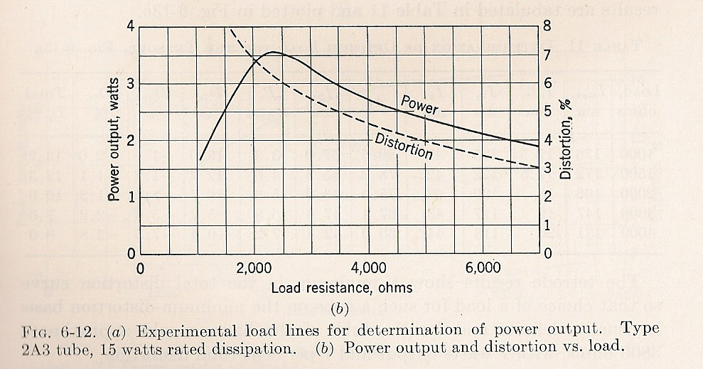

Damping Factor Calcs for 6P1 x2 Amp Without OPT Losses
Stuffing the numbers in the simulations into the HP67 I got internal impedance of the amp without the OPT losses to be 3.636 ohms on the 8R tap. So DF is 2.2, typical for a triode connected to a steep loadline. The designer has chosen to go with a steep loadline (2.5K) in order to maximize power output at the expense of DF. The steep loadline is also such that distortion will be higher than what something like a 3-3.5K loadline would yield.
The power output & distortion curve for the 2A3 is typical of all Class A triodes, only the scale factors are different.🙂

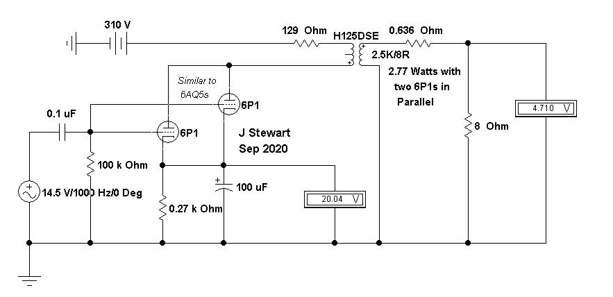

DF Calcs for 6P1 x2 Amp With OPT Losses
Stuffing the numbers in the simulations into the HP67 I got internal impedance of the amp with the OPT losses to be 4.786 ohms on the 8R tap. So DF is 1.67. Looks like the OPT has added 1.15R to the audio path.

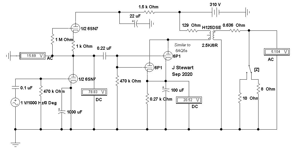

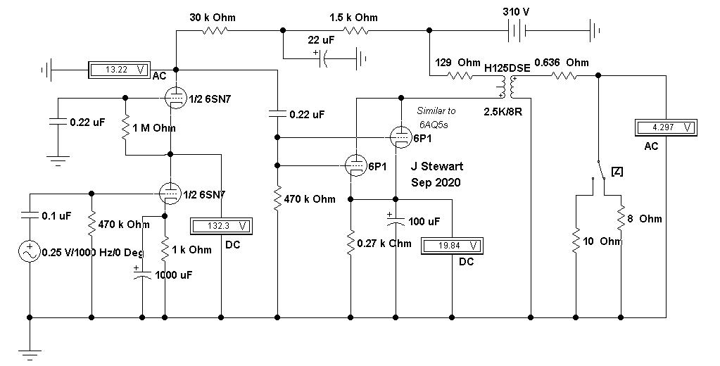

Slightly Modified 6P1 x2 Amp Circuit
Audio amps are usually designed to deliver full output at about One Volt in. The circuit as is goes all the way with only a 0.25 volt signal. Here is a simple mod using all the same tubes so that about One volt will fully drive the amp. Both before & after circuits are shewn.🙂
The 6P1 looks a lot like a ruggedized 6AQ5, the plate curves in both triode & pentode are very similar. The 6P1 heater needs a little more current, probably the cathode build is more robust & needs extra current to reach operating temperature. My thoughts, anyway.
