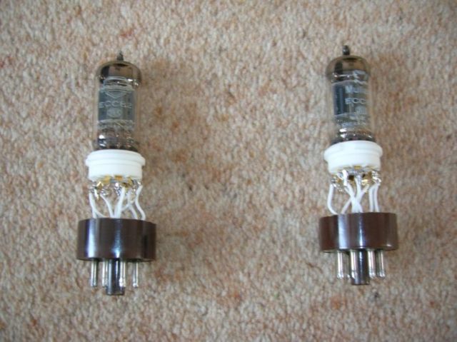

Has anyone tried a "12au7 to 6sn7 adapter"?
I got a bunch of 12ax7 and 12au7 from my guitar amp.
How a 12au7 compares to 6SN7, with the same gain?
I read that the smaller 12au7 should hum less, half filament current, less microphonic, and less crosstalk between the two triodes.
A 12ax7 is probably too hot/gainy and will drive the grids of the power tube too early on the volume pot.
Anyway, it is nice to have an option to try a more common tube in the there.
Any experience?

I recently built a pair of amplifiers with provision for fitting either 12AU7/6SN7/7N7. Tried all 3 types and found the the larger valves introduced more hum than the 12AU7. DC heating cured pretty well all of the hum. I "think" I preferred the larger valves but it was marginal.

I recently purchased socket converters from a Chinese manufacturer to try ECC99 and 12BH7, instead of 6SN7. After that, I got another pair to try 6CG7 and Russian 6n6p. I am a very happy customer. Their converters look exactly like the photograph you posted. I think the build quality is very good, though I've never checked internal wiring.
Those Chinese converter saved my time, and actually look much better than my makeshift DIY converters with small tube sockets residing on top of the "nest".

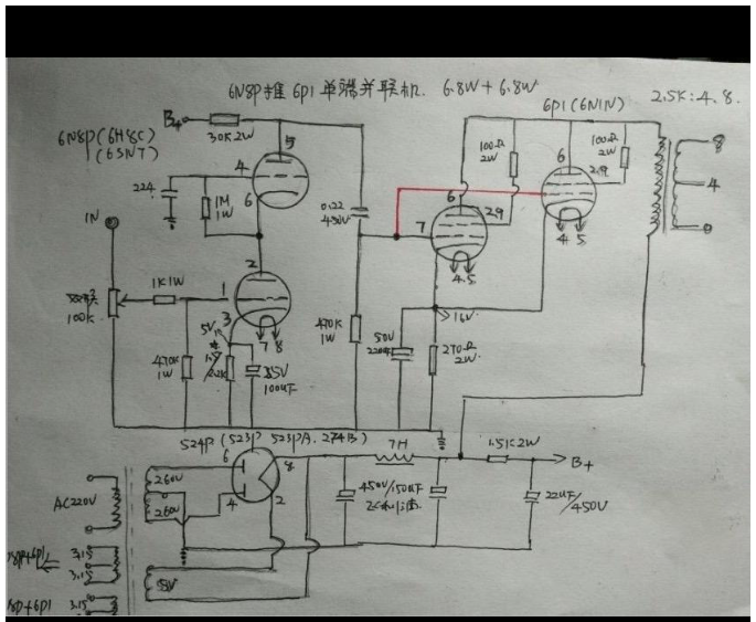

Hi I saw a post u replied in regards to its not always safe to use the 12AU7 instead of 6SN7. If U have knowledge of this, can u tell me if it would be safe in my headphone amp..?
It’s a Chinese Nobsound 6P1 amp. 6.8W/channel...
Uses 2x 6P1 in parallel.
I have attached schematic.
Thx.

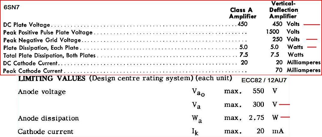

It's not always safe to replace a 6SN7 by a ECC82 😕
For preamp's normaly no problem, but when driving output tubes and other more demanding circuits better check first.
Mona

Hi, so is it safe to try 12AU7 electrically? based on this schematic ?
One of the posters had mentioned that when driving output tubes it may not be safe.
Im assuming these preamp tubes are driving the 6P1 power tubes
So I’m wanting to make sure before I try it.
Because i have some Telefunken 12AU7s and would just need to get the socket adaptors.
Thx.

With a 2.2k bottom triode self bias resistor, and dividing the B+ voltage between the bottom and the top triode sections, and with the 30k plate resistor, you are not going to over-dissipate a 12AU7 in the input stage.
You might try using another 2.2k self bias resistor in the top triode of the cascode.
That will make the voltages across the 2 triodes the same.
But be sure to use a bypass cap across the added self bias resistor to retain the cascode topology.
You may need to reduce both of the 2.2k self bias resistors, the original one, and the added one.
The B+ is divided between the bottom triode, the top triode, and the 30k plate resistor.
I suggest using the JJ 12AU7 from Eurotubes.com.
The filament is spiral wound, not the common filament of today.
The original Amperex spec for the 12AU7 was spiral wound, not just serial up and down multiple filament wires.
The spiral filament may give less hum and noise.
Eurotubes.com retests the JJ tubes for hum and noise.
Telefunken should work good too (but do take a look to see if the filament wires are spiral wound).
