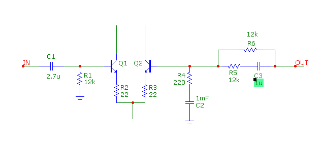

Hi Keane,
I was thinking along the same lines. Again same minds.

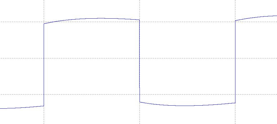

But I opt for lower impedances and different R/C ratios (fig.1).
The reason for that is twofold:
1. Lower noise.
2. Nicer square wave response at 20Hz.

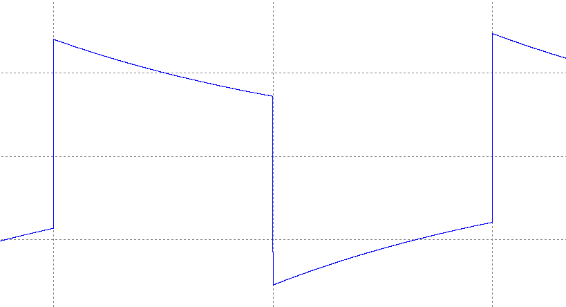

With a single FB resistor of 6k we get a heavily tilted square wave (fig.2)
With two 12k resistors and 1uF in the FB path the square wave becomes more square-like (fig.3). But to get this picture, C2 needs to be quite large: 500...1000uF.
Since the DC resistance seen by both inputs is the same (and assuming matched trannies), the offset voltage is quite low.
E.
Edmond, consider this.
With FETs, smaller low-tolerance caps could be used. The base impedance of the transistors should be fairly high, which may eliminate using this scheme with low-feedback designs. For balance, Hfe matching becomes important.
Noise can be lower due to smaller feedback resistors, and BW is increased because at HF the feedback network output impedance is low.

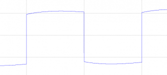

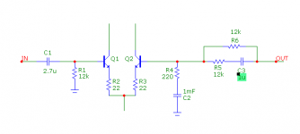

Hi Keane,
1. Lower noise.
E.
