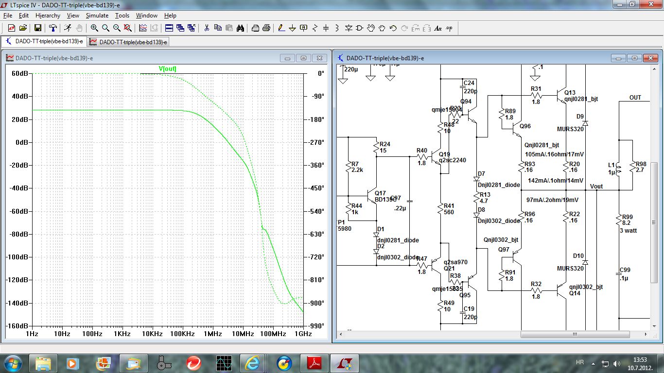

Has anyone seen this front-end before?
Something like this?

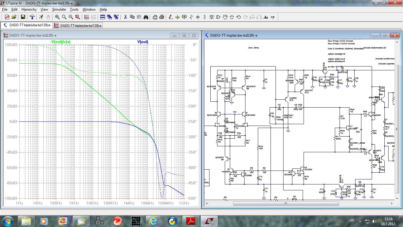

dado
No, sorry it was not clear. What I meant was that the 0 dB line should be -180 phase (= 0 PM). Not 200 phase as in this plot. In the previous post it varies between plots. In the middle it's -200 but the others are -240. Inconsistency makes comparisons harder.
A consistent use of 0 dB = 0 PM would make it instantly obvious if an amp was stable
Best wishes
David.
To all LT spice user:
In order to enhance the readability, also change the background color of the graphs from black to white and regarding schematics from grey also to white and without grid.
Thank you.
E.
I do not think this is more readable, only better for the printer toners.
dado

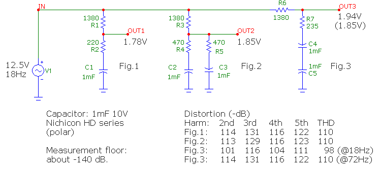

Hi Bob,
Out of curiosity, I did some measurements on a few BAD electrolytics, i.e. a polar caps of 1000uF, 10V (and 10 years old). Also using two of them, either back-to-back or anti parallel, doesn't help much. Distortion is way too high for a 1ppm amp. See figure below for results.
Contrary to what might be expected, even harmonics did not decrease by using two caps. Perhaps because they were not exactly matched.
E.
bad caps

My CD to amp output signal chain has 1 cap - a Nichicon 16V electrolytic 1000uF.
Whether it distorts (and to what extent) depends on the voltage across cq. current through that cap, which in turn depends on the frequency. In my test setup the voltage was 30...60mV, being enough to raise the distortion above 1ppm. So, can you measure (or calculate) the voltage across your cap at say 20Hz?
E.
