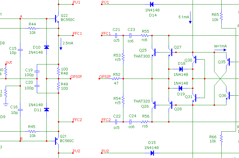

Has anyone seen this front-end before?
In addition, I've changed the frequency compensation of the OPS to a 2nd order
The loop around the OPS (Fig 12c) showed conditional stability. You have moved to second order to improve the stability?
Also curious about Fig 7. Why the low frequency roll-off?
And a last one for today - in Fig. 12 C22 and C23 could be combined and tied to point OPSIP in a natural way. Any reason to use 2 capacitors?
Best wishes.
David
BTW in Dutch we say: 'voor de kat z'n kut' In polite conversation?😉
compensation details
At the same time time I've increased the time-constants of the OPS compensation somewhat. As a result, the PM is about the same, while the distortion is decreased by ca. 40%. Notice that this kind of compensation differs from Miller or TMC. Should we call it 'feed-forward compensation' (comparable to the compensation in Bob's HEC-OPS)?
RC5 and CC5 define the second order response, but at the same time CC5 also provides some phase lead.
What you see there is the local loop gain of the Miller compensation (the lower the frequency, the higher the impedance of the Miller caps, the lower the loop gain, hence...).
The intention here is that the Miller caps (C19 & C20, see pic below) are directly connected to the output of the TIS buffers, i.e. to the emitters of Q21 respectively Q22. Tying them somewhere in the middle of the OPS compensation network is not a good idea.
Best wishes.
David
(literally: 'for the cat his cυnt')
In the presence of our queen, I wouldn't use those words. 😉
