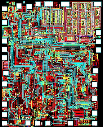

Here is one of mine, about 10,000 mosfets on the analog side (including analog switches and CCDs).
Let me know when you have something (with discretes) belonging to the 21st century.

How many of the IP blocks did you personally create, optimize and compact for optimum performance? Now that would be interesting and I am sure we could share some good ideas.
