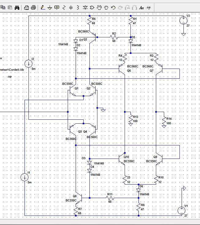

Hi Ronny,
Please, show us how to do that without degrading the gain of the LTP-VAS combo (and without using a CMCL, of course).
E.
Mirror symmetry or camera playback ?
Do you mean somthing simple like this, far from optimal. Twisted mirror; 😉
