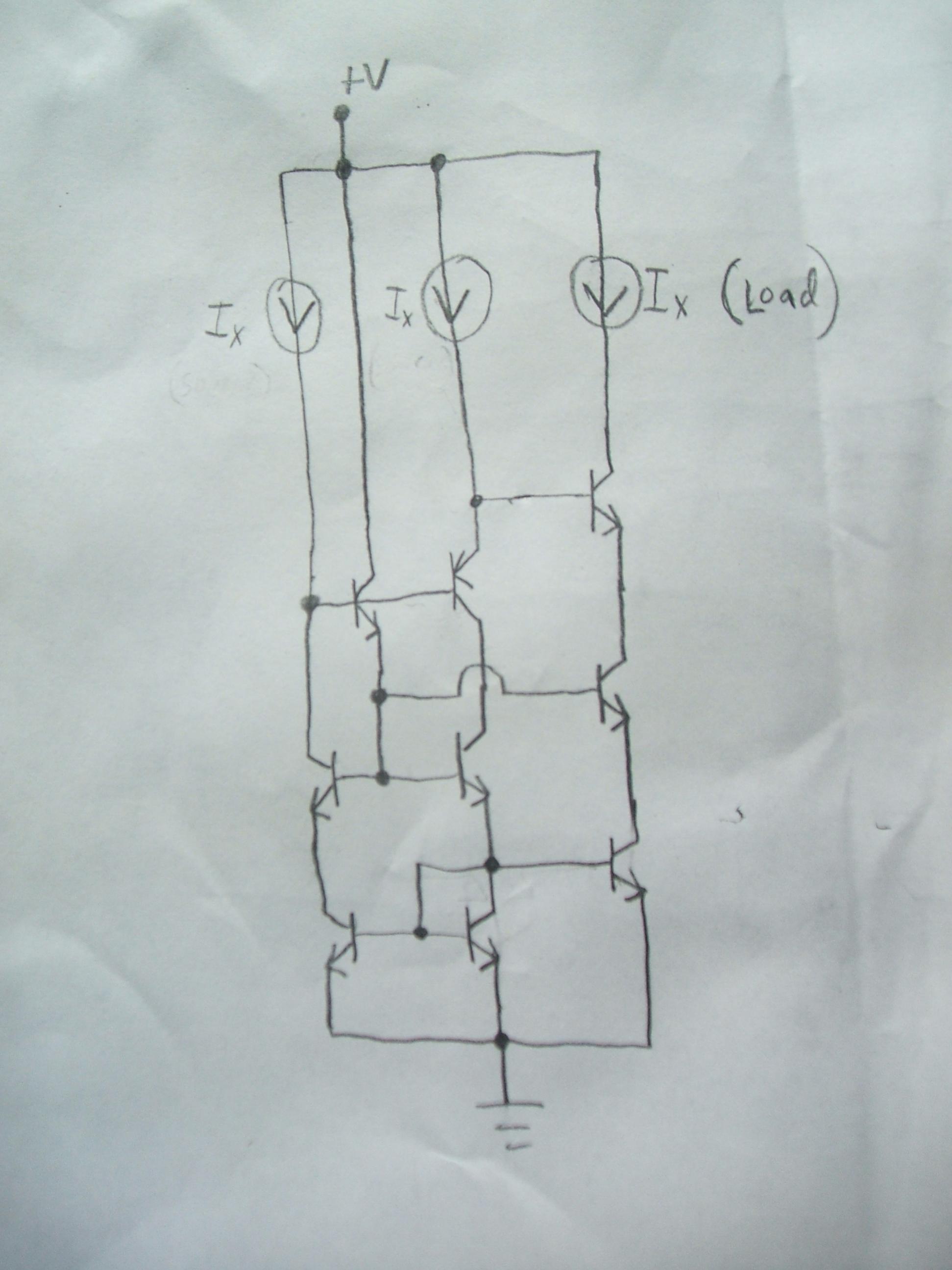

The circuit in post 318 is interesting. I think it may need a differential feedback loop and an input reference voltage in order to balance. I once used a Thompson mirror in a circuit to balance the common mode in a similar way; there are two current inputs to a Thompson mirror. I gave it up in favor of a different approach.
A Thompson-swap mirror.
Hi Edmond do you mind comment on more current gain in the vas stage as an alternative to an extra stage in the amplifier ?
Yes there vas some fighting issues in that stage.

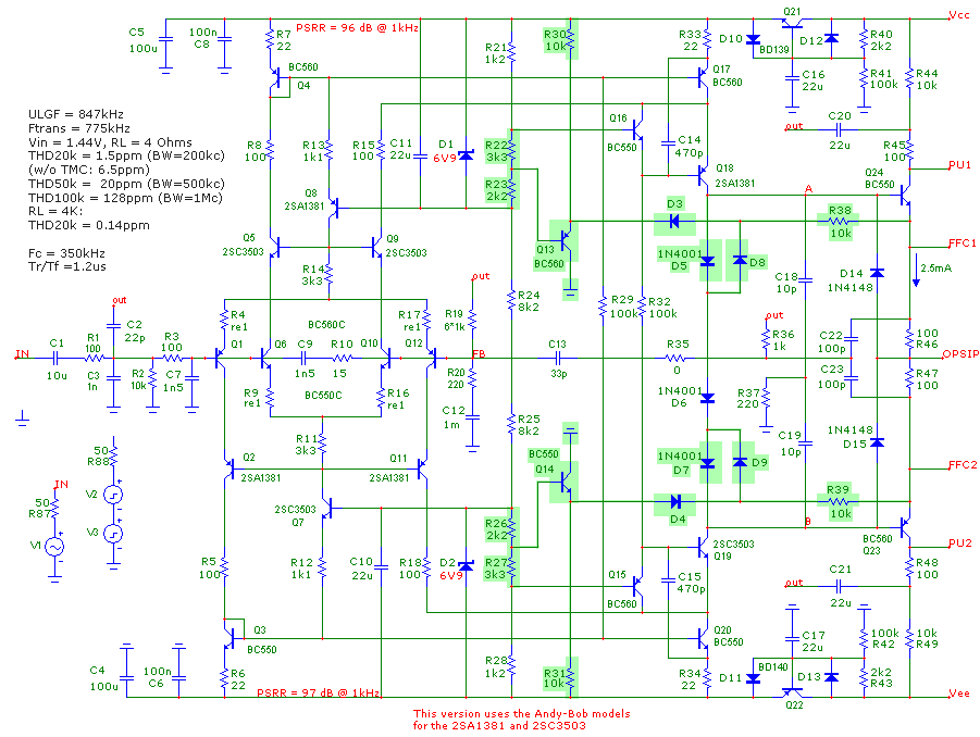

As promised, I've simulated your circuit. The collector current of the TIS is pretty stable over temperature. As the current gain of this stage is limited (16dB), you probably need to compensate for this by means of a pre driver or so.
If you don't mind, the common mode behavior is not yet optimal: R10 & R11 need to be increased from 72 to 77.9 Ohms in order to equalize the current gain from the base of Q10 to the output, respectively from the base of Q12 to the output. This is because the dynamic impedance at the emitter of Q1 is lower (Ic is higher) compared to the one of Q10.
Probably due to asymmetry of the current mirrors, CMRR is not that good: Above 10kHz it starts to drop. Maybe you can improve it by means of a 'clever' cap.

Hi Andrew,
As a matter of fact, the TIS does suffer from a tiny bit of sticking. Maybe it also contributes to the ringing. I have to check it out. If so, I'll add a Baker clamp.
E.
edit: Indeed, a Baker clamp helps a bit. The amplitude of ringing becomes about 50% smaller.
Now, I have to figure out a clamp that doesn't contribute to distortion.

Hi Andrew,
Perhaps a BAV21 does a perfect job in other amps, but not in this case.
I'm sorry I have to disappoint you, but even with the BAV21's, THD20k (of the SuperTis alone) rises from 56ppb to 2.4ppm
So a more complex solution is really needed, as sown on page 317.

Hi Bob,
I finally succeeded to implement stable clamps and the solution appears to be very simple: just use 'brute force' clamps and flying catching diodes. The Baker clamp as shown on page 317 wasn't stable, because the loop gain (of the clamp) wasn't controlled by Cdom (Cdom stays outside the loop). As a result, the phase margin was close to zero. Brute force clamps don't suffer from these issues and are permitted in this amp, because the CCSes limit the clamping current to modest values anyhow.
The highlighted components in the pictures below, depict the 'brute force' clamps, while D8 & R38 respectively D9 & R39 prevent entering nonlinear currents from D3 respectively D4 into the very sensitive nodes A and B.
The 'flying catching' diodes are: D14, D15, D18 and D19.
