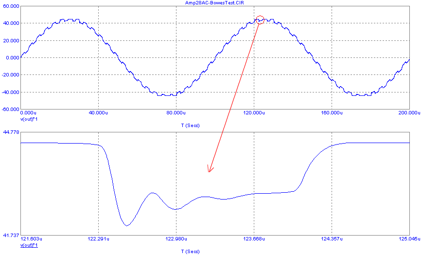

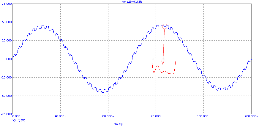

Edmond, sine wave at near pk - pk output with much higher F square wave at much lower bevel superimposed on top? Neat test!
It's easy to forget just how much some parameters move around with voltage and how this can lead to instability , especially near full output voltage swings.
SQ test
Hi Andrew,
A neat test, indeed. Courtesy of Glen Kleinschmidt (AFAIK, he is the inventor).
The other square wave test, the one at start-up (fig.12q), rings still to much at low supply voltages.
This has all to do with the pre-driver, which still has to be improved.
E.

"Scroggie", once editor of WW, attributes this test (small square wave superimosed on large LF sine wave) to RC Bowes (WW Dec 1962).
Brian.
Brian.
Thanks Brian. I will change the name to 'R.C. Bowes stability test'.
Credit where credit is due.
E.

In order to find more instabilities, I've also performed the 'Glen Kleinschmidt stability test', which does show some ringing near clipping levels, though not really alarming. See below.
E.
E.

Hi Arthur,
The test was done with a load of 4 Ohms.
Whether 4 or 2 Ohms, it doesn't hardly make any difference.
Below the 'Bowes test' with 2 Ohms.
With a disabled TMC, the ringing was almost completely gone.
E.
edit: NB: Equally interesting (and important!) is the step response during the firing up phase.
See fig. 12q on my website.
